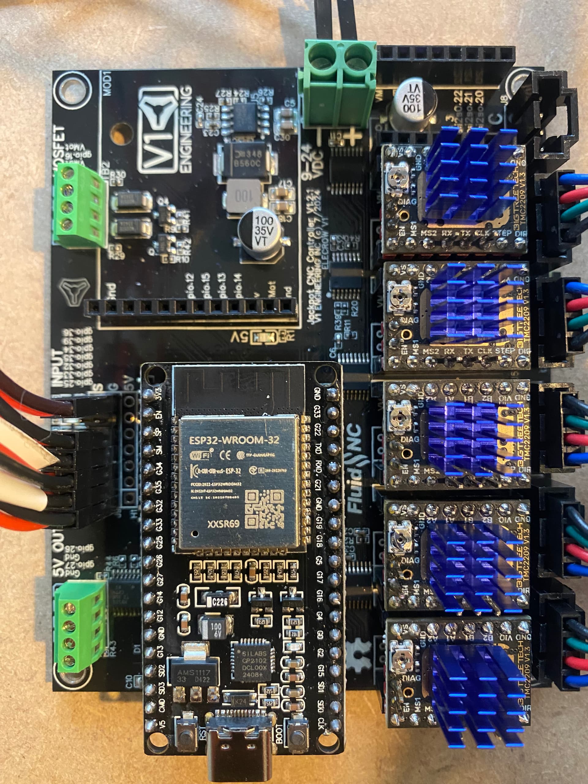

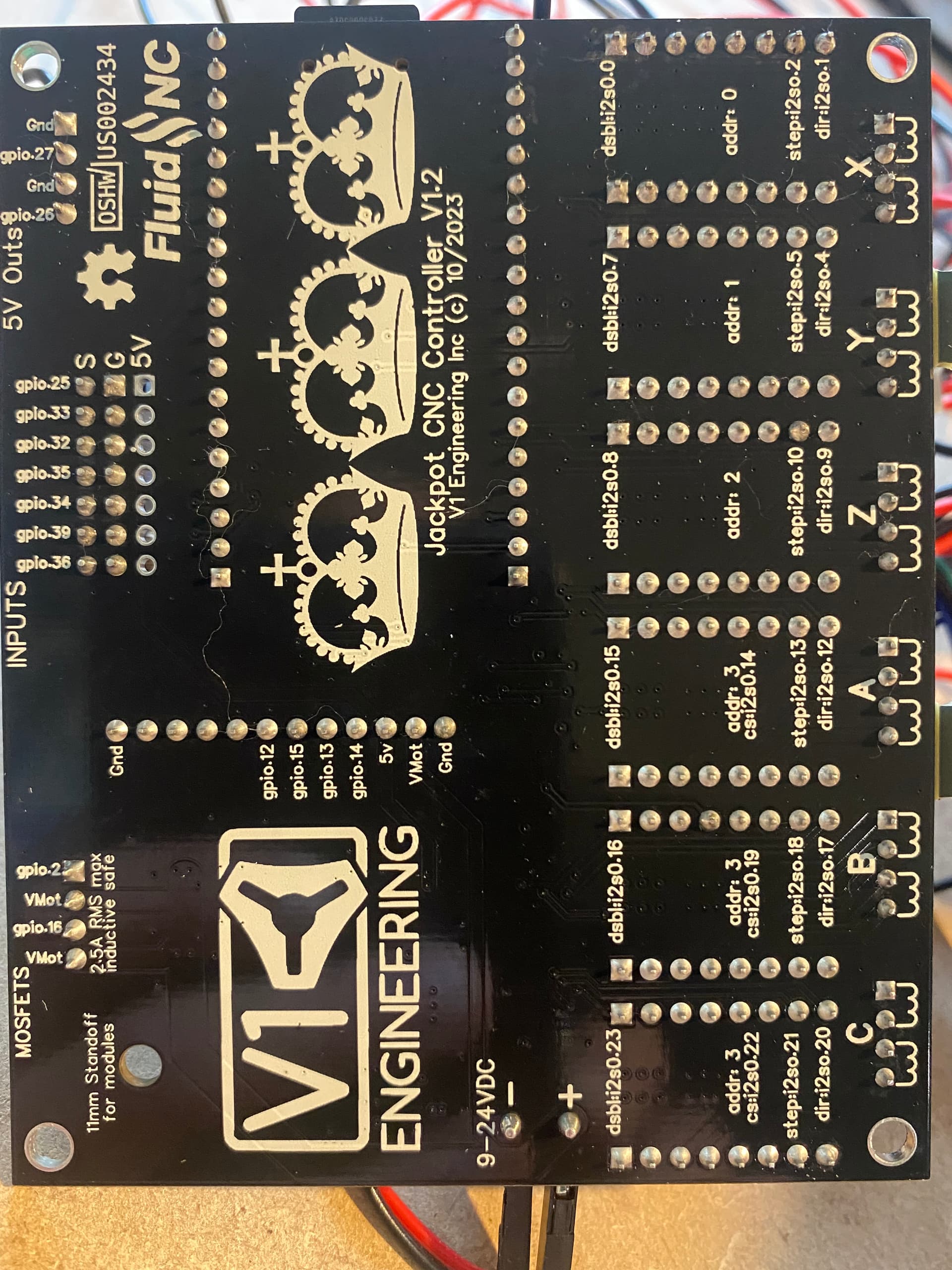

It might also be helpful to share high resolution photos of both sides of your Jackpot to see if there’s a bad solder joint or something.
As per Jason’s suggestion, some photos and configs…
Jackpot rear
Jackpot front

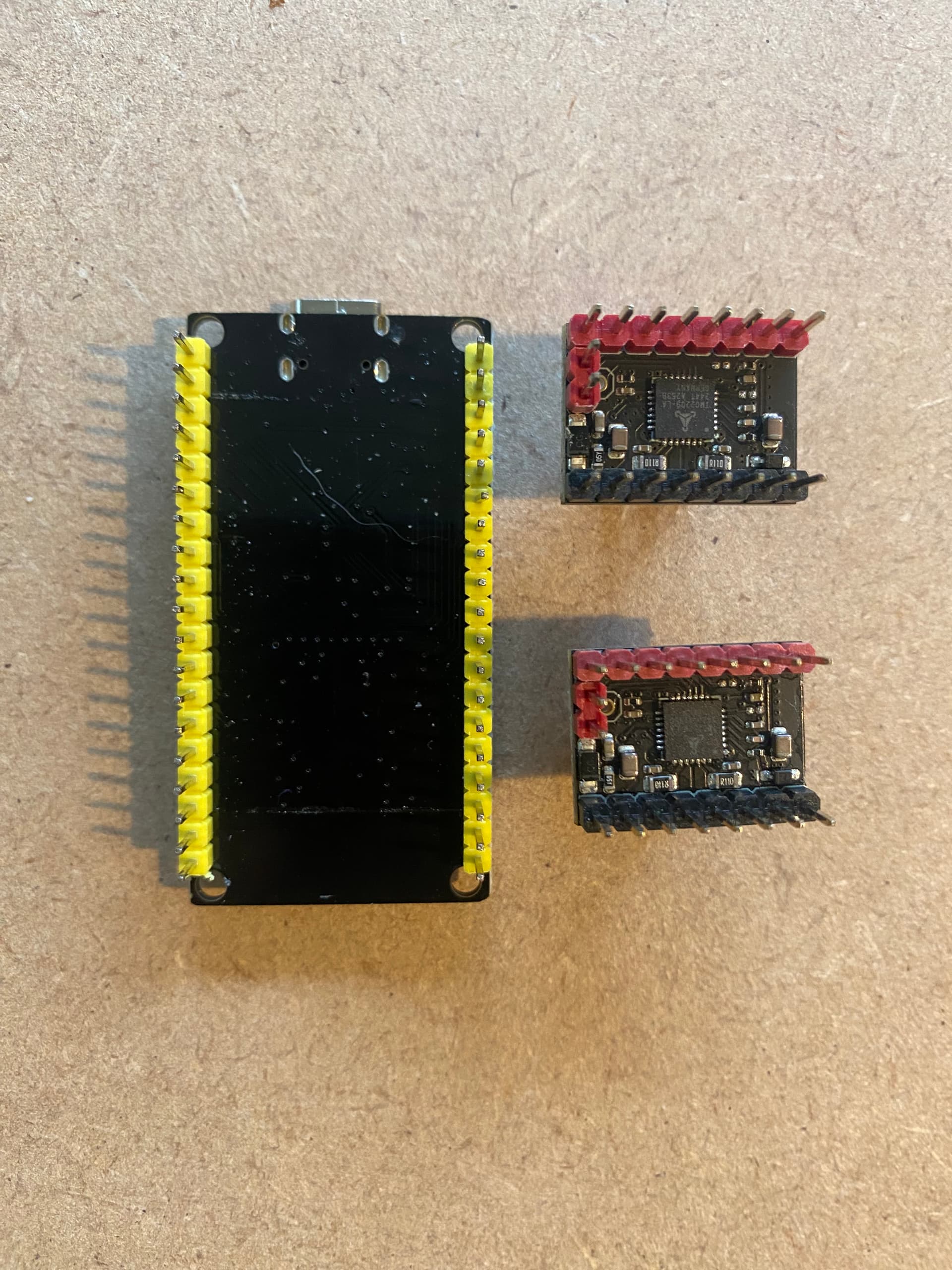

Reverse of ESP32 Dev Kit and Y0 and Z0 TMC2209
