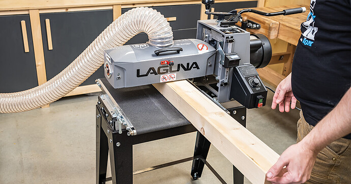

The drum sander works, but it’s kind of frustrating sometimes because you have to hold the workpiece in your hands and slide it in preeeetty far to clean it up (and I like the skin on my fingers, so that’s always a gamble).
It’s also not perfectly straight, so one edge is sanded more than the other etc. The sandpaper also does not stick too well so that I have to re-fasten it pretty often.
I could have fixed it with a different riser, a modified drum etc., but did not want to put the time and energy into it.
So now I bit the bullet and bougth a new drum sander after having scoured the used machine market for a year without something popping up that was a good deal.
It’s this one (an American one, who would have guessed. Not me…):
Looks almost exactly like mine - because mine was a jet which bought performax which bought it back which was bought by laguna.
So that explains it! It’s a good machine just don’t try to take too big a bite at one time, and remember to keep the dust extraction on. I can’t understand why they never did anything about that one single outlet, but I never did get round to finishing my printed four into one manifold for it either. You’ll love it.
Yeah, the Laguna made several improvements, like the “Intellisand” and the quick height change thingy. The bigger one was on offer and would’ve only cost 100€ more, but I really a) don’t need it b) don’t have the space and c) wanted the quick height change. :stuck_out_tongue:
