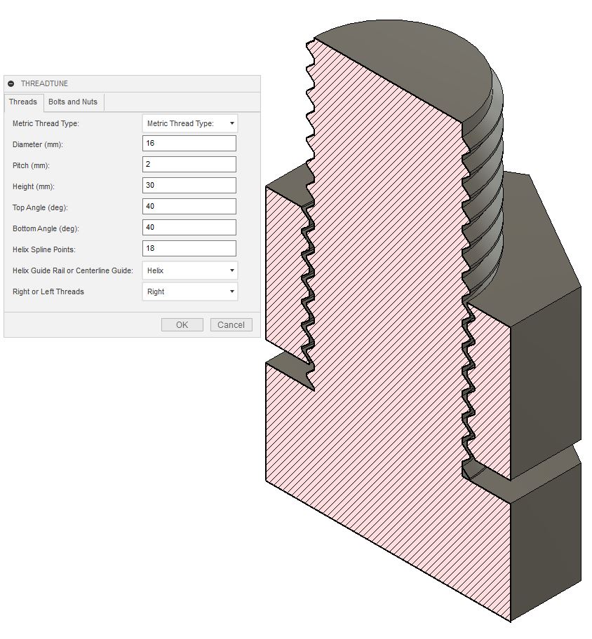

Meanwhile, I finally was able to get the GuideRail & thread direction in a dropdown input list. Here is what it looks like now.
ThreadTuneDialogDropDown
I also worked out drawing a Bolt & Nut, but am doing that separate for now, to make it simpler to debug.
Next thing I want is a drop-down list at the top to select standard metric threads & fill in the appropriate dialog fields with those.

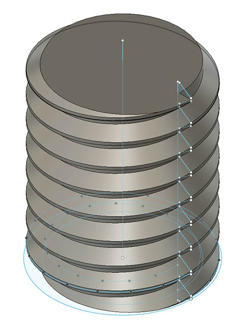

I got an answer to my question. Turns out the move feature in the API doesn’t support the ability to copy for my case and is broken & he said it needed to be fixed. He gave me a workaround but might be better off making this a component rather than using bodies. Seems like it works for those. I’ll work on it some after I figure out my event handler problem with updating the dialog box when a different metric thread type is selected. Looks like the spur gear python script does what I want. Just need to see how it is done there.
I updated this to v1.1 since I made a lot of changes since last time. The standard metric pulldown works nice now. You select one of the options from M3 - M30 & it fills in 6 of the entries. That way you get the settings set to standard before customizing them to your needs.
After some further thought on the bogging down of the program when generating a sweep using the thread profile & the 2 helix paths, think I have come up with a good solution. I could draw a thread profile for each pitch distance and do the same thing for the helix, then create a separate sweep for each revolution joining each of them together for each sweep. That should get rid of the bogging down. It does not seem like it would change my current code too much either. I tried it manually & seems to work ok.
My 1st couple of thoughts getting around fusion 360 bogging down on the sweep of the helix with a lot of points didn’t work. I did come up with a solution that seems to work. I found a couple of bugs in the process as well as making the helix routine cleaner. I draw a profile for each thread section for the length of the screw & connect them all together as one profile, draw a one revolution helix for the path & guiderail & then sweep all the threads with the single inside revolution helix as the path & the outside helix as the guide. The helix only needs to be one revolution now & therefore makes it a lot less points for fusion to look at. These 2 screen shots should explain visually.

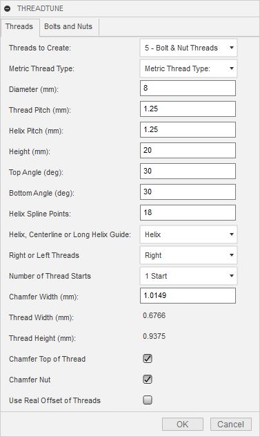

I added chamfering to the threads & got rid of the annoying extra tool body left behind when cutting the threads for the Nut.
I hate to rely on ChatGPT for some of this code, but this stuff is just too cool & in this case makes it easy.
I ran into some issues with changing the pitch to bigger numbers, but if I made the pitch too large, it would not work. Early on in this development, I had wanted to make a true offset of the female threads from the male threads, but with the pitch distance it usually would not work. I decided to unbind that pitch from the helix & made a separate pitch for each. Problem solved, but not quite. How do I calculate those vertex points of the offset lines. I did thread profiles from 15 degrees to 65 degrees to see if I could see a correlation, I could use to get the angle to use with right triangles thinking I could use right triangles to find those points. There does not seem to be a correlation that I can see, so I decided to try ChatGPT to see what it came up with & it was almost perfect. I only had to change the offset distance from positive to negative. Here is an image of the test threads at 20 degrees. The green lines are what I am looking for. I gave it the coordinate points from this 2d drawing, so I could easily test that it works.

Think I am done with adding all the features I wanted to this program. A week or so after initially creating the GitHub repository for this program, I found another repository by the same exact name. I was surprised that GitHub allowed that. I have been thinking about renaming this for a while. In order to keep the name similar, I just changed it to P_ThreadTune with P standing for Python. I will keep the other repository for now with a link to the newer one, but will probably eventually delete it. I might sometime in the future rewrite this in C++ and use the prefix C_ for that. It is fast enough for me, so not sure whether writing it in C++ would be beneficial other than teaching me how to use this API in C++
The dialog box changed considerably since the previous version.
