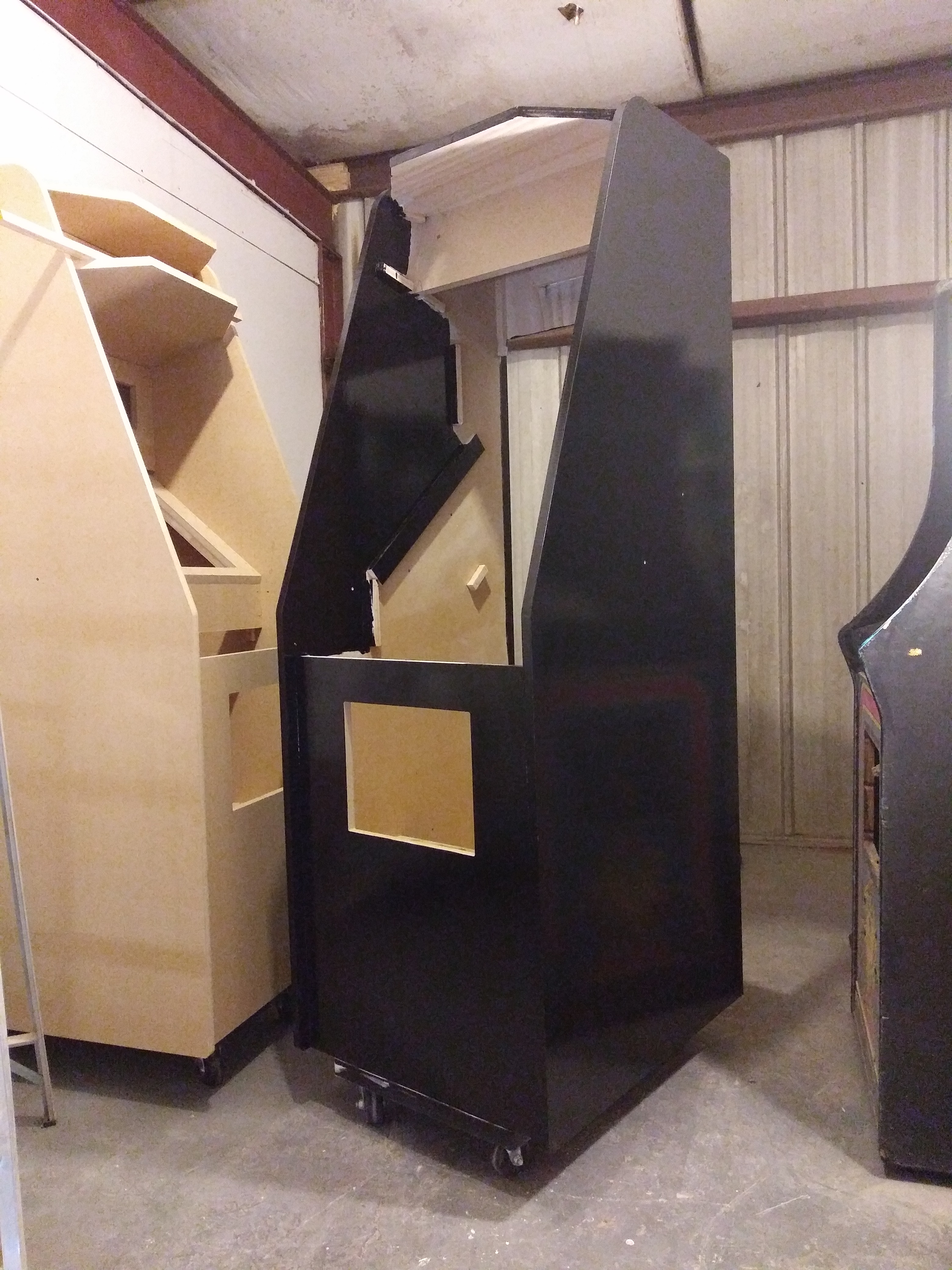

I assume you’re going to run Dexter as the Laserdisc player door has been made one piece with the middle back board? I am on this same adventure and stumbled across this thread and am loving the way it’s coming together. Are your plans based on the DXF’s at classic arcade cabinets?
Hey @penguindeity welcome to my madness! You’re 100% correct, with my original PCB, I’m using Dexter as the player. Just didn’t see the need to build out the laserdisc drawer for something the size of a Raspberry Pi haha I’ve got to do the same thing all over again after this one, to build my Space Ace too. Good times.
The CAD are the same ones from ClassicArcadeCabinets.com. I spent some time with Brian sending measurements back and forth and we have completely verified them against an original. So this is me telling you, they’re safe to use! BUT! When you’re cutting the sides, go ahead and drill the monitor bracket holes, but NOT the control panel holes. They don’t quite line up. I only put a small indentation on my cab, just to see how close they were, and they’re off in the dxf. :stuck_out_tongue:

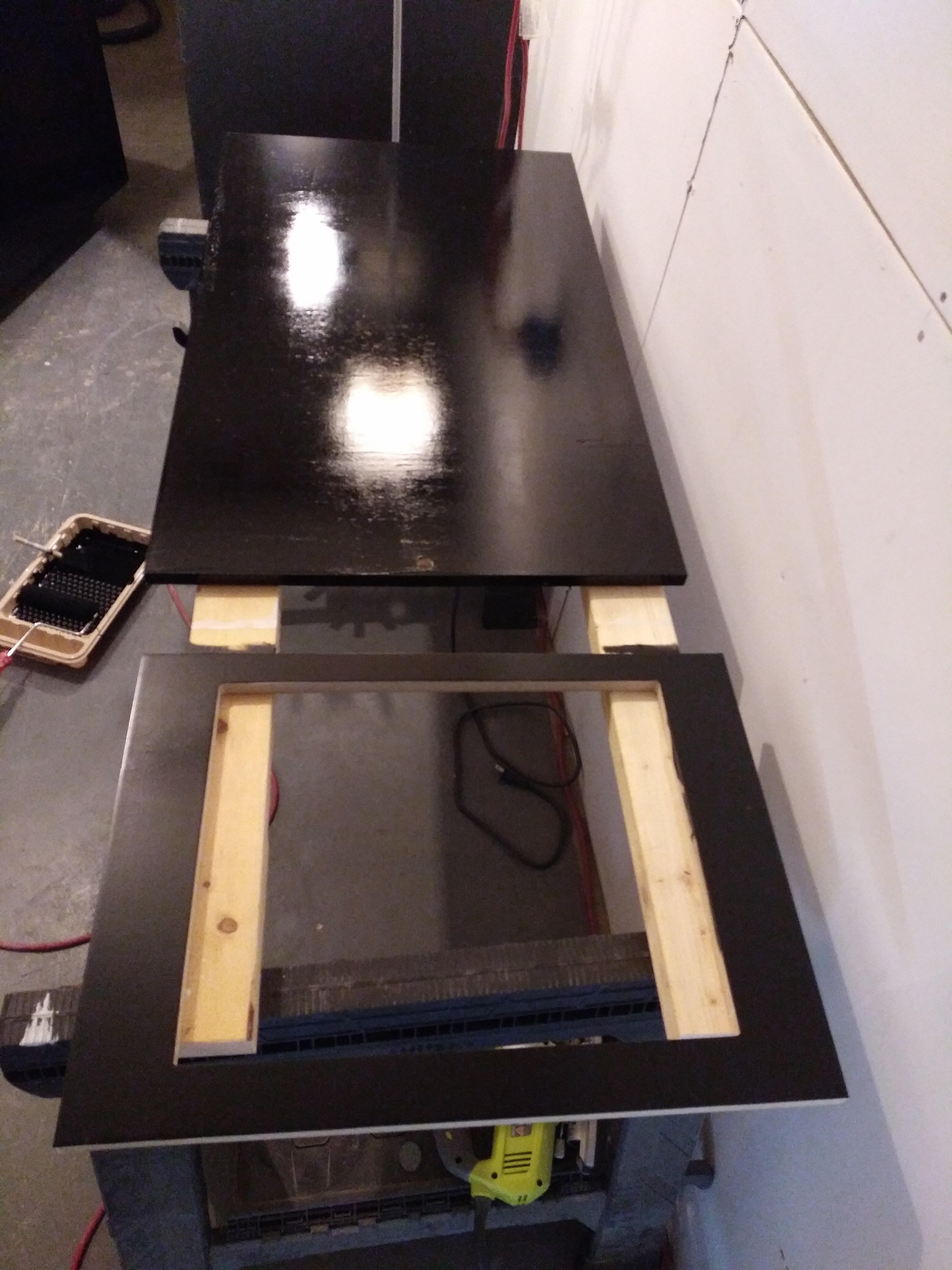

So here we go. Today, was eventful. Got some more done on it. @barry99705 I wasn’t able to get that sprayer you linked because no one had it in stock. So I’m gonna get it from Amazon. But, I was able to roll on the first coat of black. And honestly, I think if it flows out, I won’t have to do anything else but some touchups here and there. But I’m not that lucky of a guy so I’m sure I’ll be slapping another full coat on.
The scoreboard panel, and lower marquee panel… SHINY! Love how oil based paint always looks so shiny when it’s wet. It’s a semi-gloss RustOleum, so it will still have a little shine when it dries. Hopefully not TOO much tho. This is my first time using this paint.
And the back door and monitor surround panel. There’s another piece that goes in front of the monitor surround but I forgot to snap a pic of it. It’s just a rectangle piece. That’s black. LOL Soon, I’ll be putting this bad boy together and getting the electronics going!
Thanks for the quick reply! good to know. I’m starting on my drawing revisions now! A couple more questions, and I apologize as I can’t do direct messaging as I just joined. Did you bring the front panel cuts to 3/4 instead of the 7/8 they are at in the drawing? Additionally, It appears you created the monitor Surround as one piece? Was this several pieces before? Sorry for the barrage of questions. I’m building from scratch with Arthur and Dexter and have no original cab to go off of.
Hell yea! Ask away! I’ve had 2 originals in the past that got ruined in storage. This is why I’m building these actually.
Ok, first thing’s first, let me tell you. If you cut the cab as is, but only use MDF, you’re gonna be disappointed. If you cut the cab as is, and use ply for the top, back pieces and bottom you’ll be perfect.
On the front panel, that was tricky because in the DXF, it requires you to pocket out the groove for the front to sit in. As I said, I’ve had 2 of these, and one was done like that, and the other wasn’t. So what I did, was made the front panel the same width as the Power/Fan panel, and didn’t cut that pocket for it to sit in. It rests up against the normal 3/4" blocking as it’s supposed to. No changes were made there.I left everything where it was, and just placed the front up against the blocking. This will give you a hair more than the 1" indent on the front of the cab. Also, you’ll wanna skip the coin door hole if you don’t have the original Wico, because the hole will be too big for an aftermarket coin door.
As far as the monitor surround. On my original, it’s made up of 6 pieces total. I opted to just make it 1 surround piece, with the 2 bottom “braces” because you won’t see any of that anyway once the bezel is in, and the smoked plexi is in place. I cut alot of corners to achieve the same results haha
