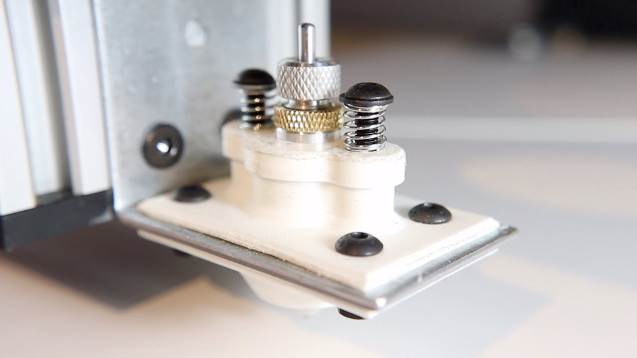

I was wondering what people are using for pad under the vinyl/decal you’re cutting. Saw this clip of something that looks very promising (green pad) but not sure what it is and can’t find it:
