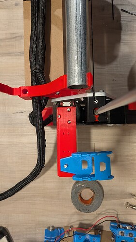

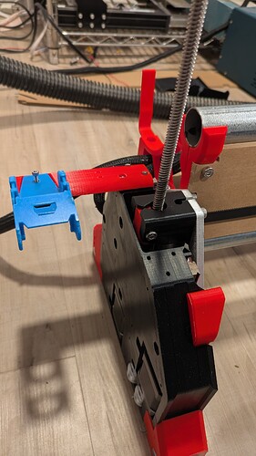

With the LR3 I had my control board and screen mounted at the end of my table and it worked great. Was using Doug’s raceway drag chain to link with the 3d drag chain I had already.
This time around I’ve taken a slightly different approach, leaving the control board (SKR) with the machine and just extending the screen out as well as the power supply, so sticking with the drag chain along the Y for those cables made sense to me.
So I designed something to screw the end of the drag chain in using the negatives Ryan has provided, if anyone is interested.
Uploaded the files, just haven’t tested in a working environment yet as I haven’t set up my LR4 fully
Using M3x10 screws to mount on the side plate and 2 slots for zip ties for the cables when in place
