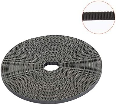

These belts I have, at 48 inches long stretch by about 4mm when under 5.5 kg of tension. I am not sure if this is typical. I’ll buy some name-brand belts and see if they are any different.

For some reason it didn’t occur to me that belt length is one of the contributors to decreasing machine stiffness as the build gets larger. I guess this is why the LR2 has 10mm belts. It’s obvious when you think about it, but belts were not one of the things I was considering.
You can also try doubling them up. Don’t mesh the teeth or anything, just put another belt behind the first, teeth pointing the same way.
That is more than I would have expected. I would assume that is linear so even 12" would have 1mm of stretch. Hmmm.
Yup, exactly why the LR went to 10mm.
4mm is a lot more than I expect though. Another point would be The quick and dirty we have for aluminum is 1.9kg of cutting force and at worst that is distributed to at least 2 belts. So maybe at what point does the belt show stretch? I believe we are only supposed to tension them to 3-5lbs.

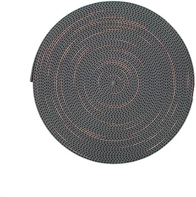

Today I measured another belt, left over from my first machine, and the stretch was the same, to within what I could discern with my eye, so I would say 10% difference or less. Maybe they ultimately come from the same factory in China and there are a thousand resellers. Seems plausible but I don’t actually know. These are the two products I ordered
It seems unlikely that I was unlucky, getting a particularly bad set of belts twice. I also have these name brand belts on their way, which I will measure when I get them:
