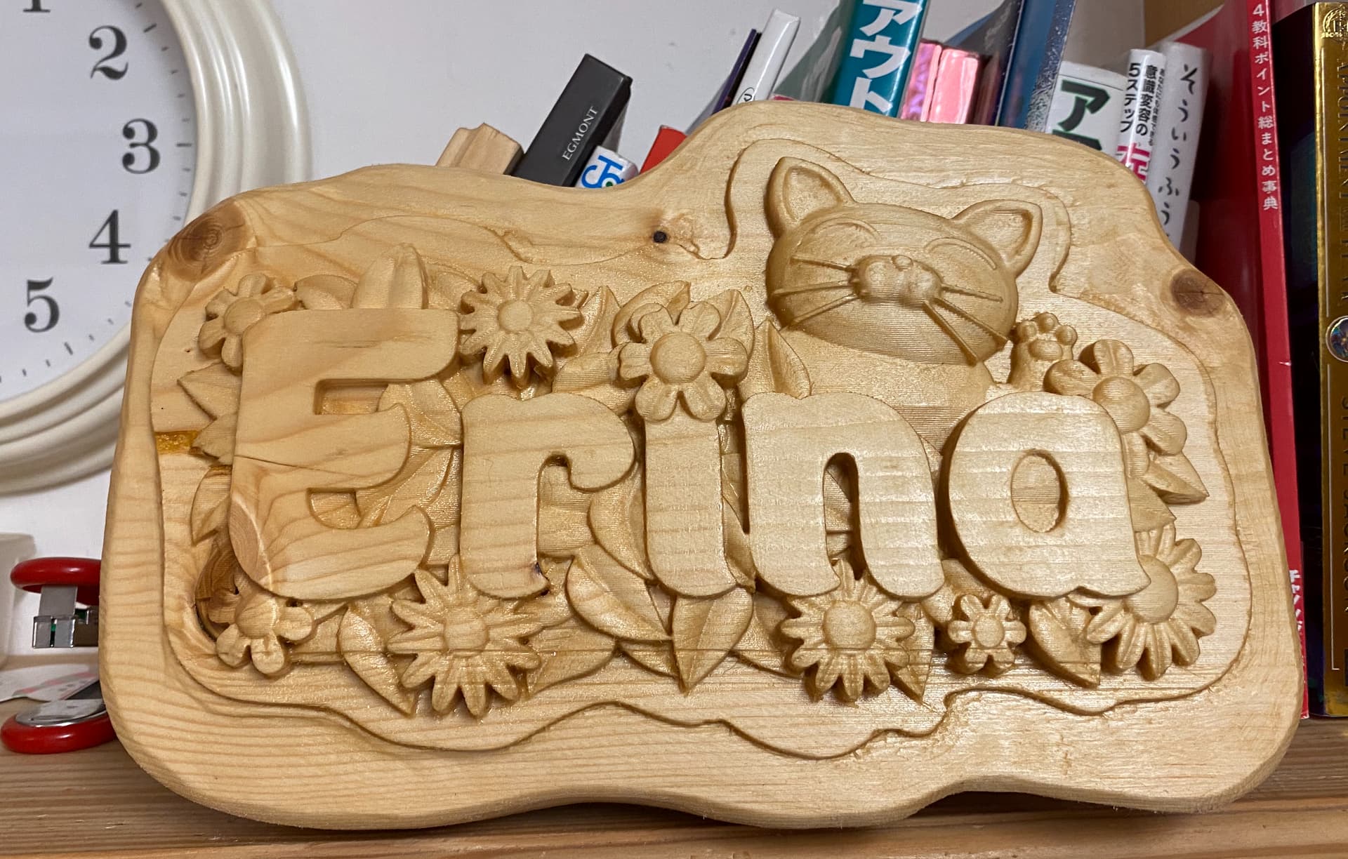

Created a door sign for my daughter. My first finished project, still learning the ropes with the machine and software, but really happy with how it turned out, errors and all. Excited to keep experimenting with the MPCNC.

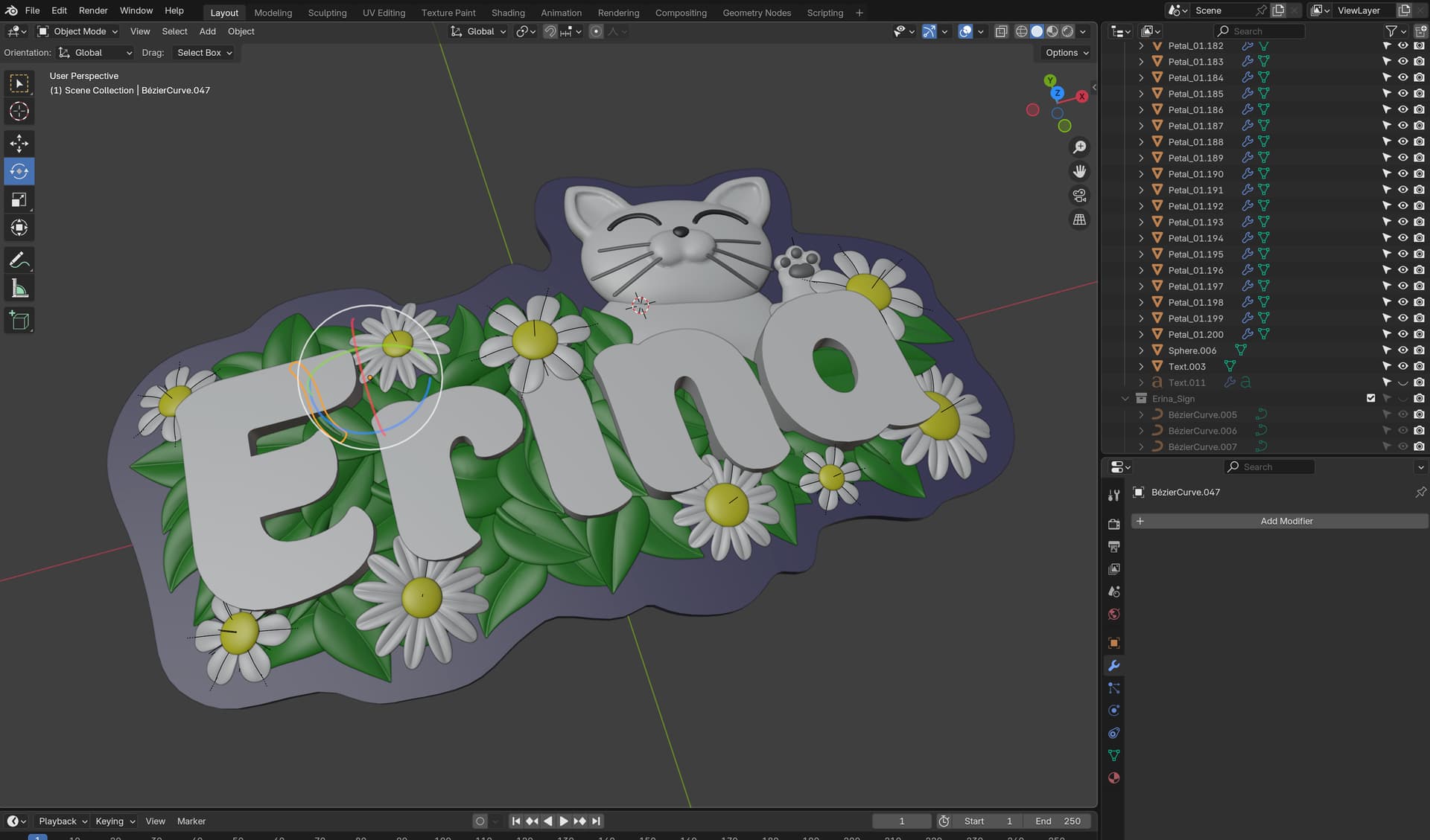

Thanks. :slight_smile: I 3D modelled it in blender and used fusion to do the tool paths. I’m completely new to Cad workflow and Fusion so there was a bit of a learning curve.

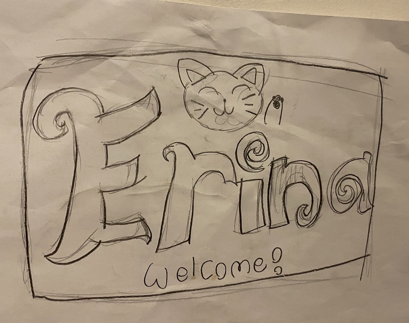

well I was given a brief and rough design concept by the client :slight_smile:
I did my best to match the feel, Although I didn’t capture the lovely original font, perhaps next time.
I think I got the cat though.
I poly modelled in blender and then exported the model as an .stl I brought into fusion and did two passes Adaptive clearing with a 3mm pineapple and then a parallel finishing pass with a .05mm ball nosed spiral tapered bit. If you look close the lines are visible, i tried to sand it out where I could be all part of the learning process. It was a fun collaboration.
Also you can see a couple of places the Z height seemed to come out wrong (line across the bottom part), not sure why. Some bits of the flowers were chopped off, I presume because I didnt accurately input my milling bit dimensions in Fusion. Any advice on overcoming some of the issues present appreciated.

did you also use a ballnose?
man, the more I look at it the more I TRULY appreciate it. You did amazing!
yeah, ballnose thats the correct term, sorry, I’m manufacturing noob. Im not new to 3D though worked as a 3D artist in educational software for a while. I just never used fusion before.
so there is more than a ballnose, there was a wide tool for the letters, looks like a 1/8 or 1/16 used for the deep flowers and a ball nose for the rounding, did I get everything, LOL?

yeah thats it, it was about 1:45 for the main clearing with the 3mm bit and then about 5 hours with the ball nose doing the fine parallell pass. I would really like to learn more about how you can get a smoother finish etc. Im probably doing things in an odd manner. I didn’t record it unfortunately but I will do for the next project.

@Dathi - How did you model the leaves, flowers and cat? Were you able to work from a template, or did you design each one by hand?
I would love to try to design something similar for my two grandchildren. I’m mostly familiar with Fusion for 2.5D design. This looks like it would be stepping up a level from there.
Hi, Yes i modelled them in 3D in Blender, there was no template other than my daughters drawing. I just modelled one leaf and then scaled and repositioned copies of it, similarly for the flowers I modelled one petal and then used an array to make the flower.

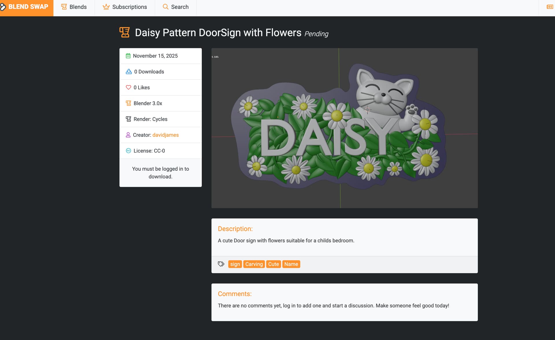

I posted the source Blend file on Blendswap for anyone to download, if you would like to make your own version you are welcome to. If you do please post your versions I would love to see them. DownloadPage Blendswap
