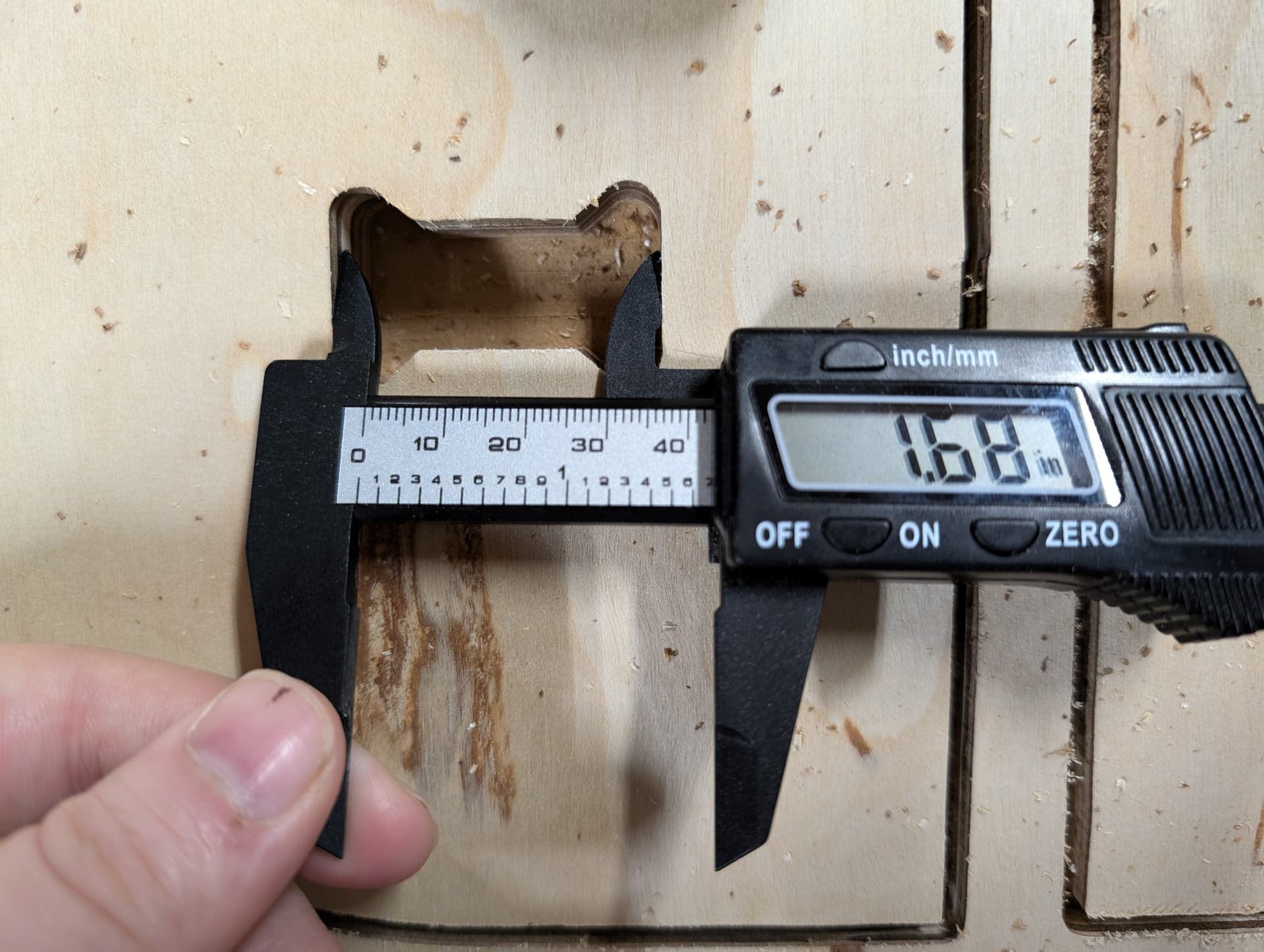

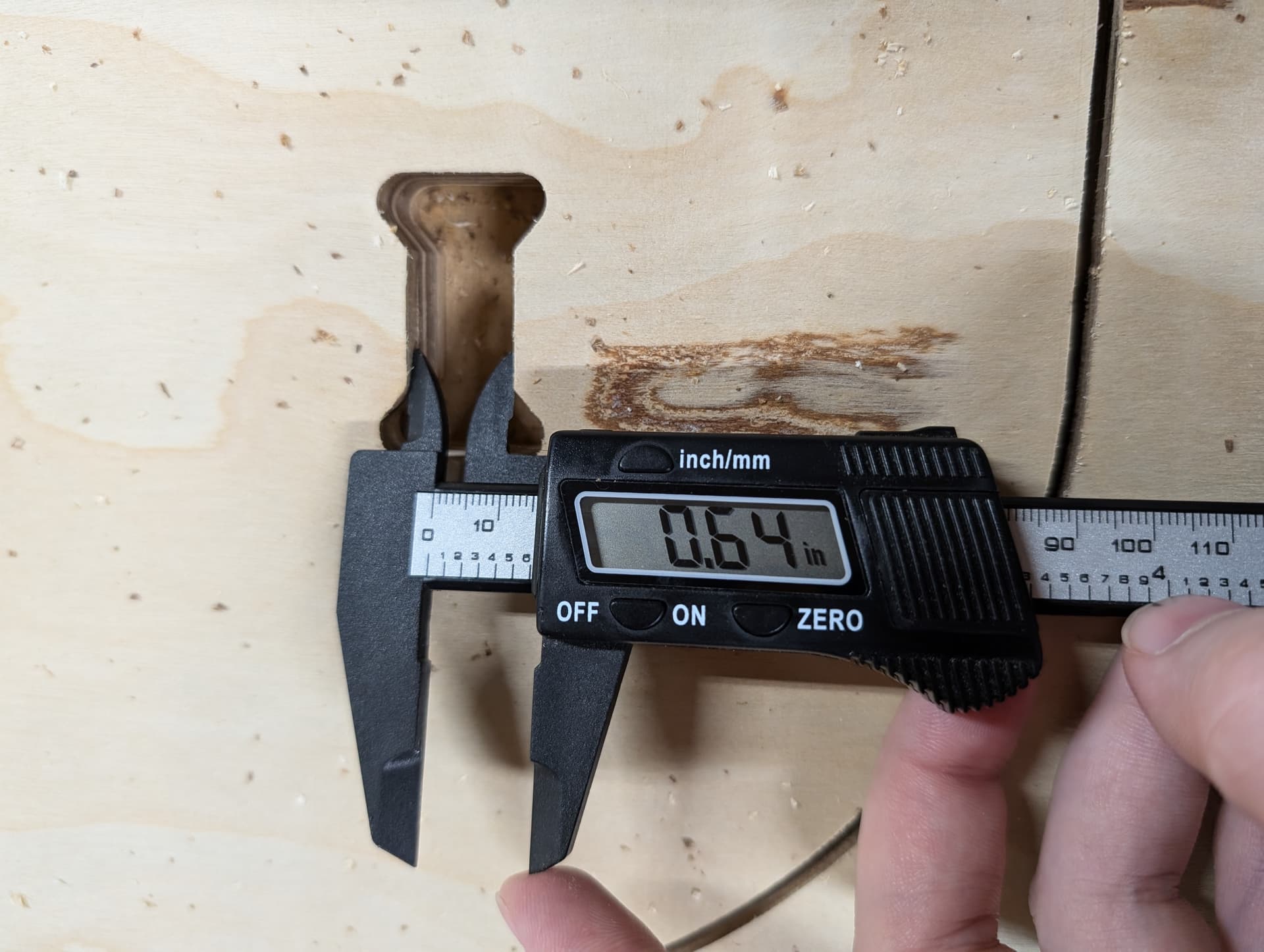

Dog bone pockets undersized
I originally thought I messed them up because I didn’t set the tool for finishing pass (side note: you do have to specifically set the tool for the finishing pass correct?). I made a new program to go and do those finishing passes and am still undersized.
I did the following test cuts, the two pieces on the left cut out no issues and slot together perfectly, but dog bone on the right is undersized in both x and y dimensions.
The dimensions when measuring in estl cam are 1.75in and .69in, and in the pictures you can see the dimensions I am ending up with. These are done with a finishing pass of .025". I have also tried the dog bone with a .01" finishing pass and it is still undersized the same amount.

Are you cutting the bone as a part or a hole? The two pieces on the left look like parts, but the bone on the right looks like it is being cut as a hole.
Welp, turns out the bit was just too dull to cut properly. Swapped it out, did another test cut and they came out the right size.
