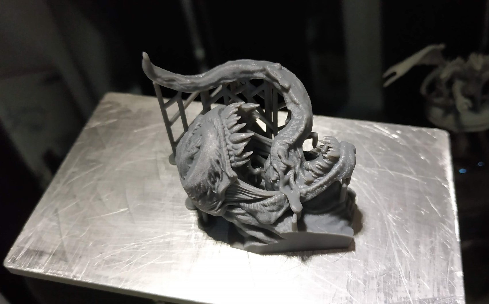

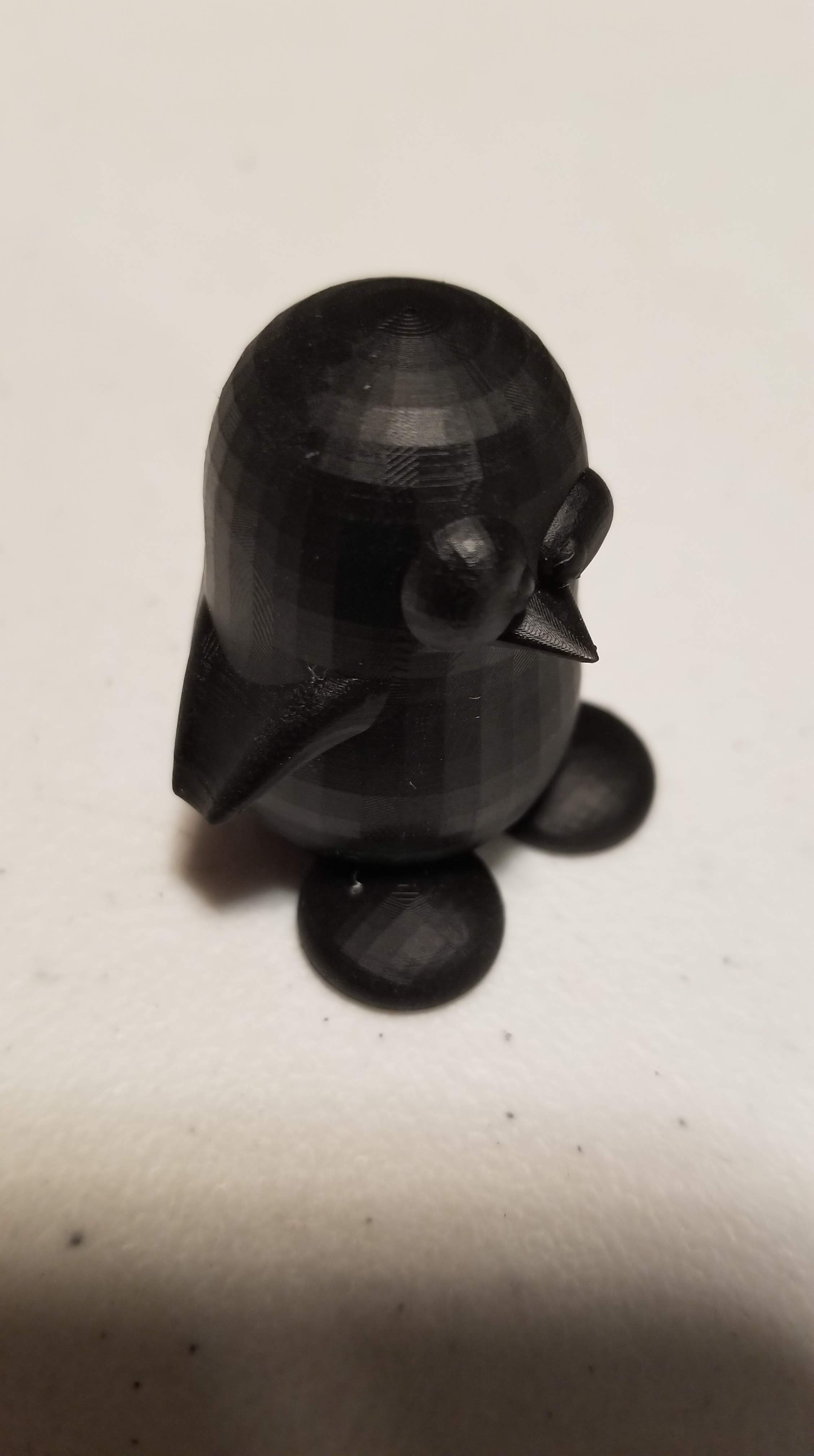

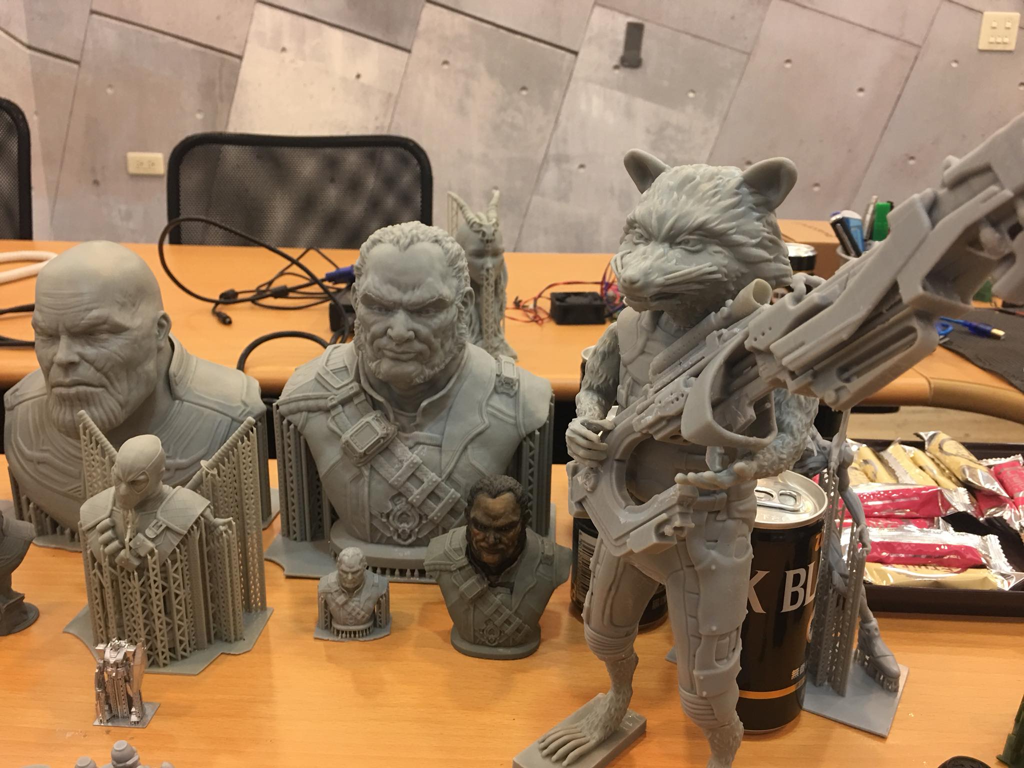

I’m really looking forward to seeing how your prints turn out! Here are a couple of prints I have handy to show the quality these machines are capable of. One is the DW660 mount I forgot to order for my MPCNC :D.
[attachment file=71667]
[attachment file=71668]

That’s some very sweet quality print, but why in hell would you use a low poly model for printing with such awesome machines!!! XD
Thanks for your kind post and keep up the good work!
Wow, I have to say it is a bit odd to see my model in high resolution. I look at them in such detail in CAD but somehow my brain knows to let some details go because they will disappear in the (FDM) print. I am seriously wondering if all those tiny chamfer’s are the same size… hmmmm more attention to detail from here on out.

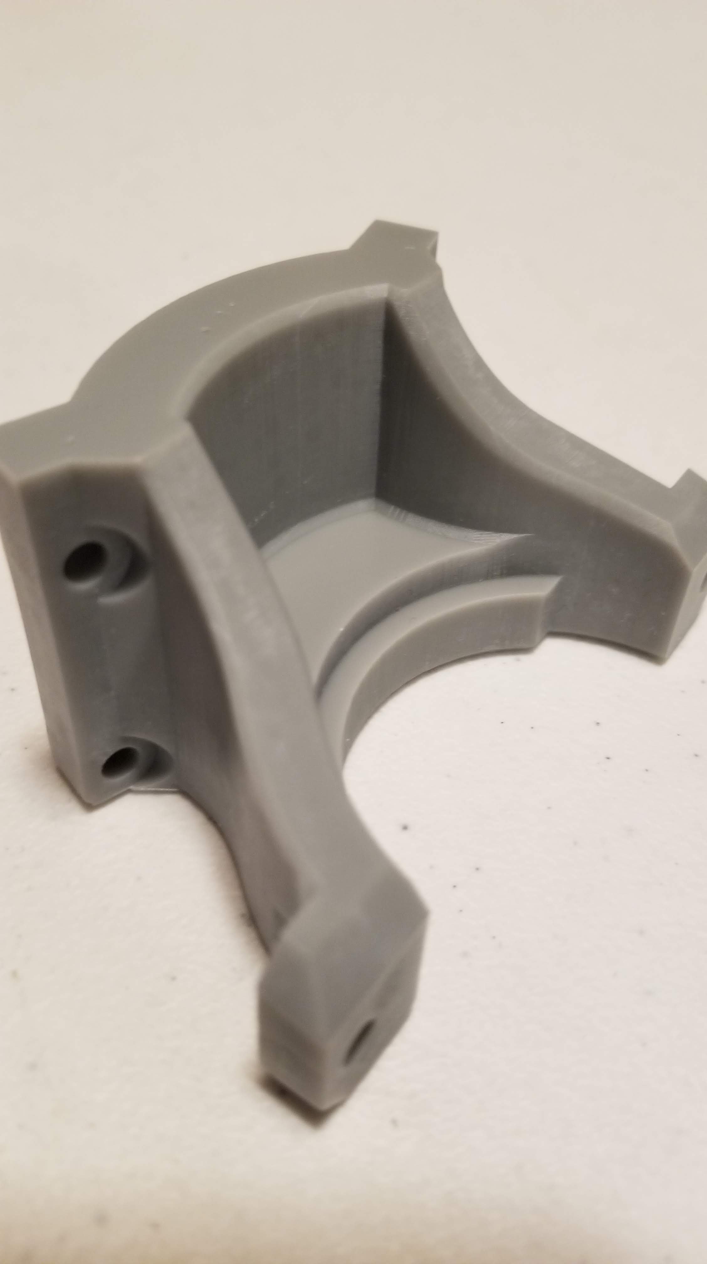

Meanwhile I had some time to kill this weekend and I had a lot of motors, electronics and stuff hanging in my drawers doing nothing. So I decided to put them all together and build myself another delta printer.
[attachment file=74539]
For this one I went with a 0.6mm nozzle. After a few prints, I now think this nozzle size is really quite a nice compromize between speed and precision. For mechanical parts it is pretty much the best, you get faster and stronger prints, but the quality remains perfectly acceptable for small and intricate details. Pretty happy with this nozzle diameter so far.
