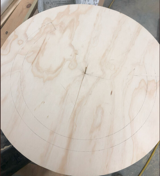

I didn’t make plans for mine, but I probably have some pictures somewhere from when I put it together…
The thing I like the most is that it stops any big chips, screws, etc from striking my impeller, and stops planer/jointer shavings from clogging up the impeller inlet
Seems I wasn’t in a picture taking mood that day…maybe because the game was on :slight_smile:
I have this picture near the end of assembly
and one with the sketch of the opening
and complete
The only trick to it is getting the beginning of the hole that the dust falls in lined up so that it starts a bit away from the inlet. You want the hole to be on the main part of the travel path of the sawdust.
I also printed another part like what is on top and have that on the inside pointing down to try to stop any dust from getting sucked in too easily.
