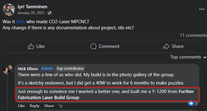

@nellson also converted a MPCNC to a CO2 laser already.

Maybe this is enough to convince use then… lol
I had thought about changing out the primo for it but I really wanted to gain build size as well. And I wasn’t sure how fast I could run the primo at a 2’ x 4’. It does good at the 2’x2’ it’s at now. More than fast enough for the diode laser. But I’m not sure it would be a good fit for the co2. That’s what lead me to finding a diy solution. Still holding out hope that @vicious1 is secretly whipping up plans for one and I just wasted $15 on all the other plans lol
and Nick is an admin of that group too…

While I did get mirrors mounted on the MPCNC, and cut jigsaw puzzles for 6 months with a 40W tube, it was quite sketchy. The bearing to tube interface had a lot of vibration, and the mirrors amplified it.
And no way was the mass of the gantry going to allow rastering for a tube of 75W or more.
Ya need something built for speed.
