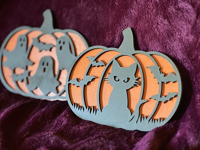

Cutting will be the main focus for this laser. I will still have the primo with the diode for doing engraving if needed.
I did just pick up the lightburn camera to add to the primo laser so we will see how that goes. And if well I will want to add one to the co2 laser as well
Here are a few of the things she is making. And why I’m wanting to go CO2 lol
OMG that is crazy good. Easily pay for itself!
