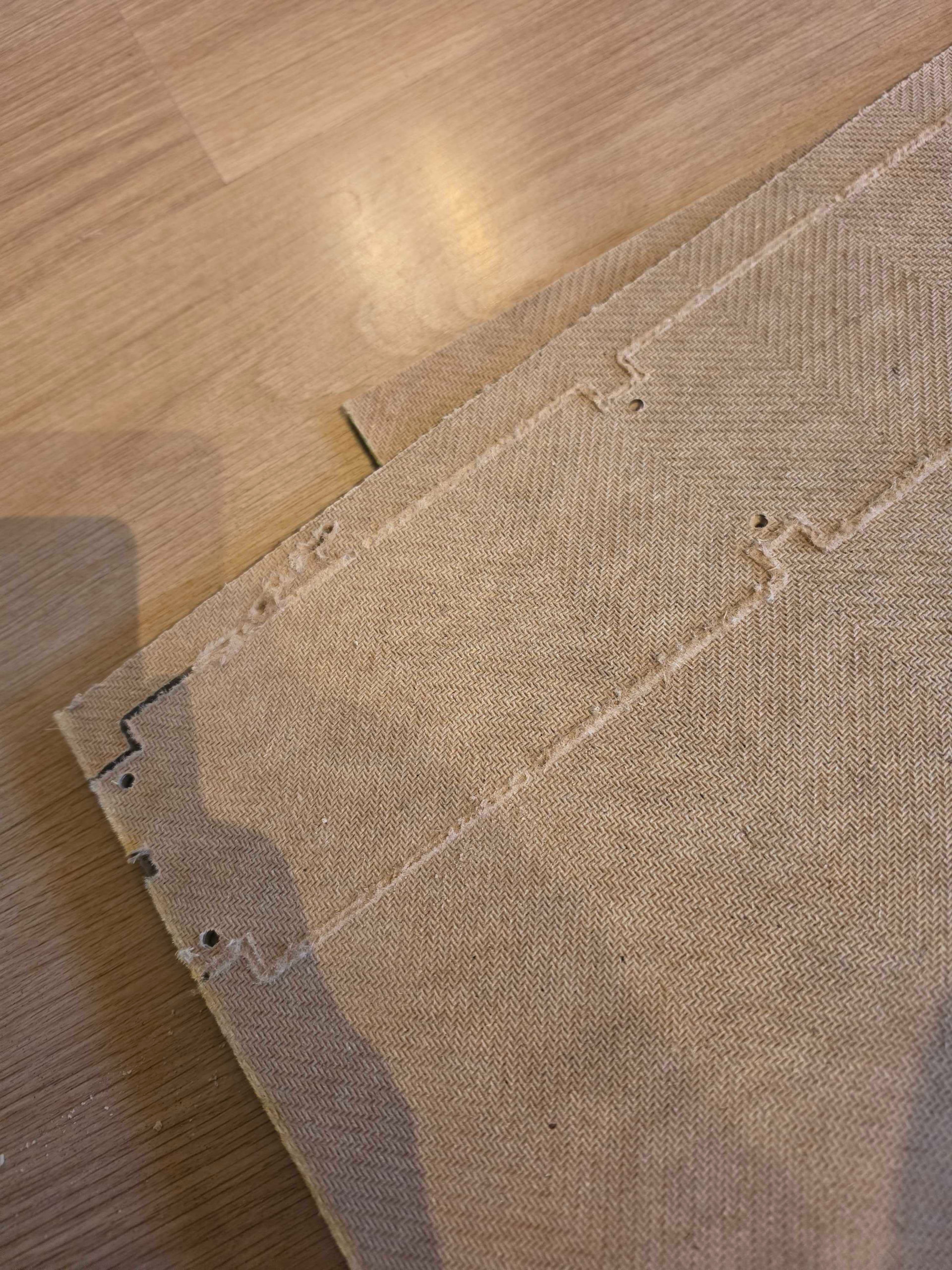

The holes were done ok. And the machine started to do the whole outline of the strut. In theory I have a Z step of 1 mm so quite a few passes would have been needed
Already on the first pass at some point I started hearing a change in pitch in the sound of the router, to something of a much higher pitch which for me is a sign of the bit probably getting too hot. I lowered the speed to 5 on the go which now reading the manual again I figured out is a big NO-NO. But anyway the high pitch lowered down so I figured out I kind of solved the issue.

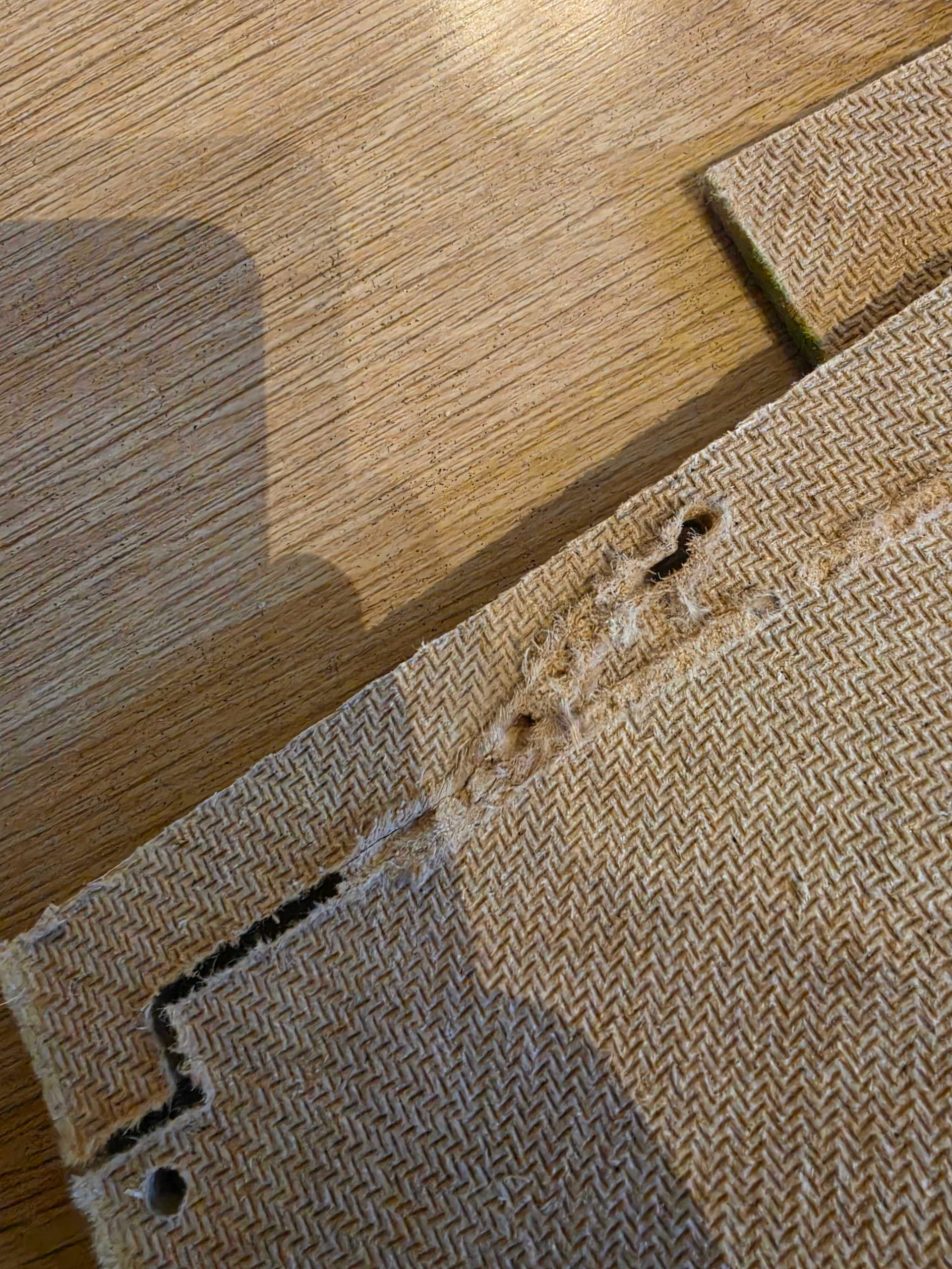

I noticed also this type of hard board when cut doesnt leave a clean valley like the mdf but the fibers spread and fluff up. After finishing the first lap and going for the second pass (so 2mm deep) the pitch change to really high, i noticed the machine started to get stuck (jumpy behaviour on the steppers) so that to me was a really bad sign and I went immediately to stop the sequence but in the time it took me to do it I could see a small flame come from under the bristles. (Yeah I also had the bristles on so couldnt see really what the router tip was doing, which for the first cut probably was another mistake)

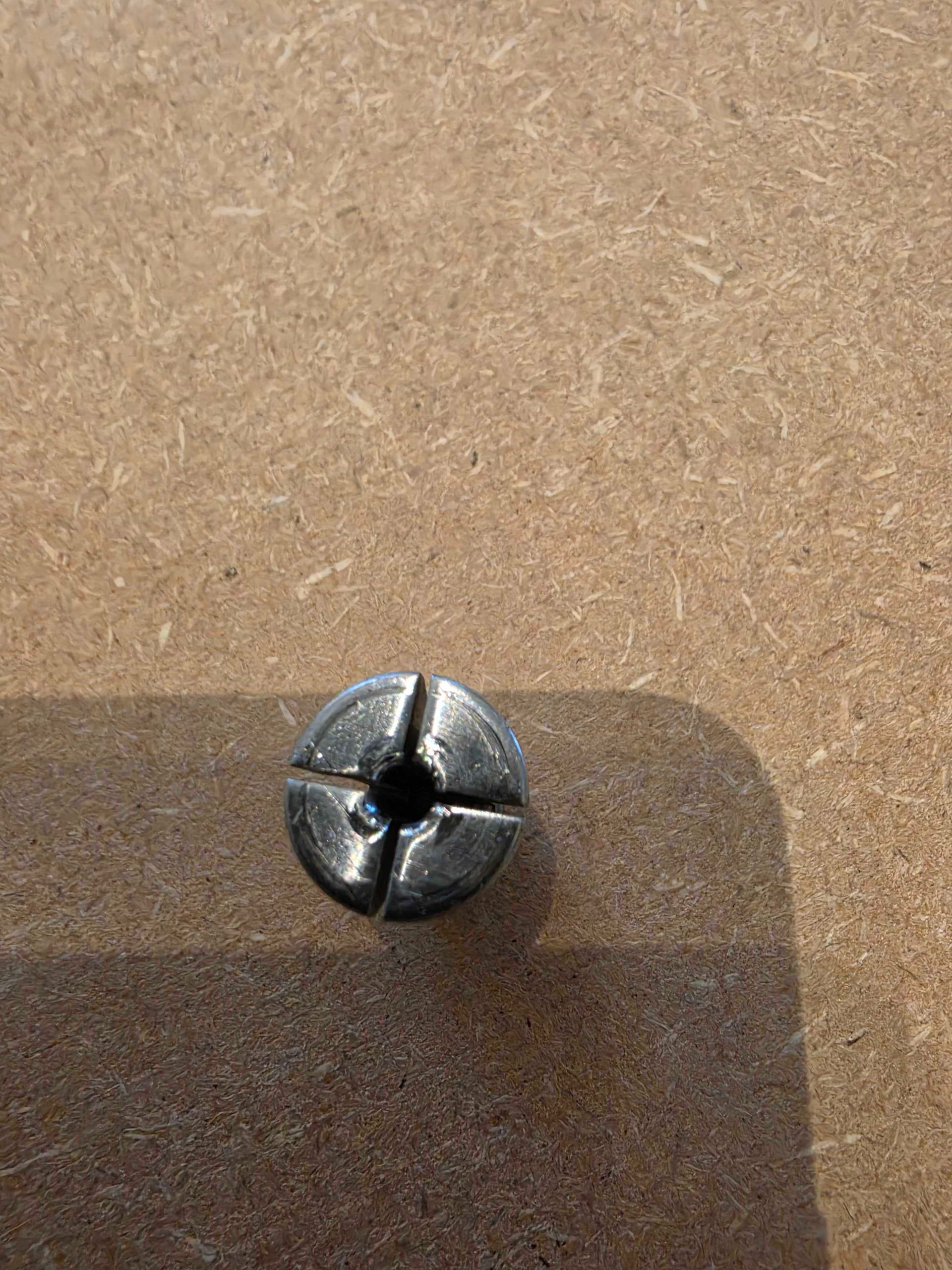

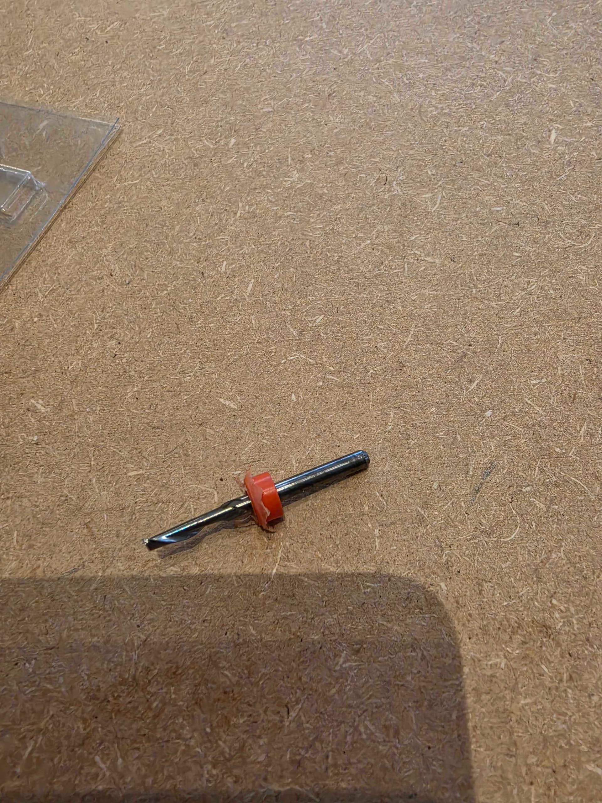

After everything was stopped I lifted the router and what happened is that the bit was out of the collet and had lodged itself into the board at an angle like completely in. So somehow had came out of the collet. The plastic bit on the bit was partially melted (and now is loose). I cannot see the bit bent or damaged which is kind of a miracle. The collet though shows some signs of damage in the opening , but is not really crazy. Dont know if it can be an issue (image attached)
In the board I was cutting it seems the second pass was already cutting all the way to the bottom, as you can see in the images as well, which is strange cause it should only have gone as deep as 2mm (I checked this in the gcode as well). I dont know if the bit came somehow loose and sink more into the material, or was caused by too much heating when started to sink more into the material… Im not really sure. But that was kind of scary

That’s the problem if you are going too slow, with too many RPM and only 1mm deep. The CNC is not making chips (I mean, it’s not going to do so in MDF anyway) or cutting enough material. This is needed to take care of the heat that is produced. You went slowly, not very deep and with too much RPM which makes the endmill heat up basically instantly. This leads to the collet losing grip and the tool slipping. Has happened to me before with a 6mm endmill in MDF. You should go much faster and at least 3mm in MDF to at least get rid of most of the heat.
This is definitely going to mess up your tolerances, but since it’s a hobby machine it might not be that bad. If you figure out that it is, hit me up… :stuck_out_tongue:
(Was that an Elaire collet? It looks pretty mangled up… O_o.)

The collet is the 1/8 adapter sold in the v1 shop

You think then i ruined this bit and i should get rid of it? :frowning:
The magic 8 ball says… “Signs point to Yes”
In your opinion as well should I replace the collet? I havent managed to find yet a place in europe to source the 1/8 collet for Makita
If it doesn’t hold tight anymore, is it worth the risk to ruin another endmill and the workpiece?
Was that mill blue-ish to yellow before? Otherwise it’s lost most of it’s hardness now.
I would, but I am pretty sure it might work like that albeit with a little more runout.
You can get them from me, I imported 30 from Ryan/Elaire last week:

This might not be the easiest material to cut though…
It seems it has some kind of “tissue” weave , and I expect that it’s impregnated with some kind of resin, which can be very hard to machine…
Reminds me of the “3.2mm melamine hardboards” we usually use as back covers for cabinetery
If so, I always had a lot of trouble cutting these (it lasers very nicely though… but with a lot of toxic fumes -_-)
Plain MDF should be easier to cut, and will still provide plenty strength

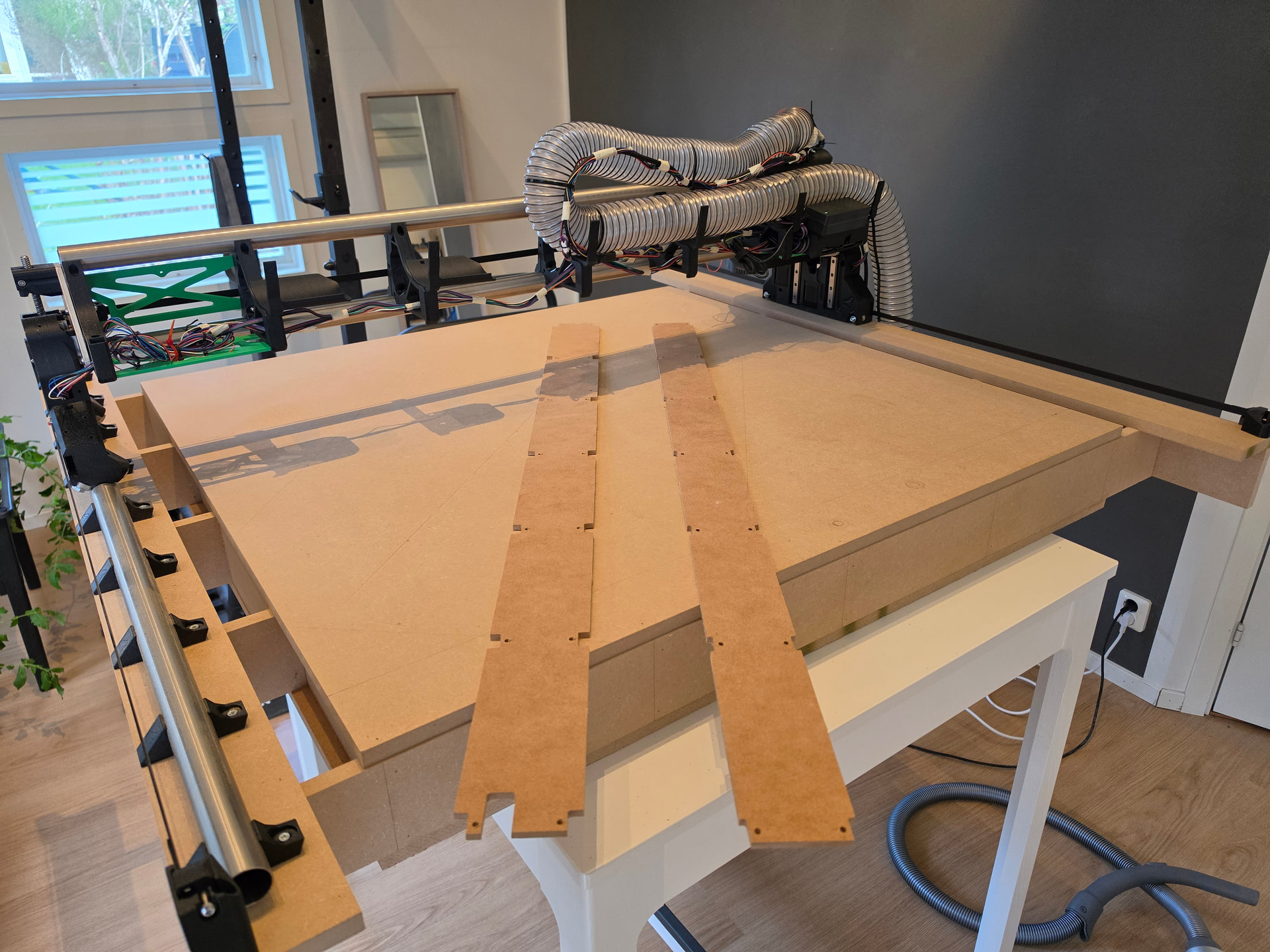

Hi guys. Just wanted to give an update and say to everybody thank you so much for the advice and your help. Wouldnt ever got to this point without you so, greatly appreciated.
The second attempt went like a charm and got my two struts cut in no time with zero issues.
I must say it felt like a magical moment to see the machine finally working. :blush:
