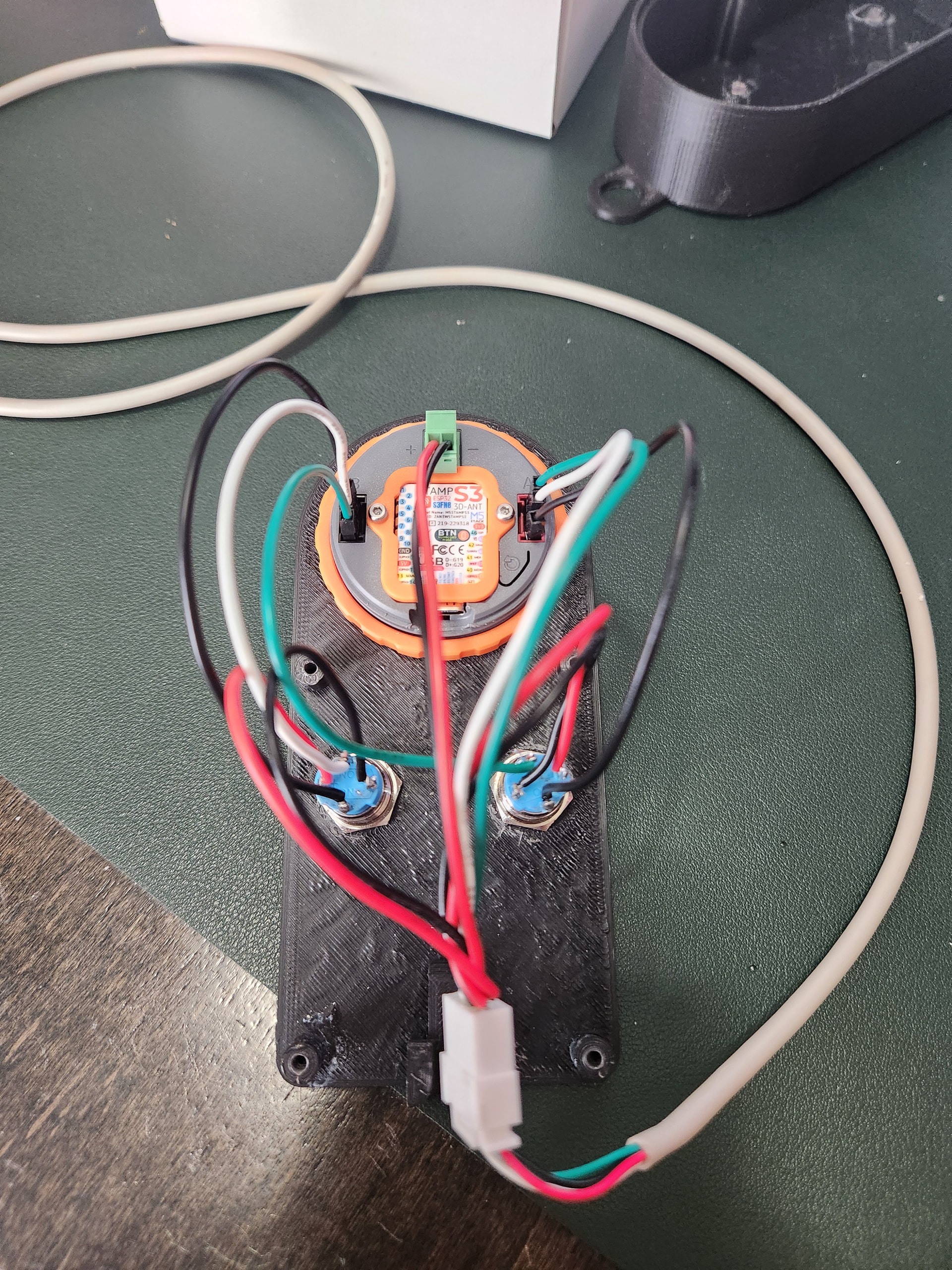

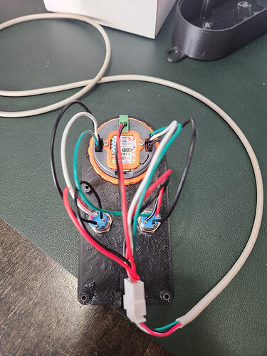

Last week I was wiring up my FluidDial pendant and managed to do the classic “how to let the smoke out” move: I accidentally put 5V into pin 14. Jackpot #1 did not survive my “learning experience.”

Can you show a picture of your pendant? You say FluidDial but maybe you mean the CYD pendant? It makes more sense to me that you would kill something with a CYD pendant vs the FluidDial with the connection kit. Are you sure you are using a straight wired RJ12 cable?

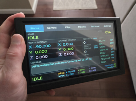

Side note: I’m a bit biased… but a pendant can’t kill a controller if it’s wireless. But also, you really don’t need a pendant at all.

I love your setup, at this point it would have been cheaper to go that route from the beginning! It is the FluidDial, I am not using the RJ12 but the gpio.13, gpio.14, VMot, and Gnd in the center of the board.
Oh, you should really be using the FluidDial wiring kit. It adds some protection and simplifies wiring.
