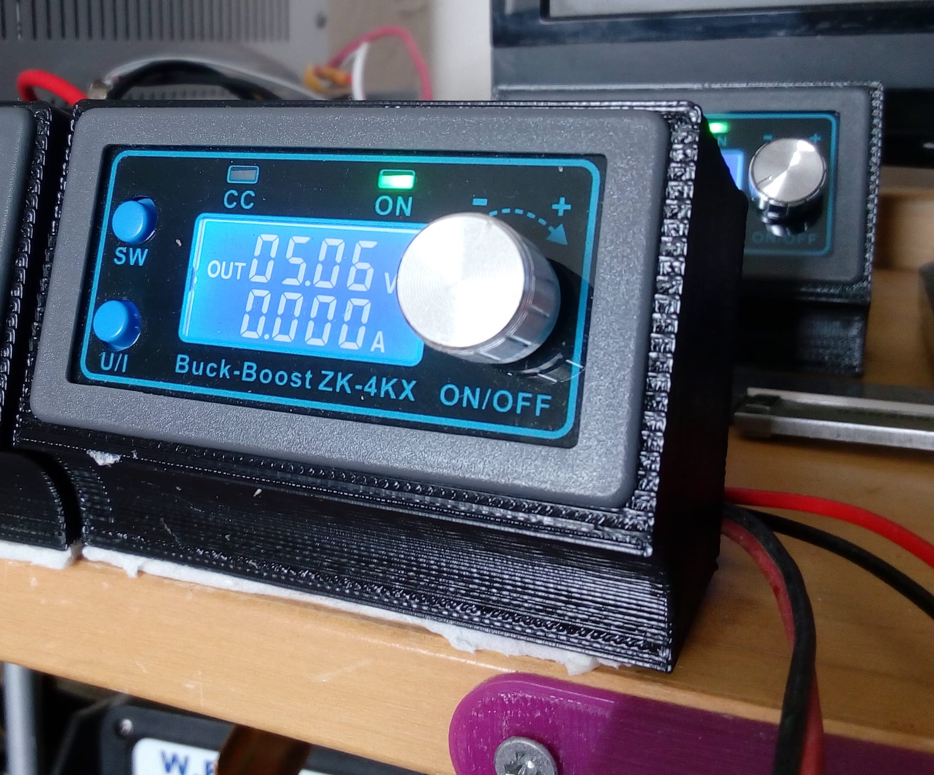

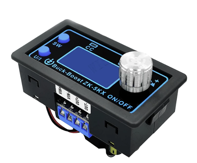

I use one of these buck down converters .
from a (somewhat) regulated bench PSU or a 12V lead acid. I found the cheapo Chinese bench PSU’s are not stable enough for my liking.
I made an enclosure for it…
https://drive.google.com/file/d/1EFzVe-1rBRdpvvBxSIn0p6FYnpjLlnMH/view?usp=sharing
It is current and voltage limited and will double up as a voltage injection tool for short circuit fault finding…
Put whatever leads and connectors on it you want…

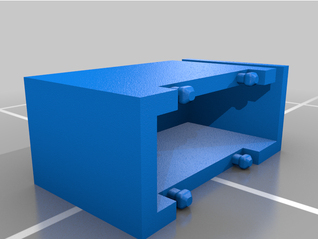

MB102 breakboard are quite practical, you can print a small enclosure to keep circuit safe from children:
