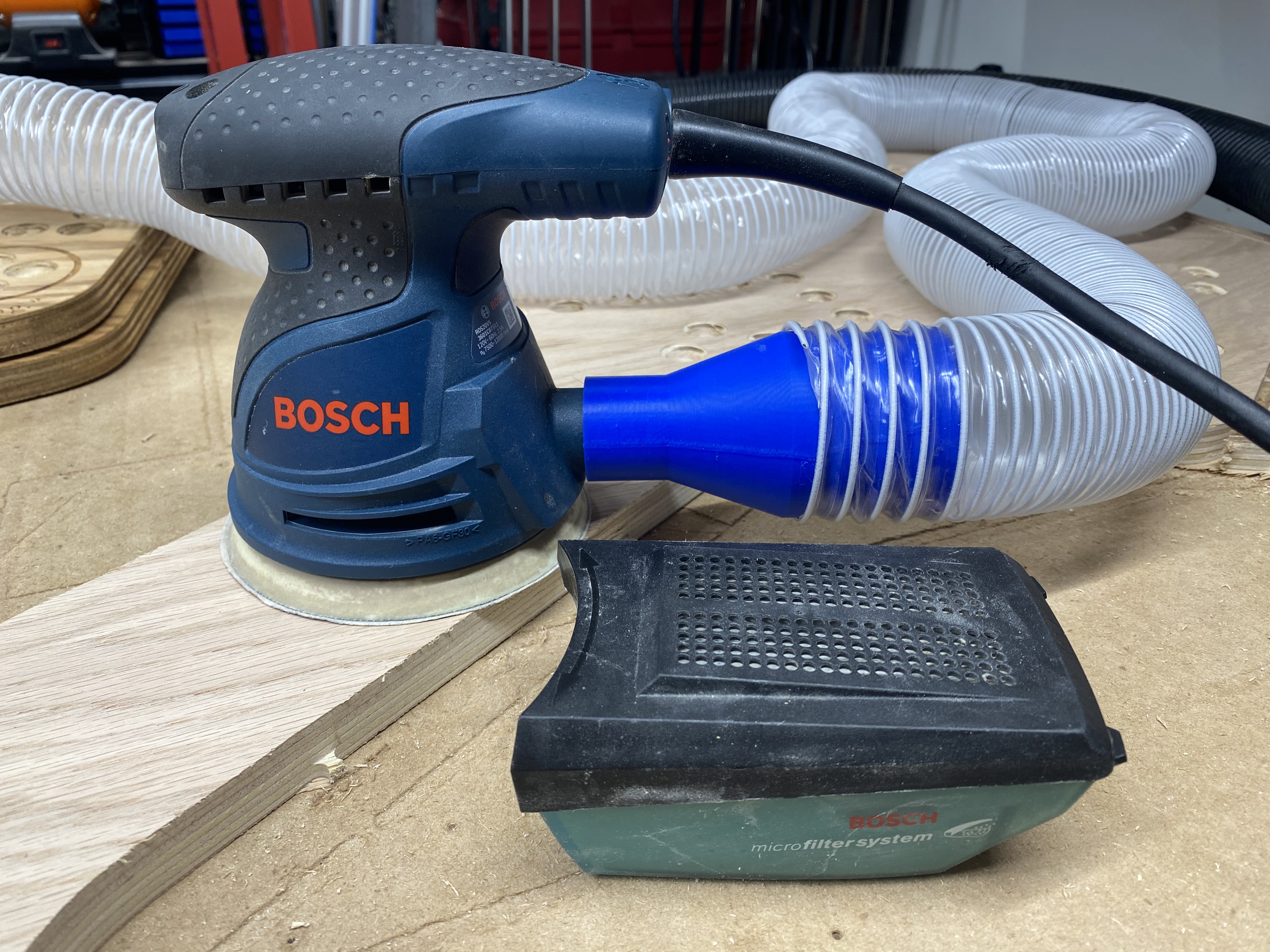

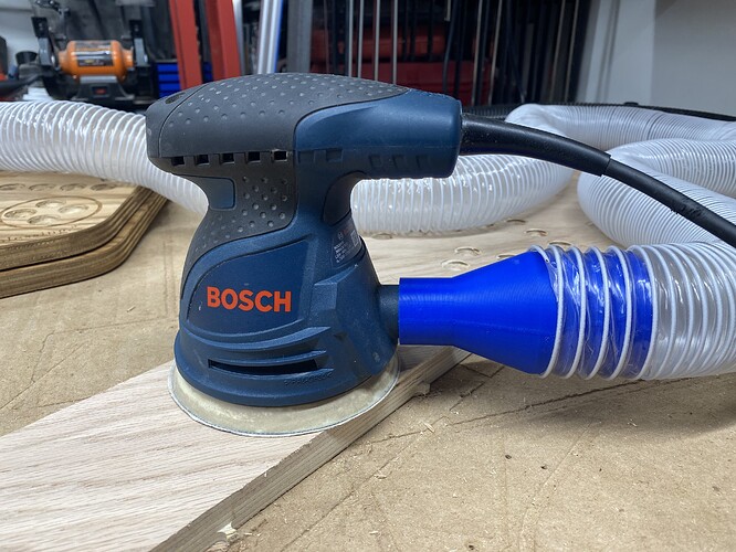

OK, I got the last iteration print completed, assembled, and tested, and it works great. Hose attachment seems to have no discernible leakage, and it’s a great functional print!

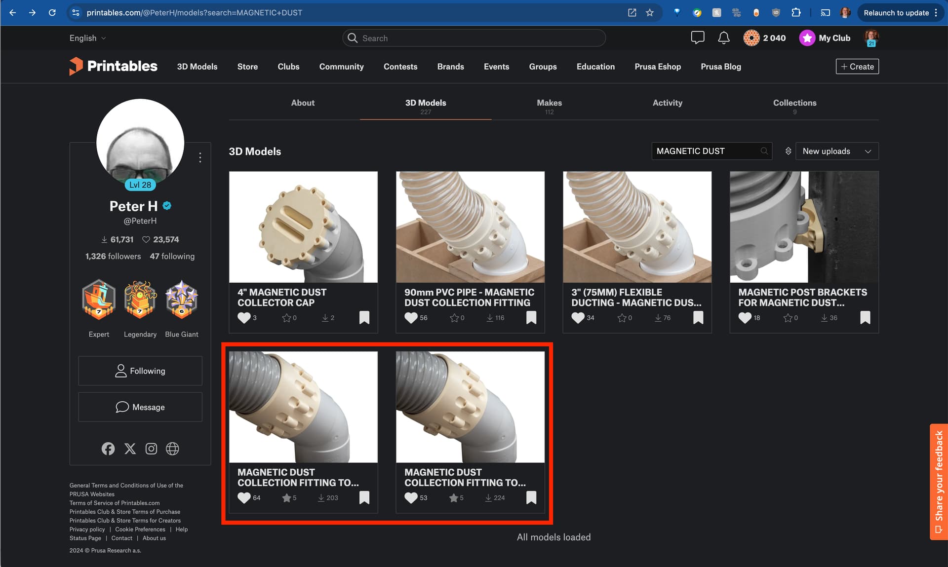

Hey, regarding the set shown here:
…can I get something like that, for flex, but for 2.5" ? Do you already have that?
Thanks for all you do!
I haven’t checked, but I think you will find that one is the threaded bit that fits on the flex and the other is the the end that fits on the PVC.
I have 100 and 90, but below that it gets a bit awkward, which is why I developed the camlock ends, but they are for normal 2" vac hose.
That 2.5" is an odd size for me. BTW, thanks for the prompt, I have printed the coupler, will upload both 2 and 2.5" versions tomorrow.

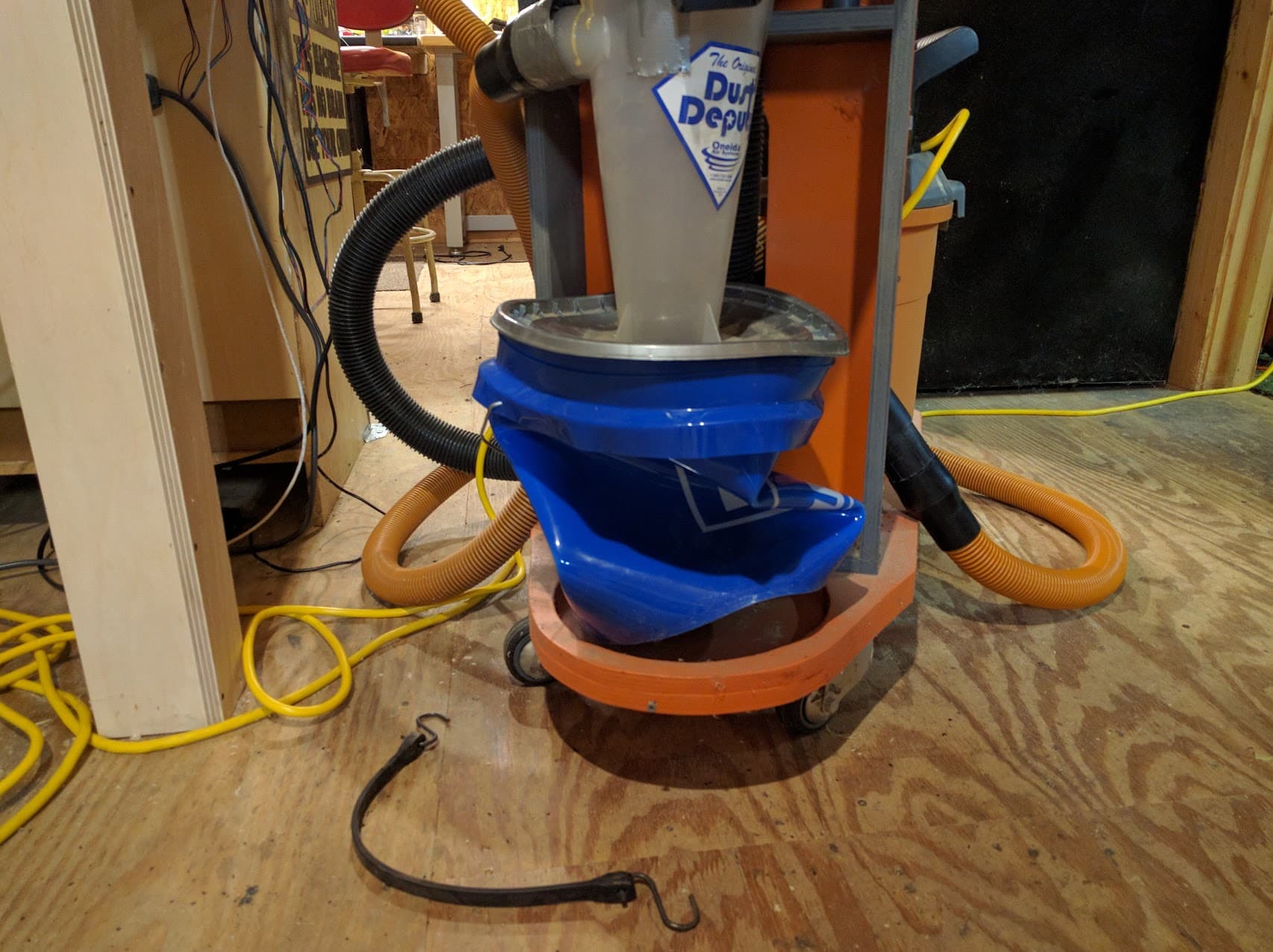

Careful with that metal trashcan. I collapsed one with a regular shopvac and a dust deputy.
@barry99705
Will watch it carefully. OK so far after some use.
I seem to have lost the can photo, but I do have a photo of the bucket I killed.

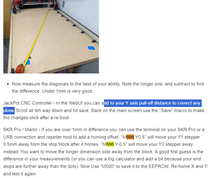

I’m finally getting around to checking my full-size newer LR4 machine (as opposed to my smaller RC3 LR4 machine) for being tram to the table surface, and for being square.
Tram Check
I have run some probe numbers near Min and Max, for checking tram, and it’s decently close to being tram right off the bat. I will need to make a slight adjustment to the pull off on one of the Z steppers. My “range” of sample numbers were tight on all samples, so that speaks to good repeatability. Taking average on all samples, my gantry’s Min and Max probe values are different by only about 0.227 mm.
Remembering that what I’m tramming against is a prior resurfacing of the spoil board that was performed by an earlier version of LowRider, I think this is all really good.
Now, mind you, I only checked for “tramness” on the near side of the big table, but still, I’m pleased with accepting a minor adjustment to pull off based on this.
Squareness Check
I ran a squareness check using sharp point bit to poke holes in tape at corners. Measuring diagonals with help from my youngest son, my new full size machine is only “minor” out of square by 2.5 mm. That would be more crucial on a small table, but even on this big table I can adjust to get it better.
Now if I can just remember who posted where … that formula or tool for finding out how much correction that calls for. Anyone remember? Tagging @azab2c and @jamiek and @SupraGuy in case it was one of them.
How to: Square your Lowrider by adjusting the end stops with M666
this?
Thank you! Re-reading it now! :slight_smile:
I did something very similar to this with my LR3…
However, for my LR4, I used a 1200mm x 1200mm square.
Whatever the difference between the 2 lengths was, I just adjusted the pulloff by half of that, and ran it again.
I got it square I think in 2 cycles, which in the end took less time than the amount of time I spent in CAD trying to measure it all out the first time
Ended up doing something similar to Dan’s topic, and created a quick sketch with partially constrained dimensions in Fusion360. Just searched and cannot find anywhere, I probably didn’t save :frowning:
Vaguely recall @Jonathjon mentioning something similar to Mike’s simpler straight forward approach…
Just double checked docs https://docs.v1e.com/lowrider/#initial-squaring, content looks a bit light on exactly how people should calc pulloff after diagonals are measure to be skewed?
Don’t remember how @jamiek calcs Skew compensation. Guessing he (or someone…) has a web hosted OpenSCAD based Table Skew Compensation calculator that’s linked, or within the LR4 Calc page, currently, or in the future :slight_smile:

I agree. It would take a lot less time to do it once, but since I am doing this for the 5th time Once LR2, Twice LR3, and have done once for LR4 RC1 and once LR4 RC3, and will bo doing it again for the release LR4, now the tool has paid off, plus. Sure, doing it ONCE, just do it. more than once is when you need a tool, and for people who really just want to measure and punch in a number, this works.
My intent was not to tell you, or Doug, not to do it that way. I was just offering my perspective.
I made a tool for my LR3. I don’t remember how long it took. Probably not that long. I am certain that I didn’t even bother saving the file because I assumed I would never need it again.
When I went to square my LR4, I went to my computer to do the same thing, and while waiting for Fusion to open, I decided not to bother, and just do the manual method.
It took me all of 5-10 minutes to square it.
That was 2 adjustments. 3 sets of dots on tape. Last one to verify it was accurate.
If anyone wants to create a tool, or feels it helps them, then I’m not against it, and was certainly NOT advocating against it.
But I also would want to be careful about making others think they NEED a tool, when it is absolutely not necessary.
All good points. I’m kinda like Dan, after doing squaring on multiple machines, I am looking for a way to “one and done“ it. The last time I remember doing it, I had to go through a bunch of iterations to get to where I felt like I was close enough. For me, at least in my current level of capacity, I prefer to take some time to do some kind of graphic / mathematical calculation and hopefully nail it on the first go round, and then simply have to confirm that it’s right.
I got it all trammed and squared. :slight_smile:
