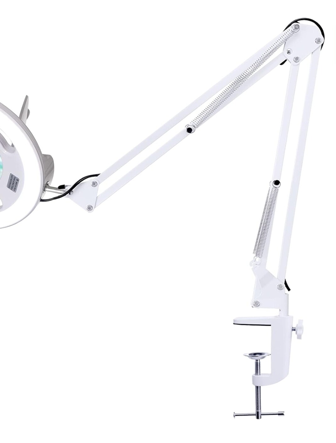

I’m curious if someone out there in “V1E Mechaniker" land has or can provide a reference to the design of these typical spring-loaded parallel raising and lowering mechanism, typical of desk lamps.

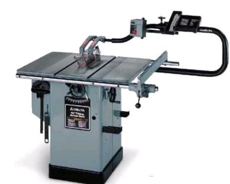

I also have the Delta Uniguard which works very well and is extremely convenient so you can actually routinely USE it, and I do/have (for more than 25 years). However, because of the split guard, it’s not suitable for dust collection.
A possible solution would be to design a mount for the SharkGuard shroud that is attached to the Uniguard rail and would allow the Shark to be raised and lowered with the spring mechanism providing a suitable counterbalance so that it will stay in place at a particular during dado or blade changing operations.
Right now, I have the SharkGuard attached to the Uniguard bracket so it can be rotated up and out of the way. But, it’s pretty wobbly and a bit awkward so I’m wondering if one of these parallelogram mechanisms might work better.
This is such a universal design that I figure there must be design rules for getting the proper dimension and locations of the spring, etc. The geometry is simple, but I’m not a mechanical engineer, so for me, doing it without an enormous amount of trial error doesn’t seem likely.

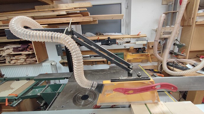

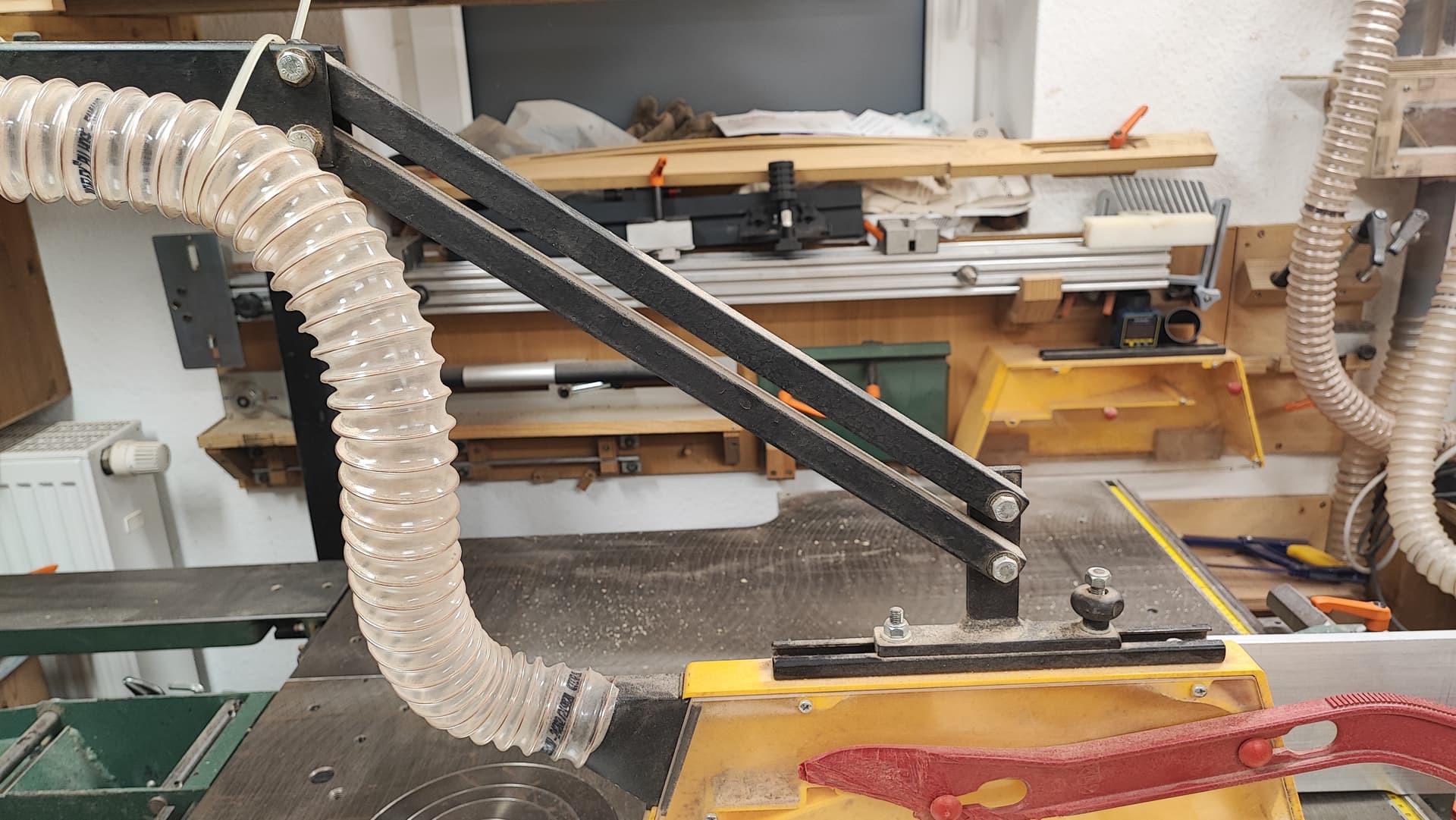

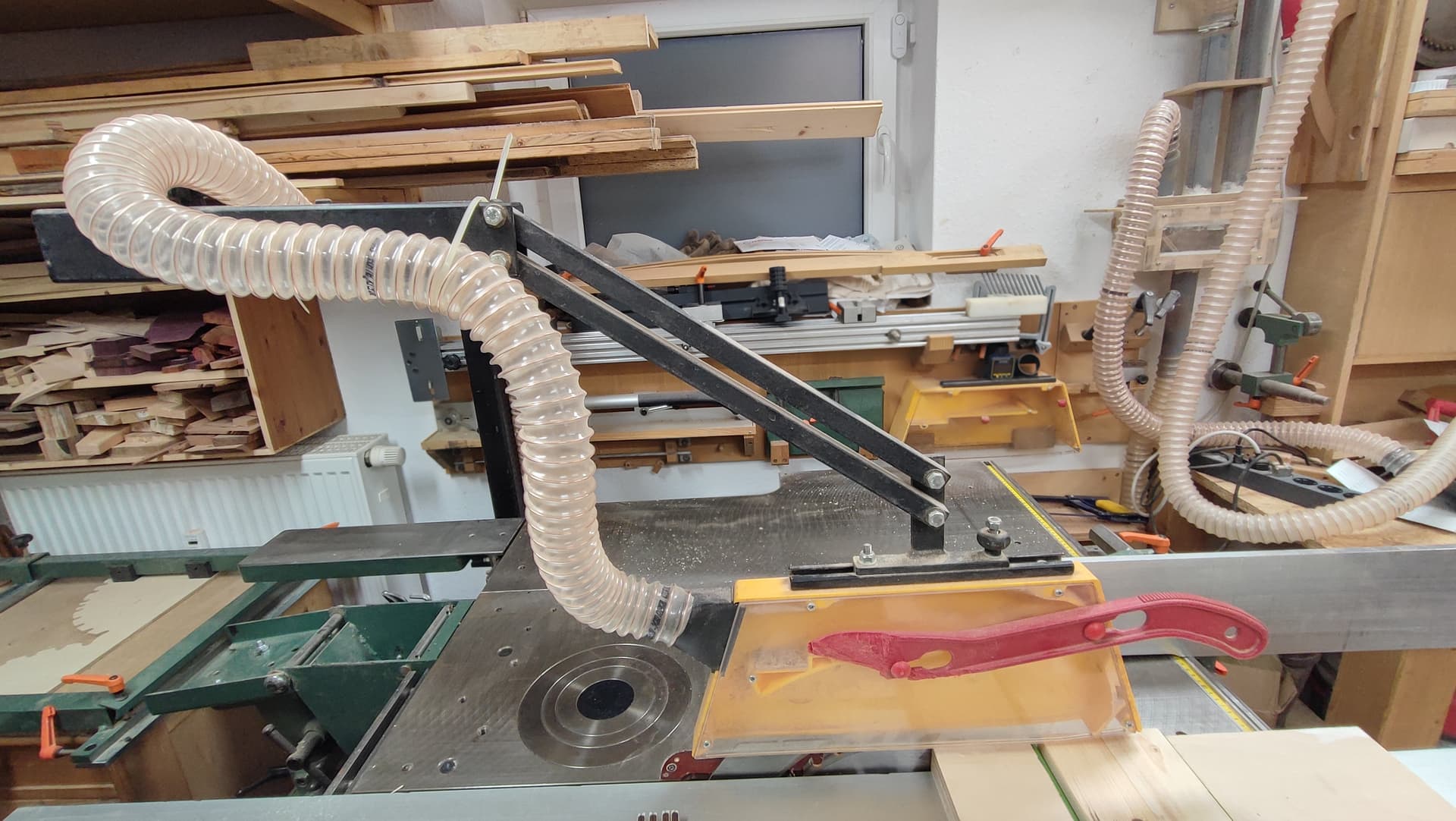

My saw has something like that but without springs, just bolts that are tight-ish. If I don’t forget I am going to take a picture. :slight_smile:
Thanks. I’ll be interested to see this.
Here you go. It’s really simple. The push stick doubles as a grip for the dust hood.
