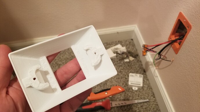

Have been using Slicer’s regular organic tree support, but that doesn’t work well for low floating features, so, especially for shared models, am leaning towards including intentionally designed features to mitigate risk of someone’s slicer generating bad support structure.

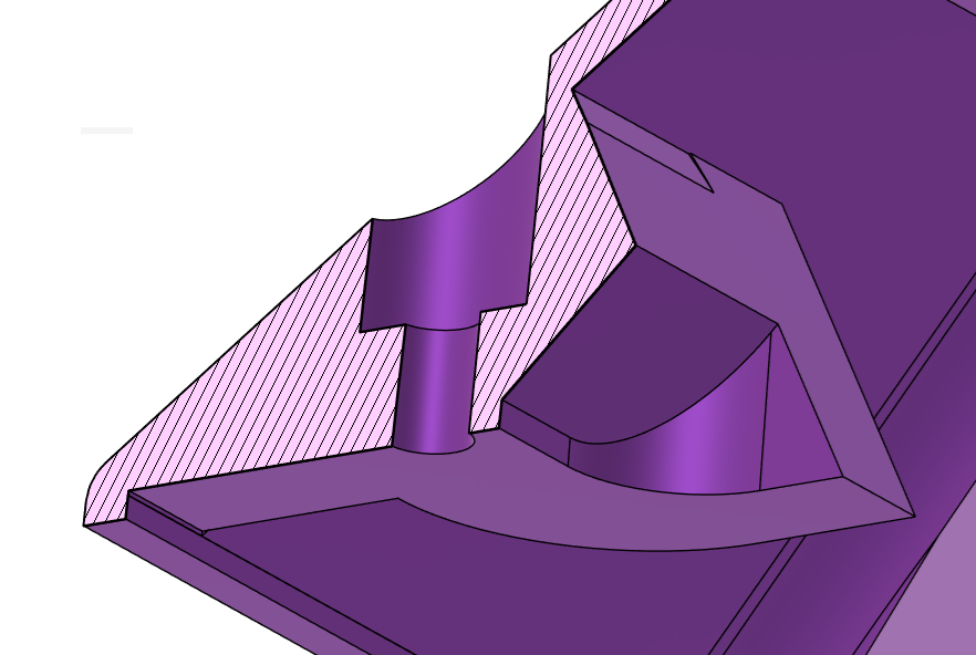

For example, and what sparked this rathole, I recently made a cover plate with bed adhered perimeters, but with boss and other features floating 1.2mm above the printer bed. Post print cleanup seemed to take longer than it should have, it didn’t need to be pretty, just needed enough clearance for mating parts. So, one edit was to increase tolerance so sloppy clean up of support structure didn’t overly interfere with final assembly.

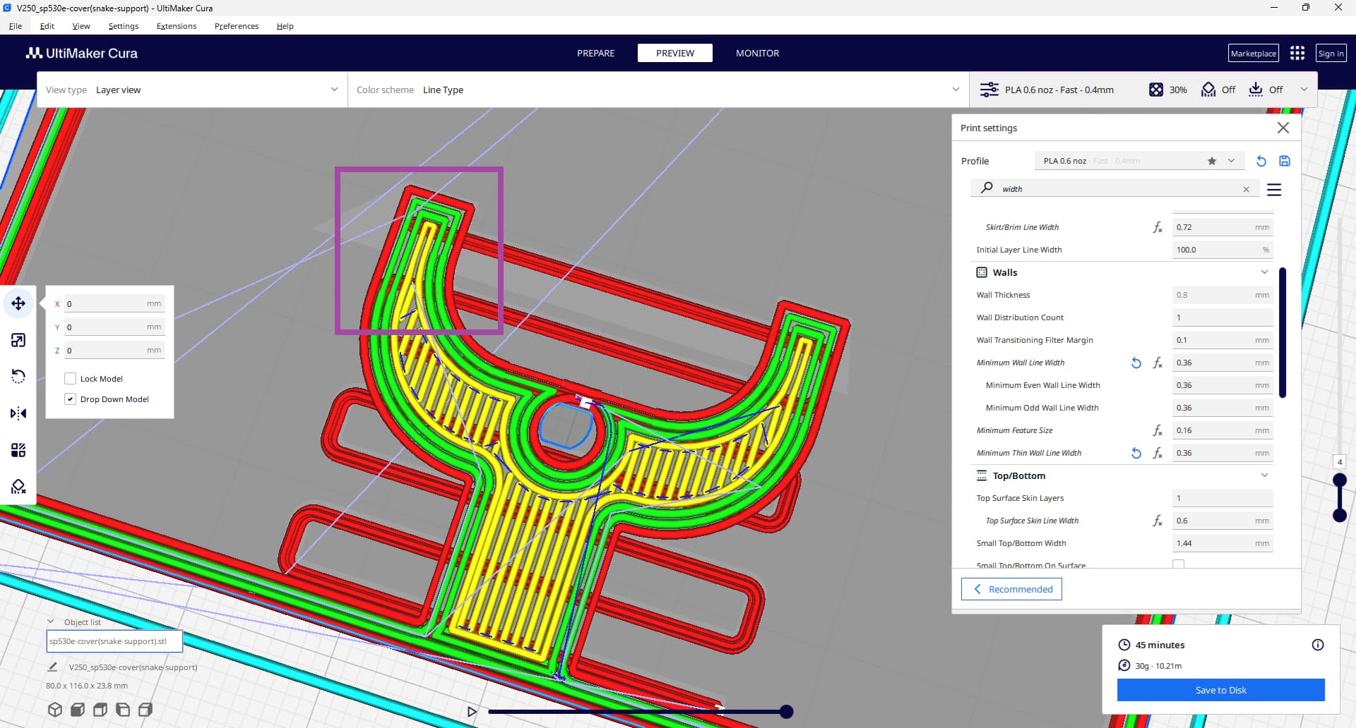

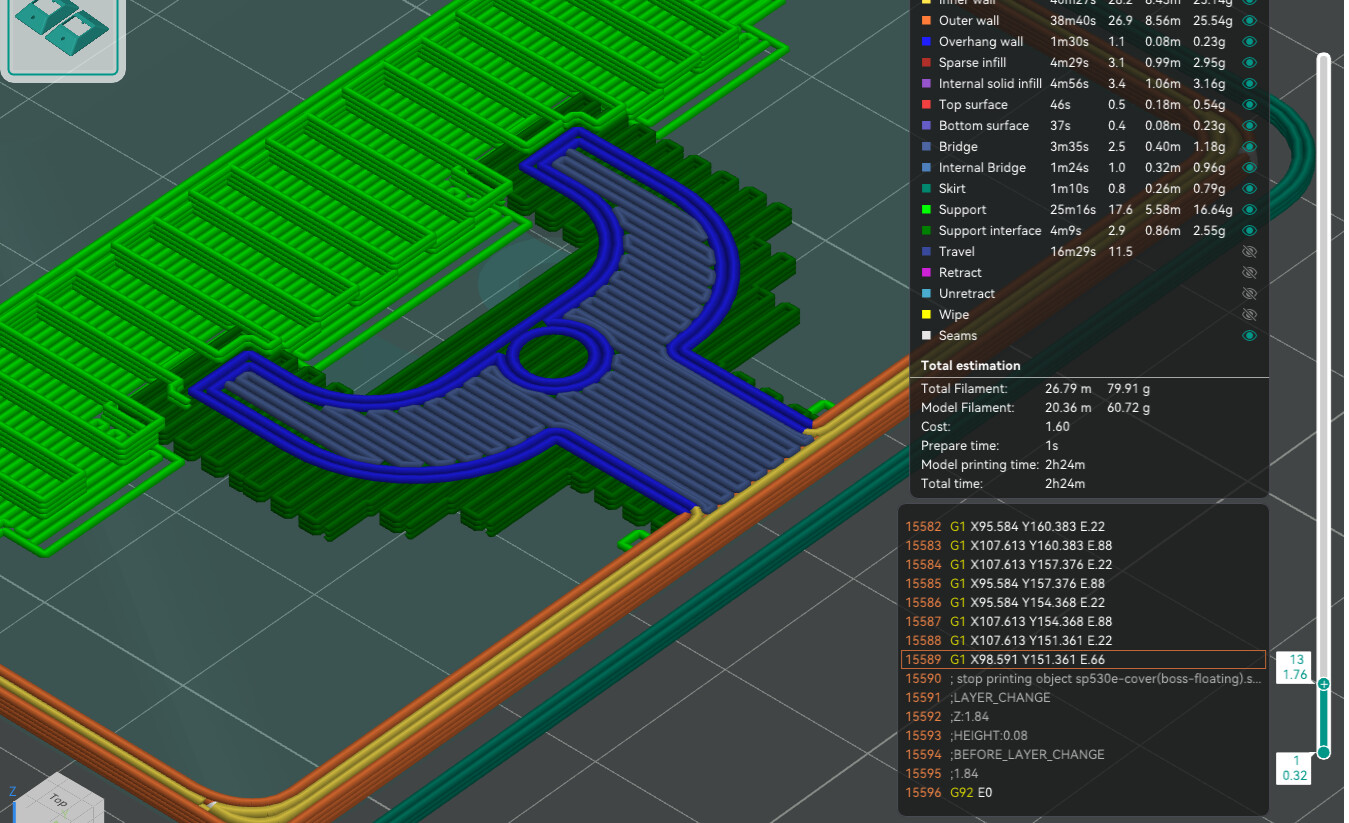

Default grid based support in Orca 2.3.1 looks ok, but narrow width for rib neck (top layer) would be nice…
Cura 5.11 (fwiw is notably better than 5.9 but still) creates an elaborate lattice with nice initial layer brim, but, the overall lattice doesn’t support inner walls as well as OrcaSlicer’s strategy…

Honestly before you overthink it I’d try a a couple of prints using the default slicer support generation- they’re much better than they used to be.
:slightly_smiling_face: too late… And, I agree… am currently installing (ugly inside, but) good enough to use 2nd test part printed yesterday (Cura). Cleanup took long enough that I started getting curious about better options. Trying Orca for next print/design.

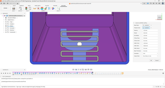

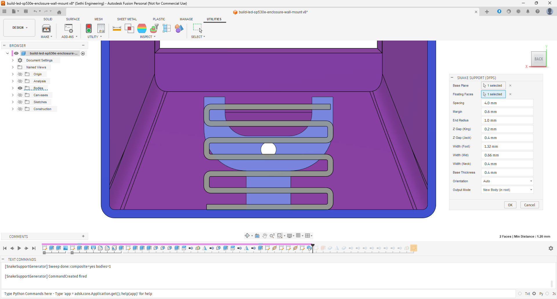

Ended up making a fusion 360 add-in to generate “snake” support…
Still tweaking (e.g outer line segments should land slightly inset under “floating face” outer skins, curves should extend past “floating face” skins, etc…).
Am sharing progress incase someone’s seen, done or is interested in design time break away support?
Started creating out of curiousity, and as an opportunity to learn more about automating geometry tasks. Was supposed to be a short time boxed effort… but ego won’t let me stop until a reasonable ‘done’ milestone is achieved.:man_facepalming: That said, I’ll gladly stop if this has been done already by someone?
