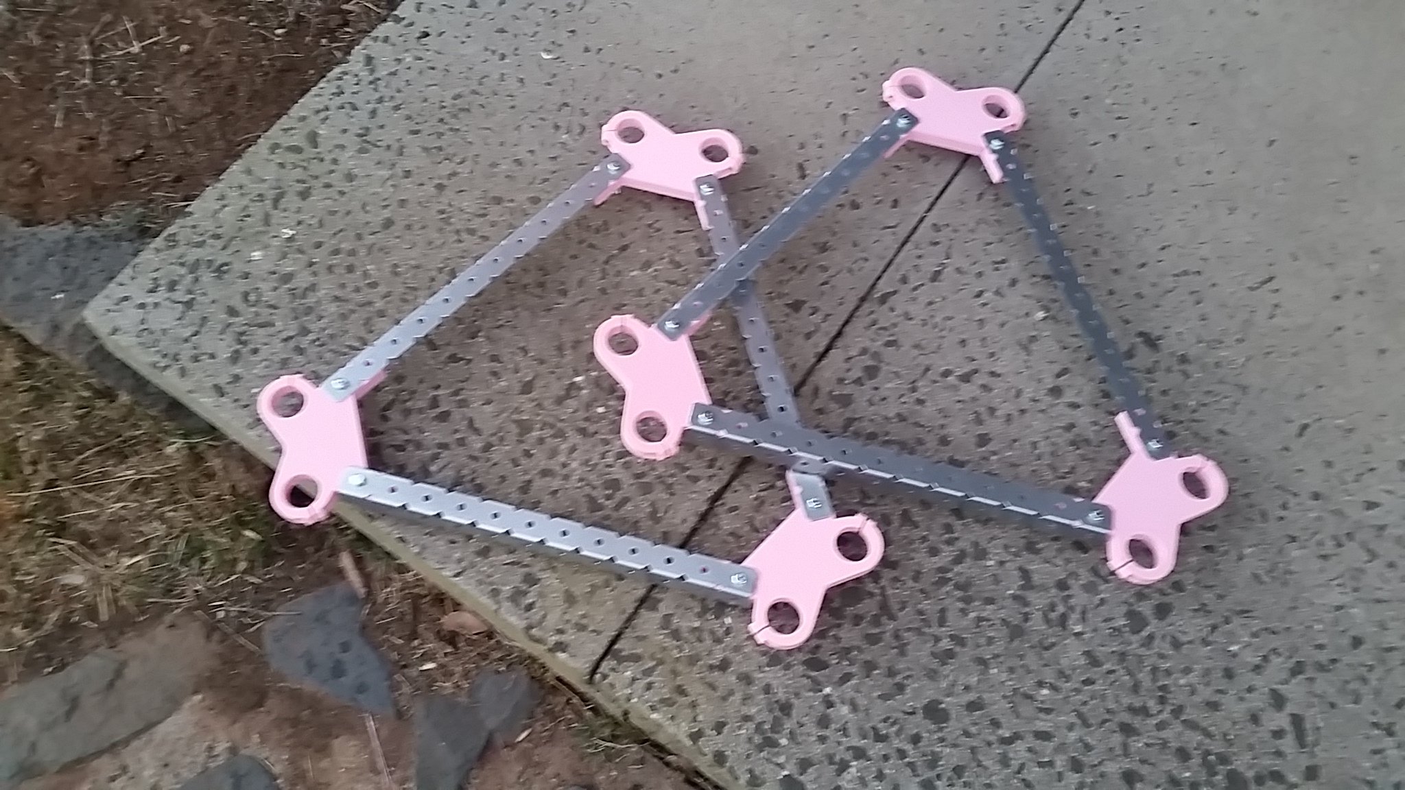

Okay, spent some time doing other things, but back to this now. Here are the parts of I have printed, the angle metal and the 25mm tubes I have set up for my MPD3DP (Mostly Printed Delta 3 D Printer).
I will be posting the modified files/etc one I have it completly up and running, but here are some pictures of the parts I have modded (from the original MPCNC -F) and how they fit together.
The angle metal seperating the parts was originally 60cm long (as purchaesd from Bunnings) but for this so far, I have cut them in half to make it more manageable.
The idea is nice but you should beef up those connectors, I would print them at least 3 or 4 times thicker, otherwise the structure will be very weak and wobbly. Sturdyness is pretty important on delta printers if you want good results
Agreed. Those are just the connectors. the Z motor mounts have to go on, as well as re-purpose the tool mount bracket to be placed along/between the pipes to keep them aligned.etc.
Plus the angle metal can be connected diagonally for more bracing.
My drive is to make this as much printed as possible, and source parts locally as much as possible, rather than going to buy smooth rods/etc from the web. I know I will have to get motors/RAMPS/electronics from online, but as much as possible I am trying to source locally.
Lets just see how Version 1 turns out using as much MPCNC stock (or minorly modified) parts as possible.

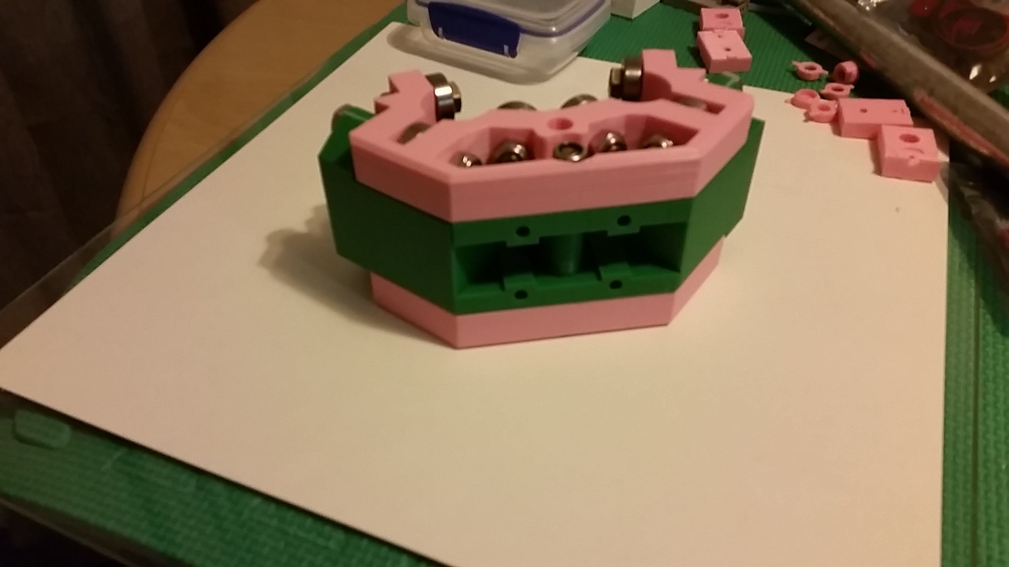

Update. Finished designing(/remixing) the new parts to go in the middle of the XYZ parts.
pink original parts. Green modded/remixed parts.
Check the facebook group for the video of it hand moving on the pipes.
