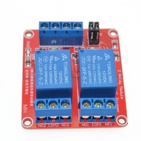

Please help me with an advise: I’m using a Vevor 1,5kW spindle with VFD with a MKS GEN v1.4 board with Marlin 2. Connected to pin 6 and RPM is working fine, but for changing spindle direction I failed. It has pin 5 assigned for SPINDLE_DIR_PIN and I assigned as seen in the posts another one, pin 65 and connected the pins to FWD and REV. Still not working.
I’m sorry, I am not familiar with that board so I can’t give any specific advice. It also depends how your particular vfd works…
But I will say to make sure the logic levels (voltage) of the vfd matches your board. My vfd was 12v logic but the mini Rambo board was using was 5v. I burnt up quite a few pins before I figured it out.
Thank you, I believe 5V. So, the idea is to connect one pin to FWD and the second one to REV?

modul-releu-cu-optocuplor-nivel-high-sau-low-selectabil-2-canale-5v
