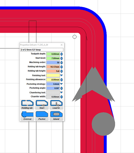

Since I have it, an example of profiling (8mm undercut) with a T-slot tool defined as a regular endmill (v11 or 12).

…Correction, defining a dovetail bit as a profiling tool doesn’t work / has no useful application. Profile tools need to match the drawing (largest Diameter/D1 at the top), will always be cut to Height H: depth (regardless of the Cutting depth:) and the path will always have a properly calculated (D1 - D2 / 2) negative path offset (v12). The same thing can be accomplished by defining a regular endmill with a D1 Diameter, a cut depth that equals Height and a negative Finishing allowance that equals D1 - D2 / 2.
Currently any undercutting (below the surface side cutting) profile tool (dovetail, t-slot, lollipop, upside-down chamfer, etc.), any tool where the largest cutting edge diameter is not at the top, needs to be defined as a regular endmill. Like top profiling, the shape details (angle, radius, etc.) don’t matter. All that matters is the (desired) profile height and width.
Undercutting needs a Lead-in, Depth = 0 (typical, can be more), Start level (e.g. 12.7 for that dovetail) and a profile width negative Finishing allowance (/path offset, e.g. D1 - D2 / 2 = -3.175 for that dovetail). Any deep side cutting will require multiple paths (e.g. above -4 and -8 t-slot example)… Start level will depend on the profile and where it is to be cut, e.g. a 12mm tall profile centered on a 20mm edge would have a 16mm Start level, (20 / 2) = 10 (material center) + (12 / 2) = 6 (1/2 profile height).
