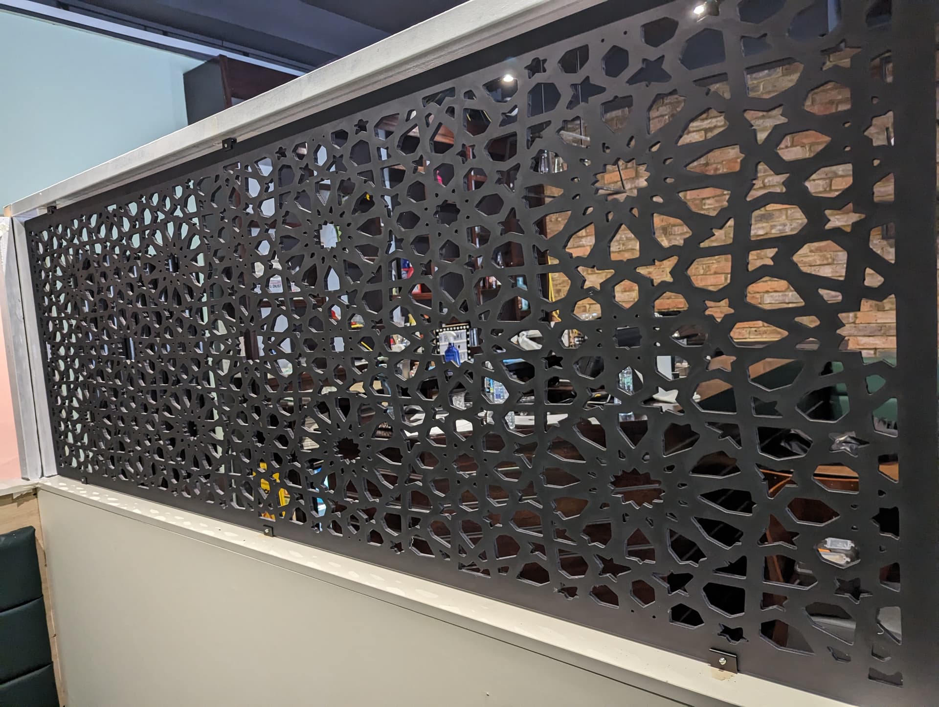

Here’s a decorative panel I made, cut using black MDF and finished with Osmo oil.
I can’t recall the dimensions but it was close to 8’ x 2.5’.
Here it is up and doing it’s job

How long did that take to cut!?
4.5 hours, used a 3.175mm compression bit and did 2 passes at 4.5mm depth.
Had to make 2 for this one. Was nervous, so did a 25cm x 25cm test cut, but it all came out flawless.
