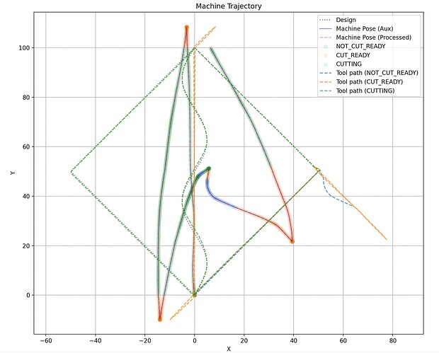

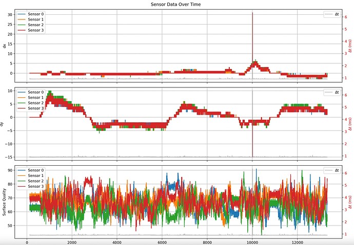

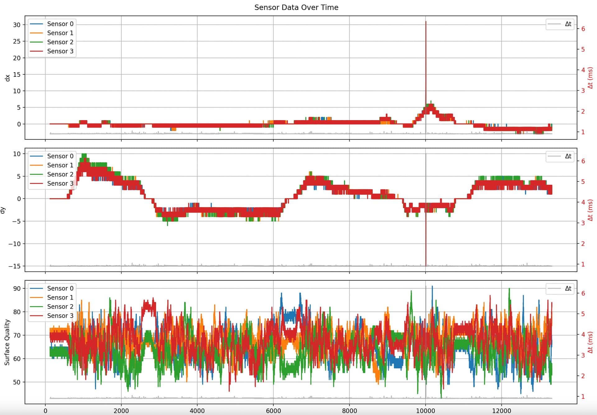

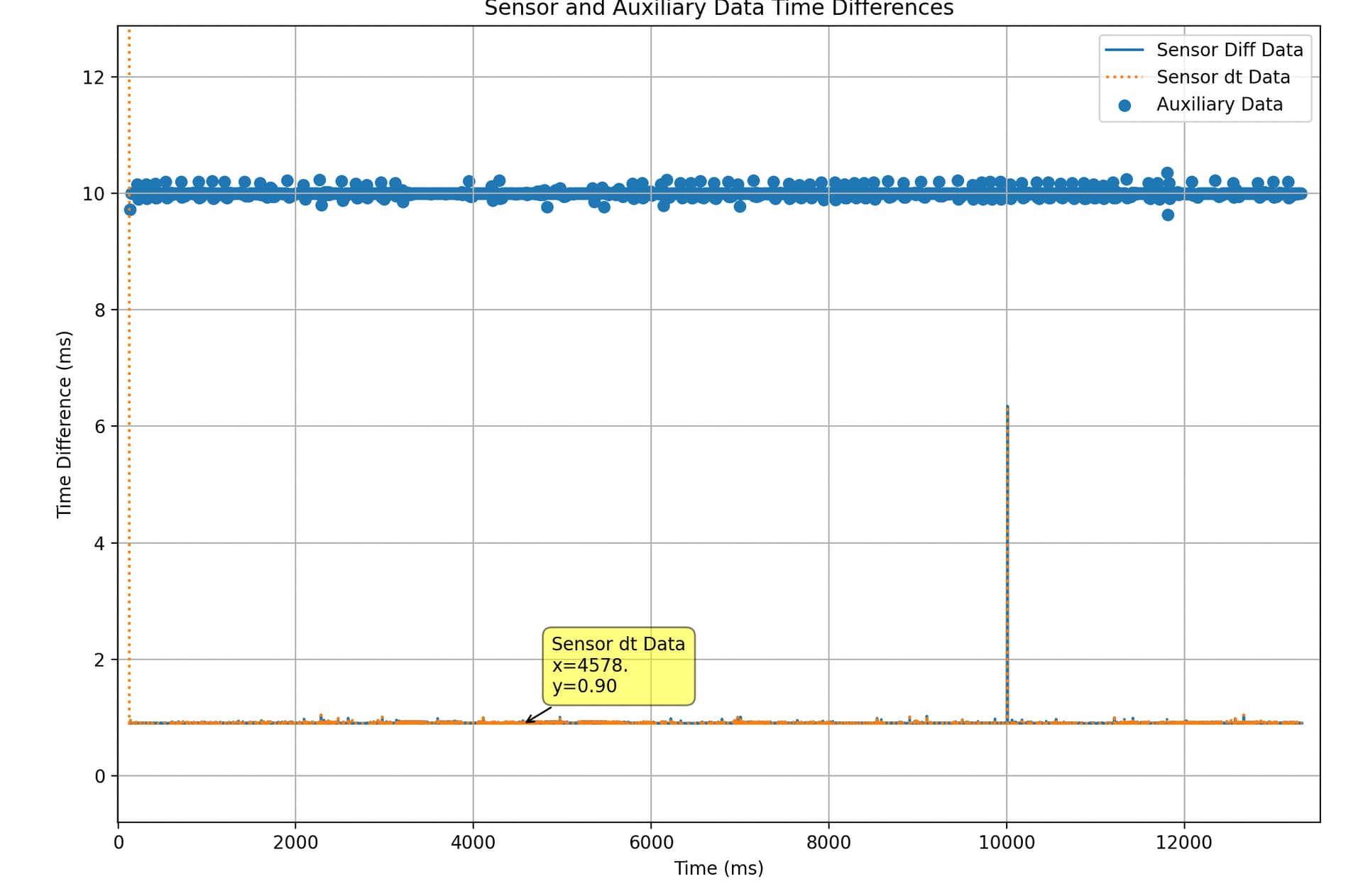

Got datalogging to a stable place. I was having a bunch of trouble decoding the binary data for a bit (no pun intended :p) before realizing that my firmware was automatically adding padding bytes to format the data when writing. Pretty easy fix after I realized what was happening. Anywho, getting some fun log visuals now:
