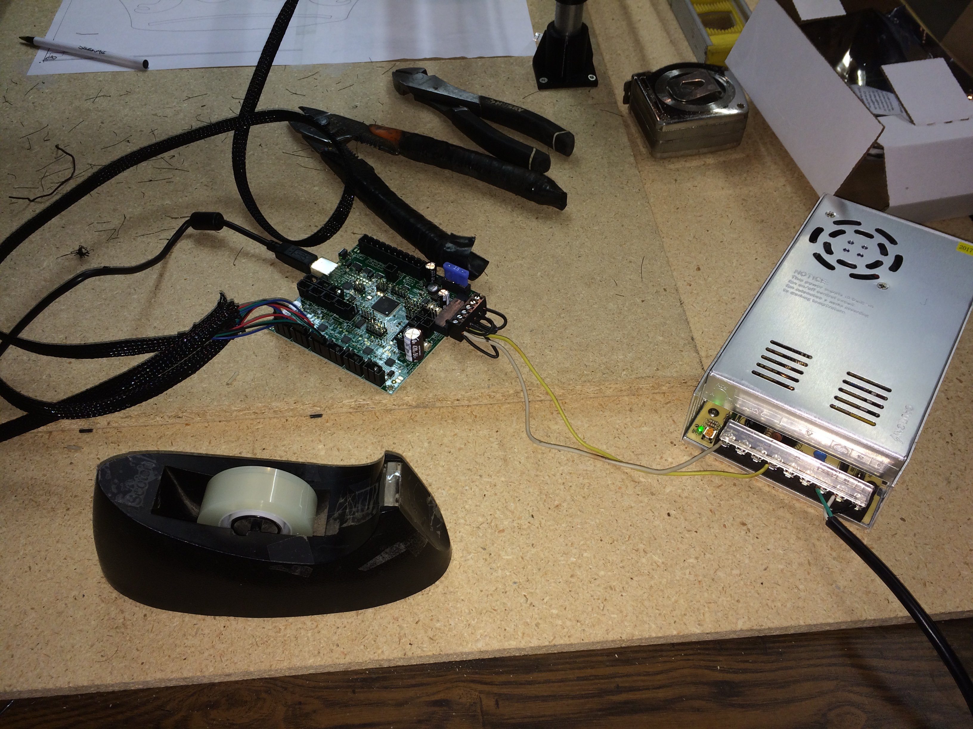

After about two weeks of waiting for parts to arrive and then getting everything together, my machine is finally done and moving. Hit a few snags along the way, mostly due to the printed parts having slightly smaller openings for the bolts and screws than necessary, but it did make the connections tighter.
I’m using my MacBook Air, Fusion 360 for my modeling/CAM and Repetier Host for sending the GCode to the full size RAMBo board. The post processor linked elsewhere on the website seems to work fine, see attached pictures of the crown drawing. I don’t think I got a good picture of it, but my first gcode was in inches instead of millimeters and it ended up drawing a small crown less than an inch square with much greater precision than I thought it would.
I am now trying to solve one last problem - when I try to set the home position and return to it (or when the gcode finishes and returns the pen to home position), my z-axis is trying to go beyond its zero position. Sometimes this happens with the x and y axes as well, so I have to hit the emergency stop in Repetier before the homing continues.

If you don’t have endstops, then you don’t home the machine.
When you power on the rambo, the origin is the location that the tool is at that moment. When setting up for a job, you’ll first move the tool to the origin you set in cam by: a) manually moving it if the steppers are disabled, b) jogging it with repetier or the LCD controller. The origin in your workpiece is determined by your CAM software, but it’s usually the lower left corner, on the surface of the work, or the dead center of your design, so you can center a design on an existing thing.
When you’ve moved to your new origin, you can set it by either: a) resetting the rambo, which is simple or b) sending a G92 X0 Y0 Z0. Some users have found that some history of the old origin are still present, but I haven’t tracked that down myself.
After all the moving around, if you want to go back to the origin, you can send G01 X0 Y0 Z0 F600. That won’t go back to the place where you started the machine, it will go back to the origin of the work (which probably isn’t a great idea, since the bit will be touching the work at that point.
If you want it to get out of the way and go back to the beginning location, then… Hmmm. IDK how to do that without endstops.
Thank you Jeff. The kit did come with the set of three mechanical end stops which may not be that hard to stick wherever I need to. I guess I will just delete the gcode that would try to home the machine and replace it with returning to the zero point (which I thought the homing already did, but now know that it goes to the origin and continues until it hits the end stops.
Without mounting the end stops, is replacing the gcode the only method to get the tool to return to a certain point after completing the job instead of homing?
I’m not sure why it’s homing. I use EstlCAM and it doesn’t home. There is a setting for where to end, and I choose to make it hover over the last coordinate, at the clearance plane so there’s no chance of it still cutting.
You could probably disable homing in the firmware.
If you replace the G28 and you want to go to the origin, don’t do Z0, choose something like Z3 and you’ll also want to go straight up first, then go home like:
G01 Z3 F300
G01 X0 Y0 F900
You can put appropriate speeds for z on there then.
Got it figured out. Switched post processors and made sure to send it to the origin when finished. I can edit from there but it will get interesting when I start using a router and the z distance has more variation than just 0 where the paper is and some arbitrary height for traveling above the paper.
