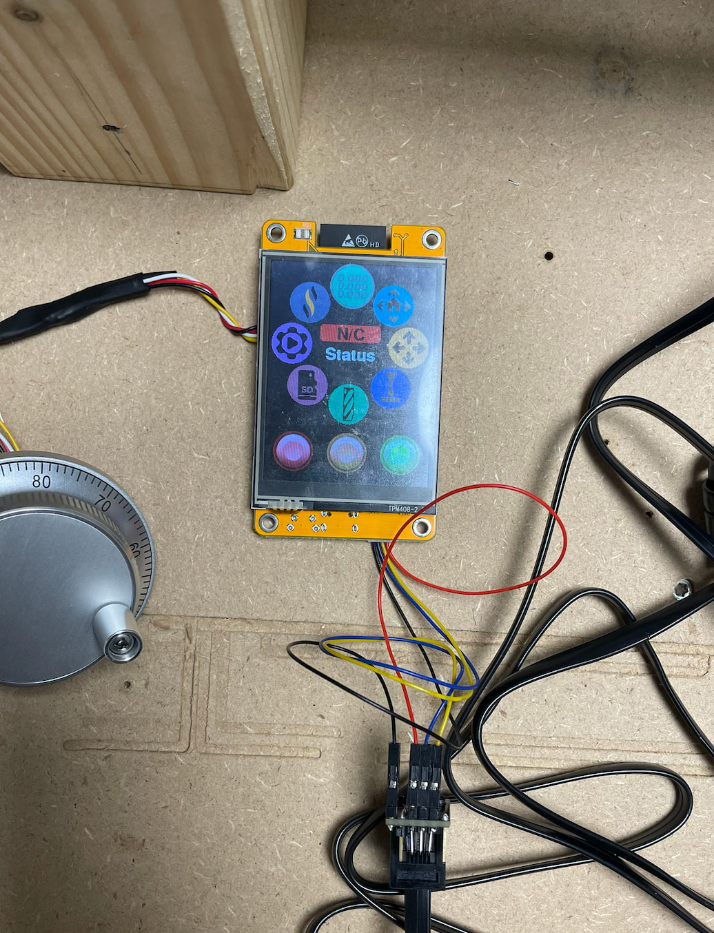

Dear Community,
I “inherited” a working LowRider as a form of uni project. I was able to figure out most problems by browsing the forums, but I am kinda at a dead end with the CYD.
The CYD powers up fine and the wheel does function to scroll through the menu. By the title you most likely can already guess that it does not connect to the Jackpot3 tho. I added the usual bits to the config, switched txd_pin and rxd_pin around in SW and HW - but no luck.
I tried the combination of Pins 13 & 14 first and then I switched to 12 & 15, which made no difference.

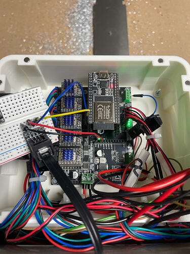

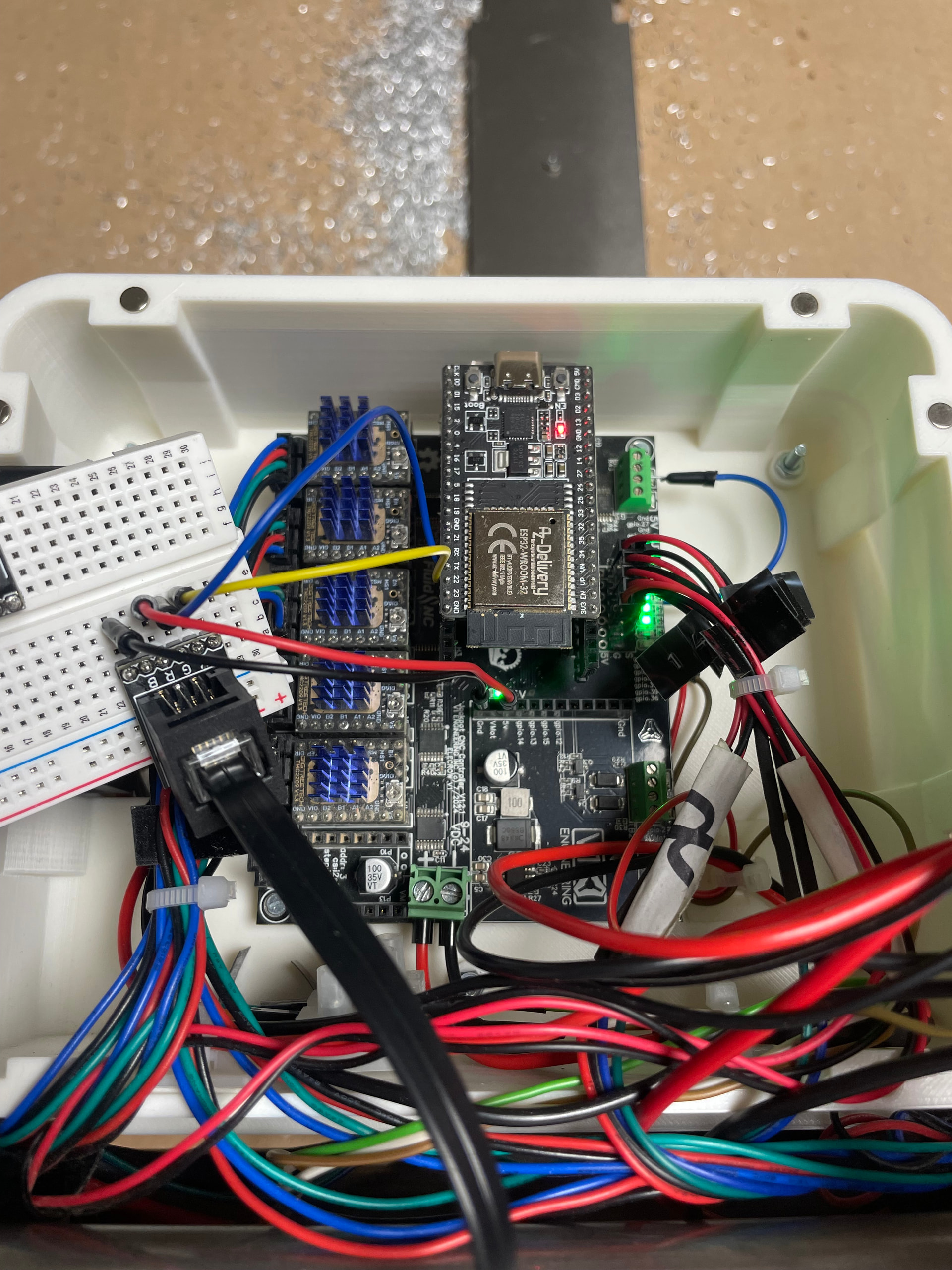

I tried to ditch the RJ12 Cable an hooked up the CYD via breadboard and jumper wires but also no luck. Display powers on as always, but no connection

I know not everyone is a fan of the CYD, but I hope you guys can help me get it going! Thanks in advance for every reply :slight_smile:

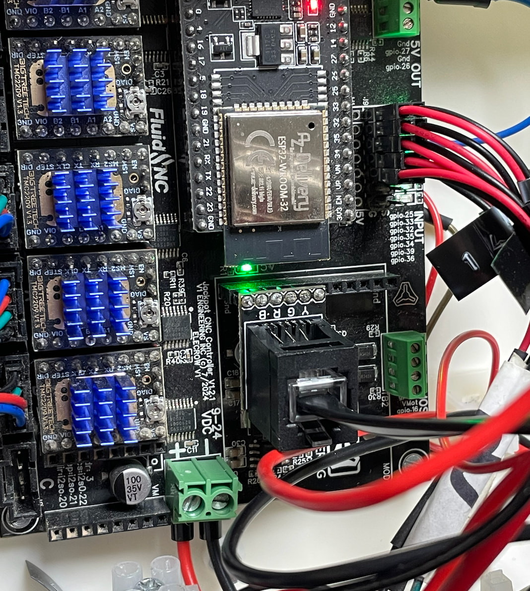

Welcome aboard Max. You have a Jackpot 1. I would update Fluidnc to at least 3.9.9. Then change the config.
The config settings for it are:
uart2:
  txd_pin: gpio.14
  rxd_pin: gpio.13
  rts_pin: NO_PIN
  cts_pin: NO_PIN
  baud: 1000000
  mode: 8N1
uart_channel2:
  uart_num: 2
  report_interval_ms: 75
After you make the changes power down and unplug the USB cable if you have one. The power back up and it should recognize the CYD.

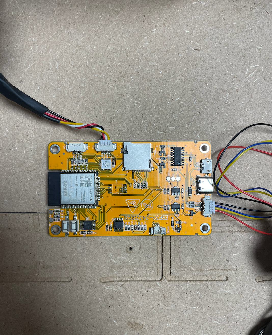

Sadly that did not do it for me. V3.9.9 is up and running. I again tried changing the gpio pins to 12 and 15 but no change. I degraded the CYD to an older firmware v1.2 instead of v1.3 but sadly also nothing
edit: I also switched the communication pins on the cyd and rebooted it several times
you have to use pins 13 & 14 on that jackpot. if they don’t work in one order, swap them in the config.yaml and load new file. triple check the tx/rx have actually been swapped.
Yes I did that. Used the pins 13/14 switched them in the config - upload - power off - nothing - again power off - switched the wires - reboot & still N/C on the CYD
Are you sure you unplugged the USB cable from the ESP32 after updating the firmware? If that’s running before the rest of the jackpot board is powered up, lots of stuff doesn’t load properly.
Yes of course. I did unplug it from its power supply, then plugged it into the laptop, did the firmware upgrade, unplugged it from usb to power it down and then I plugged the power supply back in
Is tx rx on the esp linked to gpio13/14 on the jackpot? I did something unorthodox to rule out that the mates before me blew the esp/jackpot.
That also didnt work
