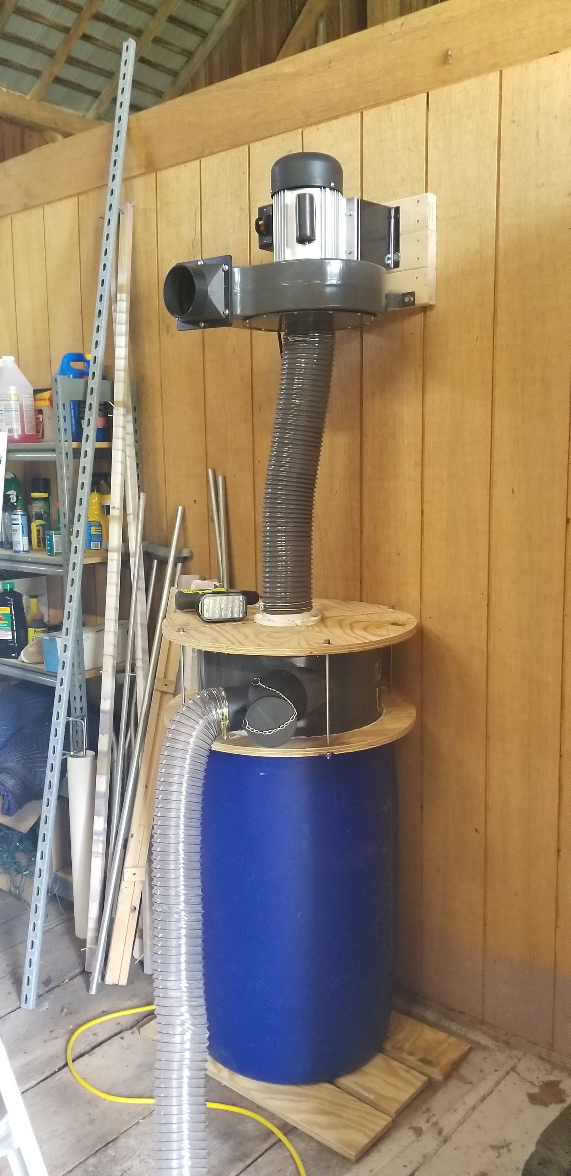

I have a plan to do something similar and get it wall mounted, but we are looking to move sometime in the next year or so, which is going to limit me on what I would like to do now. I am currently set up in my garage, and if I mount anything else, then I have to redo all of it again when we finally find house and move. So I get to wait, and then see what my new digs will let me do.
This is what I go so far…
used this kit from the amazons. $22-ish for that vs the $200-ish for a 4’ dust deputy…

Yea, the guy that bought our house really lucked out. We moved to an apartment, so the dust collection stayed in the barn.
