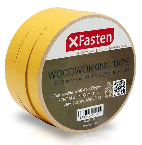

I’m having a lot of trouble securing my plywood sheets to my sacrificial plate. I often notice that the sheet is warped in certain areas, and as a result, even though the machine is fairly precise in the Z-axis, I end up with inconsistent engraving depths.
It seems to me that the simplest solution is to secure the sheet with a few screws.
The problem is placing the screws in the middle of the sheet.
What do you think of the following idea? Maybe one of you has already tried it and has some feedback on the subject?

Strong double-sided tape, or the blue-tape-plus-CA-glue method, may be strong enough to overcome some warp, depending on the thickness of the plywood.
I’ve been using this for years with my pattern routing. Used it to flatten a board with my LR4 last weekend and it didn’t move until I pried under it a bit. Just the right amount of hold without tearing wood fibers, and not thick like some others.
And much better and cost effective than the blue tape trick.
I just used screws, but in very deep countersunk holes.
Thanks to both of you for the tip about the double-sided tape. It does seem pretty simple that way. I’ll give it a try.
