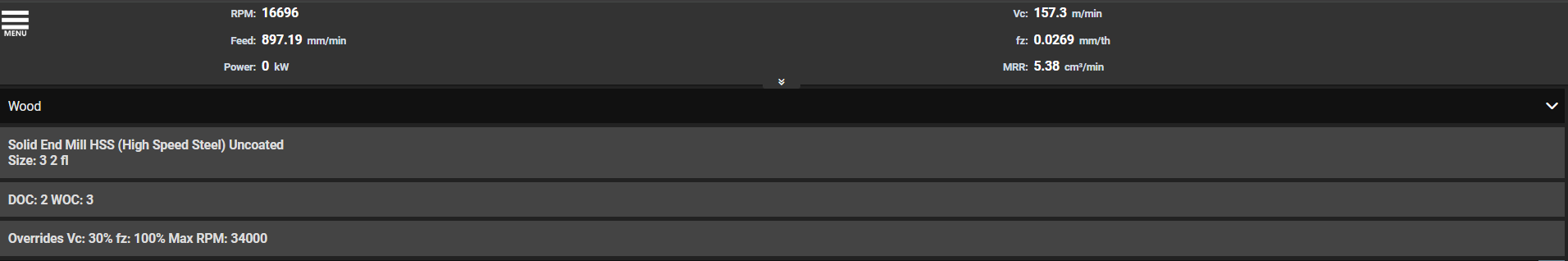

Hey,
I used the FSWizard to determine the feed rate and spindle speed.
I set the speed to 30% (FSWizard Override) so that the feed rate would be within the limits of the Lowrider 4.
Then I ran everything through Gemini again to verify.
It flagged the spindle speed as incorrect – according to Gemini, it should be between 7,500 and 10,000 rpm for a better chip load – I want to cut 6.5mm birch plywood.
So, which is correct: the values ​​from the FSWizard or Gemini’s suggestion? According to my research on the optimal chip load, Gemini is right, but even when I adjust the speed in the FSWizard, the chip load doesn’t change.
Did I configure something incorrectly in FSWizard?

Hey,
Thanks for your reply. I need to clarify: milling in plywood is working well now; I’ve already put 20 hours of milling into it with the LowRider.
My current concern is the tool life of the end mill.
The cut quality and the milling noise (not the spindle noise) are fine at both 10,000 and 18,000 RPM, at least in my opinion.
I’ve entered my 3mm end mill with two flutes into the FSWizard.
Everything seems to be correct in the FSWizard, except the chip load (mm/th) doesn’t quite match what I’ve determined, which would indicate insufficient cooling.
