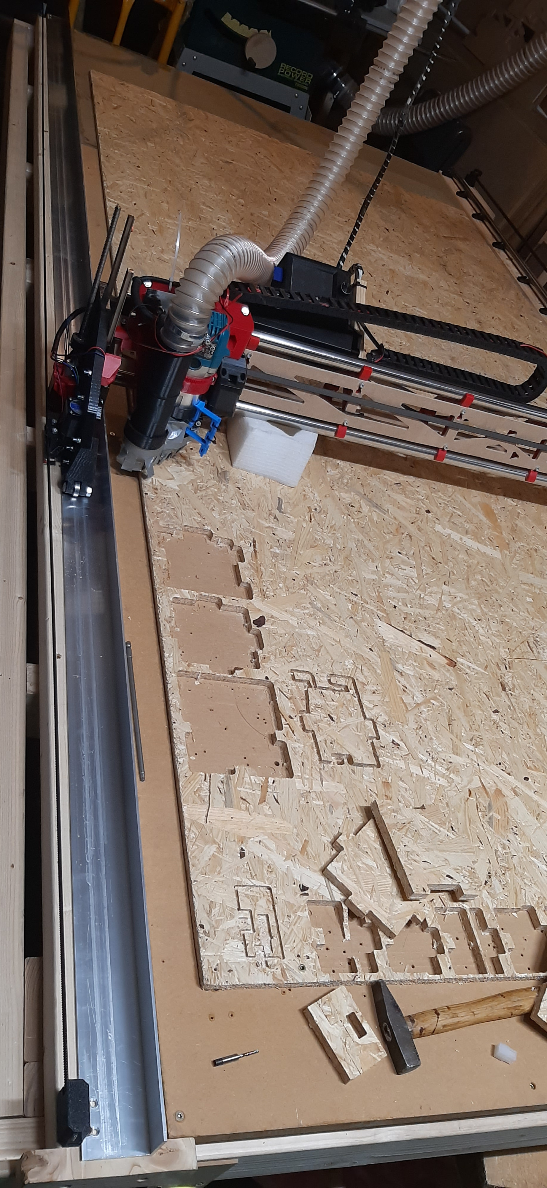

I tried cutting some stuff from OSB, as I’m preparing to cut Ryan’s table base + torsion box for when I will convert my LR3 into LR4.
I think I understand everything about feed rates, flutes and DOCs, but still things are going sideways! So irritating!
Eventually I used precisely settings (and bit, new!) from Ryan’s post here: Full size LowRider table base - #77 by vicious1 and it didn’t work too!

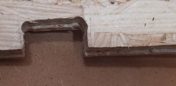

Makita was really struggling. Taking RPMs up did not help a lot and it lost steps at some point and I had to stop the job. Result below:

Please show us your
Picture of your build.
Feedrate, spindle rpm setting, depth of cut.

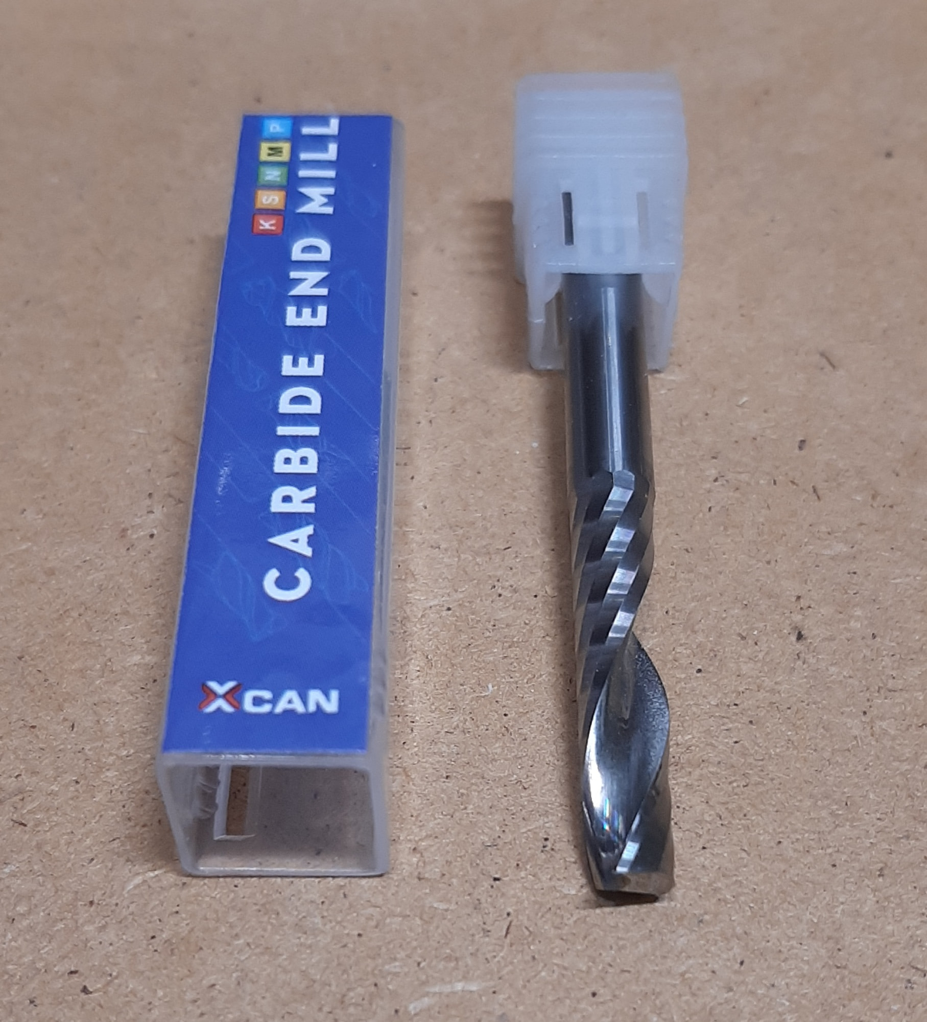

exactly what endmill are you using.
OSB splinters pretty easy (which can cause it to catch) and just like plywood, the glue is usually harder than the wood. So, a very sharp bit is usually recommended. Any time I have issues, it is always a dull bit.

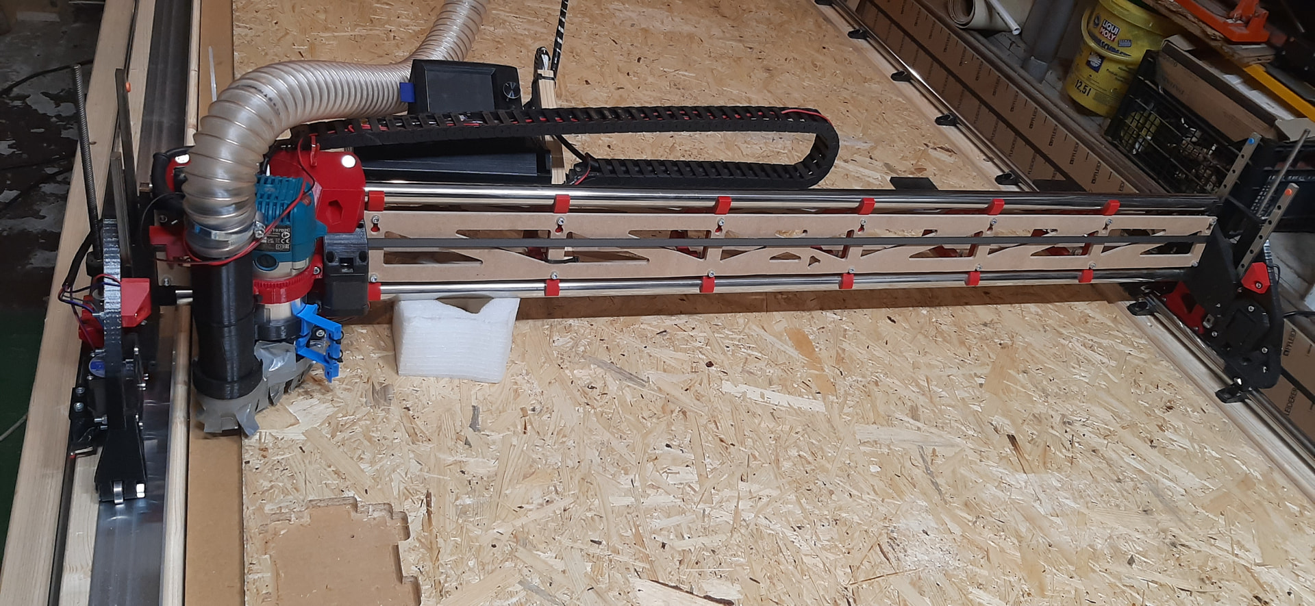

OK, here is my build:
I started 2 on Makita dial. Then I tried 3+ when things went south. 6mm single flute upcut.
1-What diameter is the endmill, 6mm? 2-How far out from the end of the collect does it stick out?
9mm/s feedrate @ 8mm DOC, ~2 on the makita dial rpm. I assume the finishing pass is something like 12mm @ 18mm/s, but 3- what is your finishing pass step-over? (sorry I have zero concept of 540mm in 60 seconds).
One issue with your build is you absolutely need to secure the vac hose to the top of your core, 100%. Not doing this is going to jack up your accuracy in every direction. Slap a zip tie on it.
Your numbers should be simple for the machine to do. So either that endmill is garbage, or the vac hose is pulling harder than you think.

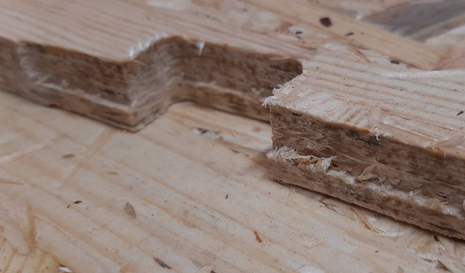

I will try to use new bit from another factory, and connect my pipe to the core and go down to 6mm DOC as Toko suggest. I will keep you posted.

A two flute down cut is extremely slow as compared to a single flute upcut. downcuts pack the material down into the cut, and a two flute has very little room for chips. Single upcut can hog material out and throws it up and out of the way.
A single flute with a finishing pass should get you the same edge quality faster.
agreed i did try that but some of the ply we get is just rubbish
even with finish pass of .5mm would blow out top edge , this way i know I’m not getting damaged edges
