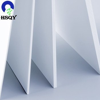

What would you sue to cut modelling board (apart of laser)?
I have a drag knife, but i don’t think it can cut deep enough for 5mm modelling board?
Thanks!
2mm downcut endmill should cut balsa fairly well.
Could you clarify what you mean by modeling board? Because to me that’s a polyurethane product
Yes, the kind of modelling board i have to cut is made from high density foam, with polyurethane coating on both sides, like the one in the picture
Single flute endmill will still cut that stuff fairly well. Holding it down will be a challenge though.
