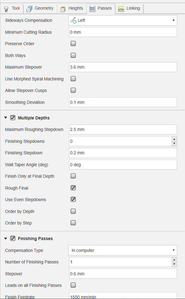

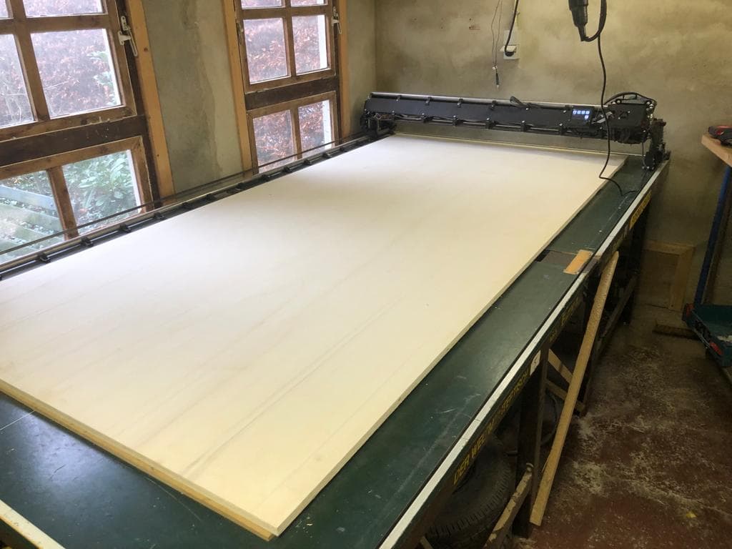

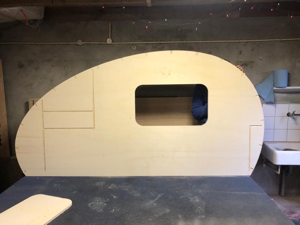

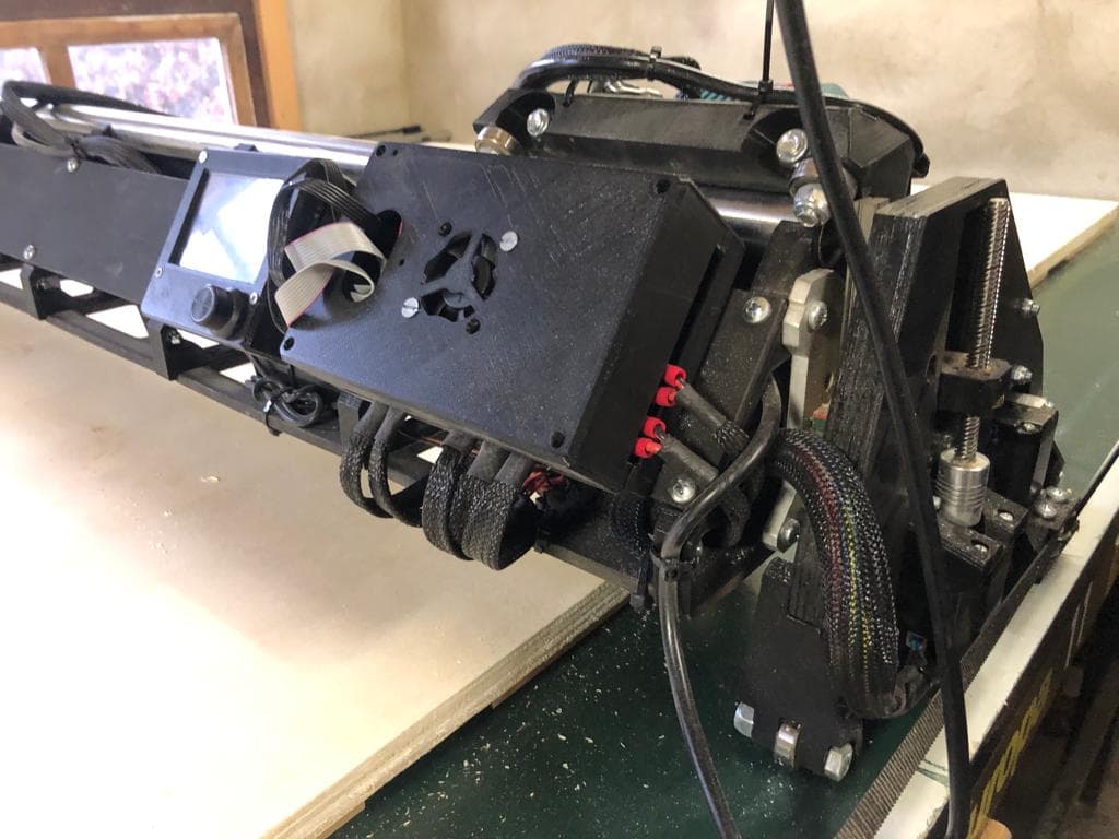

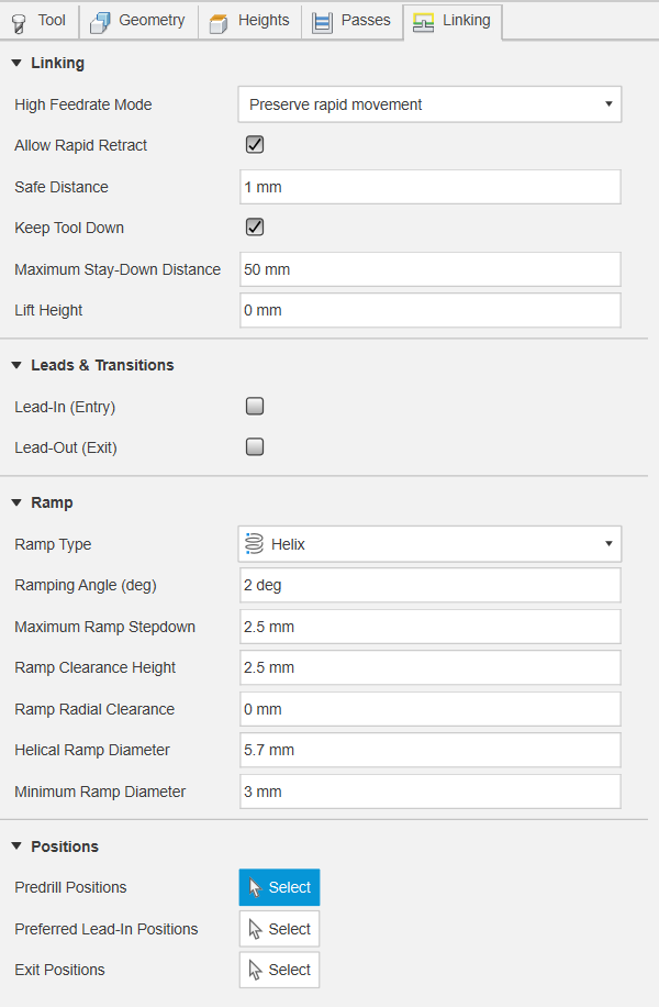

Hi, i’ve been troubleshooting my LR3 the last couple of days. I have had it for a while now and it used to function nicely. It had to be stored a way for a little and it moved to a new shop. It is a full sheet build. I recently surfaced the table and moving the cnc over it is completely flat.

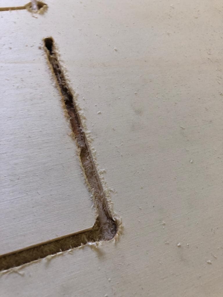

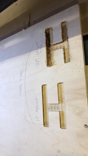

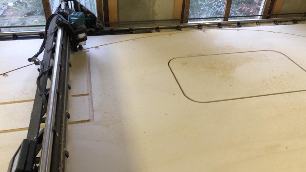

However, during cuting the bit seems to go in deeper then i define it in cam. For example: i define a cut to be 5mm deep and take steps of 2.5mm (in fusion360). simulation looks good so i put it on the machine. It then just cuts 6mm deep at some parts. I zero with a touch plate.
Troubleshooting already done:
flat table / surfaced
tightened all? screws and grub screws also with loctite.
core was a bit loose so i tightened that.
tightened all the belts
squared the machine
increased the stepper current from 900 to 1400 for the z, made the steppers a little too hot for my iking so i decreased the current to 1100.
z screw is lubed and doesn’t seem to bind anywhere, however, depending on the position of the core on the x axis the beam does not always drop when turning the machine off.
I’m starting to get frustrated by this problem, mostly since it used to work really well. I used to be able to cut through solid white oak with a 6mm bit at 5mm doc and 1500mm/s no problem. But now it is strugling with soft poplar plywood… any help is welcome!
oh before i forget, moving it with no load it is very accurate in all directions. When cutting parts the tend to be 1mm oversized or undersized so 120mm part comes out 121 or 120.5

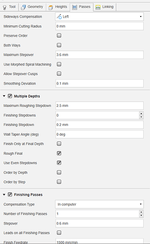

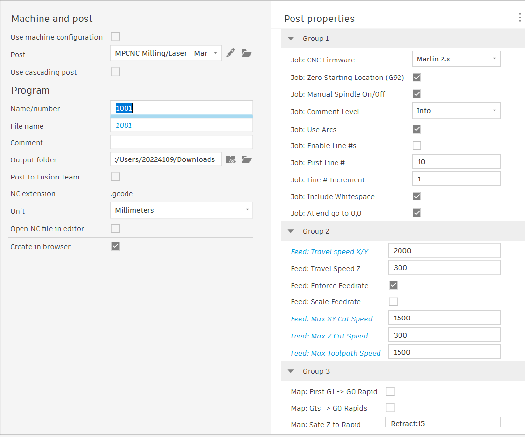

I was viewing my gcode in ncviewer to check, i couldn’t find any reason for the error. This is the first section of gcode of this job. Is there a clear mistake that im looking over?

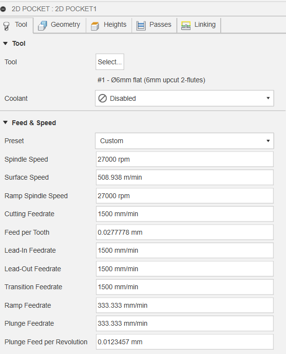

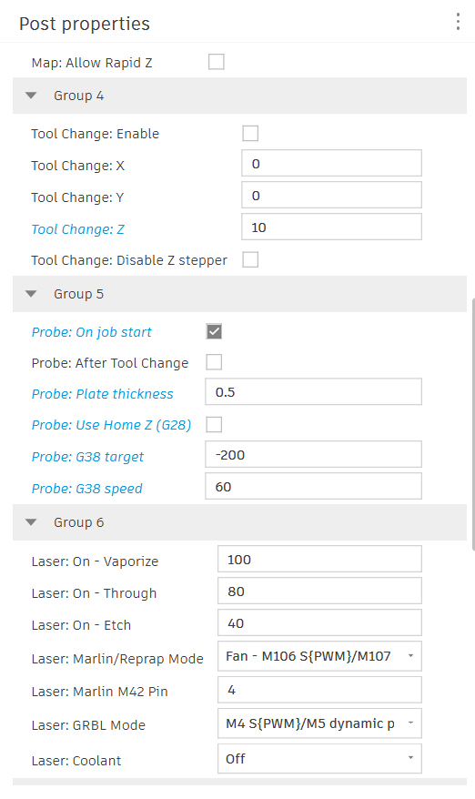

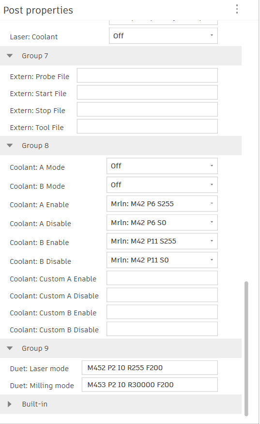

;Fusion 360 CAM 2.0.17954
; Posts processor: MPCNC.cps
; Gcode generated: Tuesday, December 26, 2023 8:58:14 AM GMT
; Document: TEARDROP v16
; Setup: Setup3
; Ranges Table:
; X: Min=-1 Max=1038.5 Size=1039.5
; Y: Min=-1 Max=2138.36 Size=2139.36
; Z: Min=-8 Max=15 Size=23
; Tools Table:
; T1 D=6 CR=0 - ZMIN=-4.5 - flat end mill
; T2 D=4 CR=0 - ZMIN=-8 - flat end mill
; Feedrate and Scaling Properties:
; Feed: Travel speed X/Y = 2000
; Feed: Travel Speed Z = 300
; Feed: Enforce Feedrate = true
; Feed: Scale Feedrate = false
; Feed: Max XY Cut Speed = 1500
; Feed: Max Z Cut Speed = 300
; Feed: Max Toolpath Speed = 1500
; G1->G0 Mapping Properties:
; Map: First G1 -> G0 Rapid = false
; Map: G1s -> G0 Rapids = false
; Map: SafeZ Mode = Retract : default = 15
; Map: Allow Rapid Z = false
; *** START begin ***
; Set Absolute Positioning
; Units = mm
; Disable stepper timeout
; Set current position to 0,0,0
G90
G21
M84 S0
G92 X0 Y0 Z0
; COMMAND_TOOL_MEASURE
; Probe to Zero Z
; Ask User to Attach the Z Probe
; Do Probing
; Set Z to probe thickness: Z0.5
; Retract the tool to 10
; Ask User to Remove the Z Probe
M0 Attach ZProbe
G38.3 F60 Z-200
G92 Z0.5
G0 Z10 F300
M400
M0 Detach ZProbe
; *** START end ***

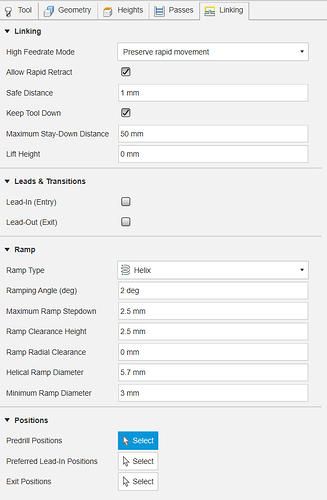

; MOVEMENT_PLUNGE
G1 Z2.5 F333
; MOVEMENT_RAMP_HELIX
G1 X471.807 Y2129.145 Z2.496 F333

And these are my post processor settings in fusion, maybe there is a mistake in here? I’m starting to look more at the software side, because i can’t find any clear errors in my build after checking everything that was the problem in some of the other topics related to this issue.
And these are some screenshots of the first toolpath that goes wrong.
This is the build currently
This is where the cut goes wrong, as you can see it goes way deeper then 2.5mm and the bit gets to hot because of that.
And here is a video of it cutting different plywood, it had the issue of cutting to deep a little less but it was still present, the core was slightly loose during this cut which caused some dimensions to be slightly of, tightning it solved this issue.
video of test cut

Looking at your gcode you did not show enough to know for sure. Everything looks good but you stopped while it was still plunging.
Is your CAM set to the work surface is =0 or is your table=0? You have probed the surface fine, I suspect you are using the table as a reference and not the work surface.
Unfortunately, fusion is hard to trouble shoot with all those lists of setting and the ones that I am asking about are not represented in those lists. I highly recommend learning with ESTlcam.

And that depth of cut should be fine, I think your RPM might be way too high. Hard to say, that video shows your federate to be really fast, but it also sounds like your RPM is really high.
I couldnt’t put more gcode in, but z went down to -2.5 and then started cutting. It could be that i set the stock to 0 but i dont think so since the material is 18mm thick so it would have to cut way deeper. I have done around 50 jobs with fusion without many issues so i dont plan to switch to estlecam.
I agree that the rpm was too high, now that you mention it i remember why i did. The cutting went decently well in i think the y direction at lower rpm. But in x direction it had difficulty at lower rpm so i increased it. Does this have to do with my issue?

Bartman
December 27, 2023, 7:18pm
12
I’m taking a guess here, but that probably refers to the lowest that the Z axis goes in the entire gcode file. That section is I believe an overview or summary of the entire file. So if I had to guess, I would think that Tool #1 has a maximum depth (Z Min) of -4.5 mm, and Tool #2 has a maximum depth of -8mm during the entire toolpath.
Perhaps you have set up a rough pass of 4.5 using Tool #1 , and a finish pass of 8 using Tool #2 ?
Note also that you have Stepdown at 2.5, but that isn’t Depth of Cut (DOC). In other words, the gcode should take multiple passes at a maximum of 2.5 until it reaches the final DOC. Without seeing the entire gcode and all of the settings screens, it is hard to know whether this is indeed how it has been configured and if the CAM is outputting this properly
If it is cutting at 6mm on the initial pass instead of 2.5 mm (which is what you seem to be saying in your OP), then it seems to me (off the top of my head) there are two possibilities:
The Z axis is moving 6 mm instead of 2.5 mm on the initial pass. If it moves 2.5mm on a manual command of 2.5 mm, then the problem is probably in your gcode (try another CAM program, or double check your programming entries). If it moves 6 mm on a 2.5 mm manual command, then something is seriously messed up in your machine.
The Z axis is moving 2.5 mm on the initial pass, but for some reason the bit is moving 6 mm. This could indicate things like loose collet (bit slipping and pulling out of the collet), cracked core, loose core rollers, loose grub screws, skipping steps (in the upward direction?), loose router mounting, or some other mechanical issue.
Third possibility, which I see you have identified, is that the material is not flat, so it cuts 2.5 mm in some places but 6 mm in others. Try screwing the material to the spoil board at the high spots in case it is bowed rather than uneven thickness (make sure the screws aren’t in the toolpath)
The issue in the end was a very warped sheet of plywood… sometimes you forget to check the simple things.
I did also have an issue with my bits getting way too hot very fast and thus becoming dull. I have always used a 2 flute upcut bit so far. These don’t work for poplar plywood at all. even at low rpm it could not get rit of its heat, i used brand new hss bits. I think this is mostly since poplar ply is very lightweight. Thus it is harder for the bit to get rid of heat? The upcut also splintered a ton.
So i tried a straight cut bit, worked like a treat. Could use much lower rpm and it did not get hot. I used a two flute bit but i assume one flut would be even better. you can see the difference in the image below. The deviation in z is not because the router is not tram. The bit i used dents inwards on the bottem which leaves the little marks on the bottom.
The first section of my project cut out below. First part of many. Used an 6mm 2 flute straight cut bit. 5mm doc. 8mm/s in xy and 3mm/s in z. speed dial 3.5 on the katsu router. took 1 hour 40 minutes to machine, speeds could have been higher but this worked well.
