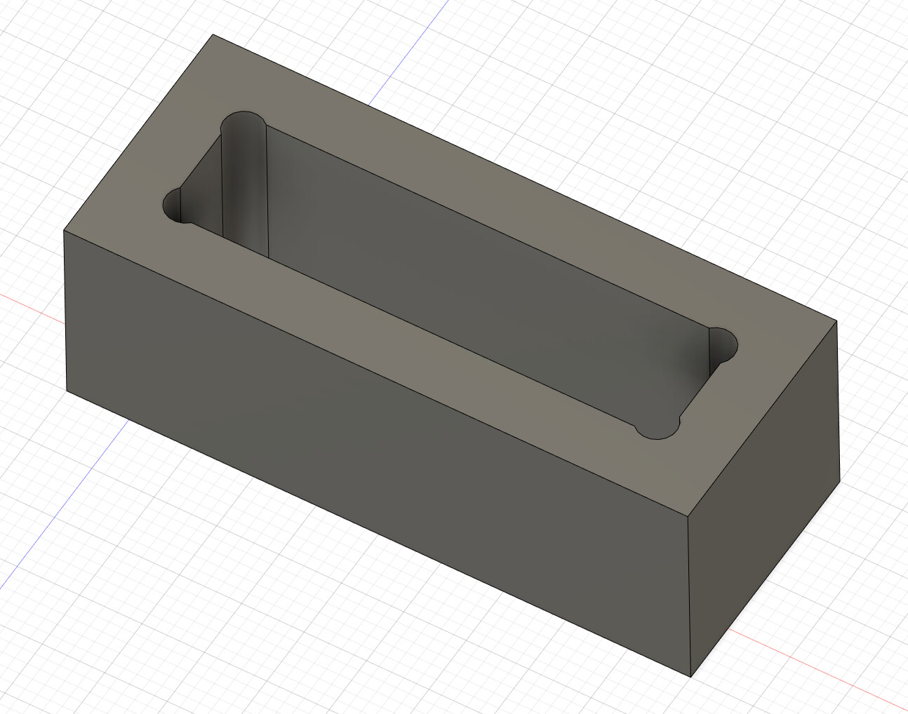

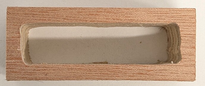

I have an issue with cutting corner overcuts. I have attached a picture of the design and then what I get. The dimensions are a little out, but the bigger issue is the internal path where the overcuts are is all over the place.

That looks like you have some machine movement. Something is flexing in ways it should not.
Sometimes cutting too deep makes this worse. I keep seeing advise limiting DOC to the tool diameter, but have also seen people succeed going much deeper.
On the LowRider, ensure that all of the core bearings are touching the X rails. With the router off, push and pull the endmill along the Y axis. If you hear bearings “click” against the rails, they are loose, and you need to tighten them until they are all just in contact. (No pressure, just contact.)
Check that the YZ plates are not rocking when you cut. These should stay level. A misalignment at the rail end can cause the whole machine to rock. Press down at the front and back of the YZ plate on both ends. None of these should move (and again, a telltale “click” tells of a problem.)
Your speeds are similar to mine, though you cut a bit deeper. (I cut 3.5mm deep.) I do not have this problem with my LR3.

What I have tried just now is making my corner overcuts slightly larger, which means I can turn on a 0.5mm finishing pass - this is way better result dimensionally - so I am going to stick with this approach.
Maybe I was just asking too much of my machine without a finishing pass ?

The machine core could be loose bearings holding it to the gantry. It could be belt slop/backlash. It could be grub screws. (Important! It js possible to lock-tite the grub screws so that they are not centered on the flats of the motor. This results in grub screws that check out like they are tight, but allow the motor shaft to turn between one edge of the flat spot and the other. This can result in acting exactly like backlash, and not allow the axis to wander totally at random. This can be anywhere up to a couple of mm.)

On the LR, try to push/pull the router collet towards and away from the X rails. If you hear a clicking noise, you need to adjust it. If you can feel it move, you really need to adjust it.
Check that the belts are tight enough. They should vibrate when you pluck them, like a guitar string. It doesn’t need to make a sound, really, but they shouldn’t just sit there.
Overtightening the tool mojnt can cause the LR3 core to crack. The M5 screws that hkmd the tool in can exert a lot more force than the holder needs, and can crack the printed plastic core very easily. Plenty of people have done that. This will cause some unwanted movement at the tool end, too.
As a followup to this. What I had not realised was that my Y belts were gradually disappearing into the front end-blocks hence was gradually losing tension. Things are looking better now, hopefully was the root cause.
