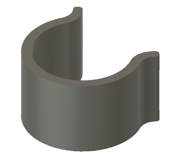

Recently I made a change to approach this problem differently. I drilled out the base board under the legs so that the leg tubes extend through the bottom of the legs, through the base board, and even through the table below. I then 3D printed some spacers that clip on the legs. The plan is to have different height spacers for the different positions I want for the legs. I can loosen the screws holding the legs, remove the four spacers, adjust the height of the table to another set of spacers, and tighten the bolts in the legs. The spacer remain so that if the screws become loose, the legs won’t drop. This is a work in progress. So far, I’ve just used it at its lowest position, so I cannot report how well it works moving between different positions. This is the spacer
