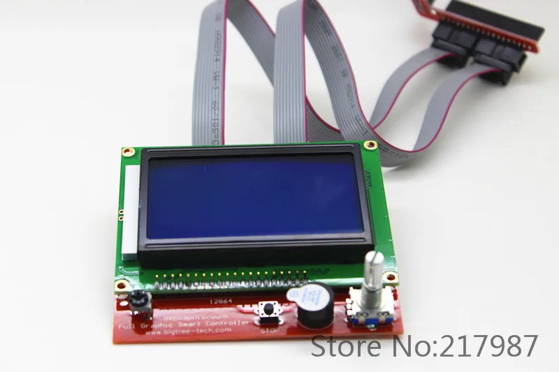

Hi Karl (hey, I’m Karl too!)
I am in the process of upgrading my MPCNC and would like to try your mods. What LCD are you using, the 2004, or the full graphic? Or something else?
Thanks!
The other Karl
Good point!
It’s the 12864 with ramps adapter pcb!

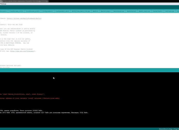

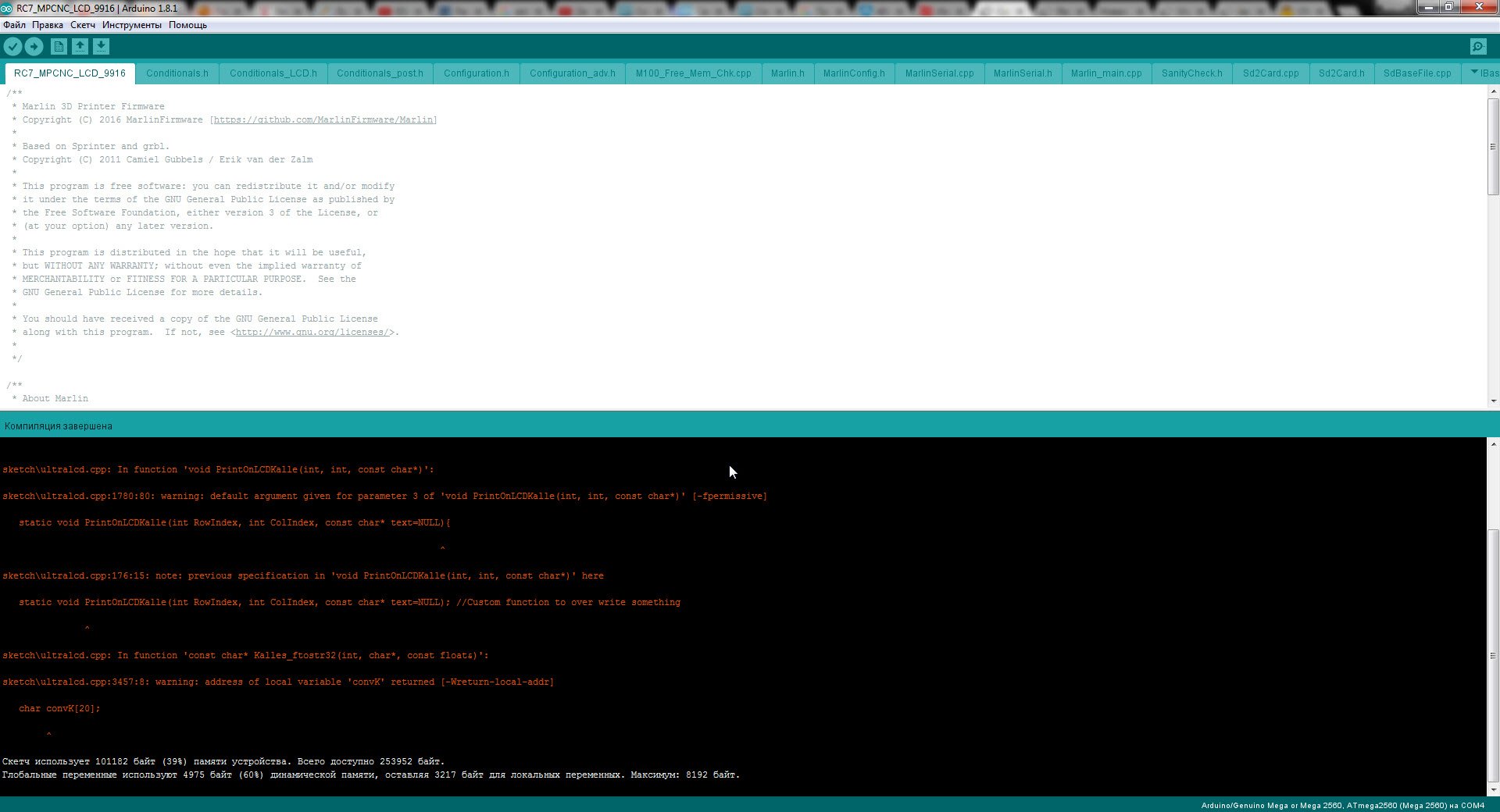

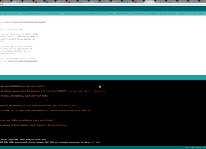

Karl, hello!
I try to load your modified files with RC7 and see this errors in a arduino ide 1.8.1
sketch\ultralcd.cpp: In function ‘void PrintOnLCDKalle(int, int, const char*)’:
sketch\ultralcd.cpp:1780:80: warning: default argument given for parameter 3 of ‘void PrintOnLCDKalle(int, int, const char*)’ [-fpermissive]
static void PrintOnLCDKalle(int RowIndex, int ColIndex, const char* text=NULL){
sketch\ultralcd.cpp:176:15: note: previous specification in ‘void PrintOnLCDKalle(int, int, const char*)’ here
static void PrintOnLCDKalle(int RowIndex, int ColIndex, const char* text=NULL); //Custom function to over write something
sketch\ultralcd.cpp: In function ‘const char* Kalles_ftostr32(int, char*, const float&)’:
sketch\ultralcd.cpp:3457:8: warning: address of local variable ‘convK’ returned [-Wreturn-local-addr]
char convK[20];
    ^</em>
But i can load it in a MKSGen 1.3.
Then when i try from LCD same as your press to go to home, move only Z axis in uppen about 50 mm and down without triggered z mix endstop. X and Y not move anyway.
What wrong i do?

I think I have found and corrected the errors (the compiler errors at least)
First error: defined “const char* text=NULL” twice
Second error: gave the address to a local variable (now global)
EDIT: I see now that I dont even use the function “Kalles_ftostr32” anymore… so if that is still causing you problems, try removing it!

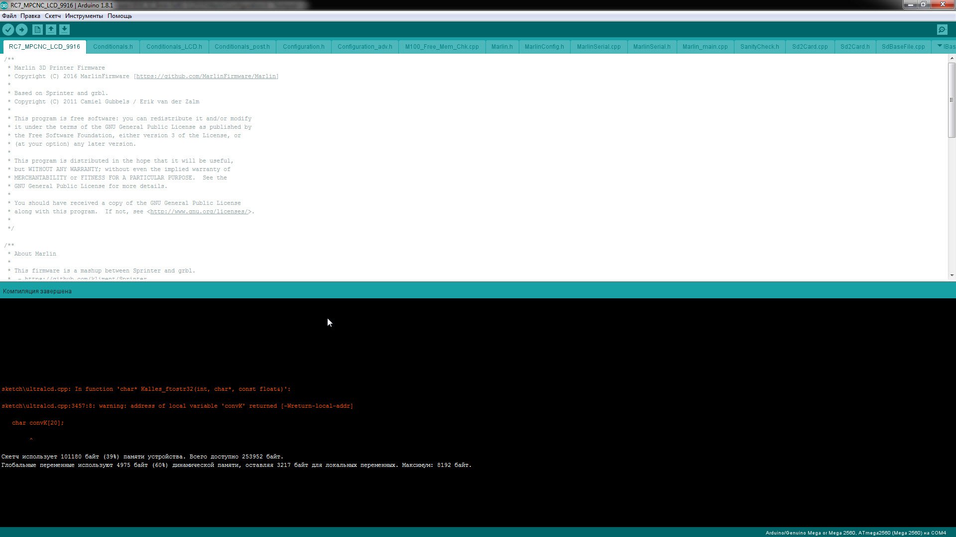

Karl,
unfortunately still error after update ultra lcd.cpp (
UPDATE
I think I answer myself, look like problem with AIDE. After reload app and re-check firmware no more errors.
I see that it’s only the unused function that it complaints about now… New version is up on github without that function!
Give it a try!
Are you sure you got the latest version? The one i linked to did not have a local variable…
OOps, I see now that it had… :wink:

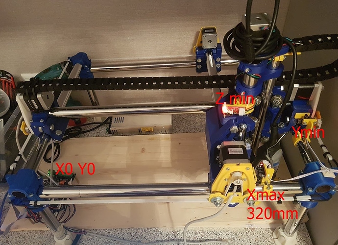

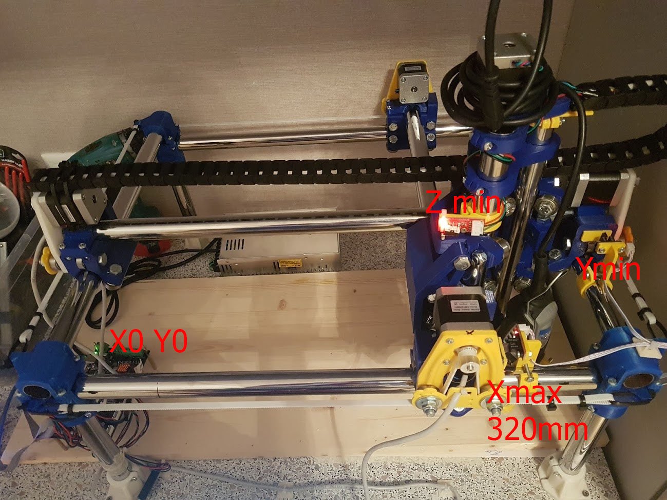

Maybe someone can help me undesterd work correct configurated endstop in my config of MPCNC?
Now it look like in pic.
My conf
x max - 320 mm
y max- 220 mm
z max - 150 mm
Endstops
x max
y min
z min
When i send command to rep. host g28 mpcnc go to x320 y0 z 0, after than i send g1 x0 f 3000 and its go to position x0 y0 z0.
How config it to go after g28 in X0 not x320?
And second big question how configurat z hight if i use z min endstop, and when press z+ in rep.host z axis go up butmaterial is lower z0
