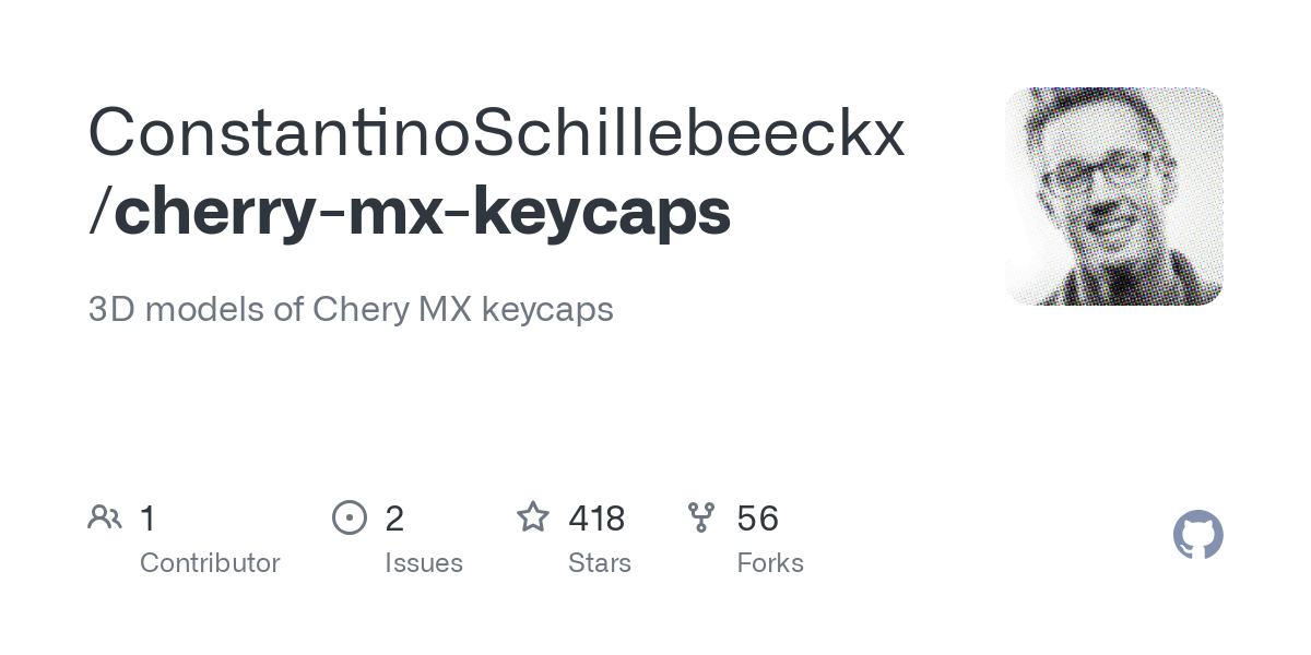

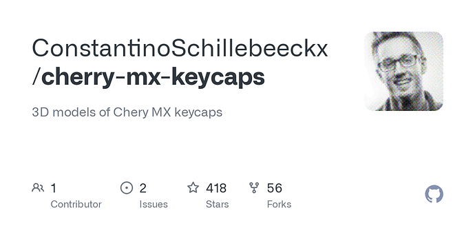

Thanks for the info. Where did you find the CAD for the profiles?
This one I modelled myself quite a while ago, from some other reference I don’t recall.
Geekhack has a a repo that contains PDF’s with measurements for all rows and profiles, here: GitHub - mohitg11/GH-CAD-Resources
Also, there are multiple repos with cad files already made, I just downloaded from the one I linked at the start of the post (because that’s where my phone is placing them when I paste and I’m going to mess it up copying it by hand) to have at least a full profile around, but I haven’t chosen a profile for my own keyboard so I didn’t do anything with them yet.
