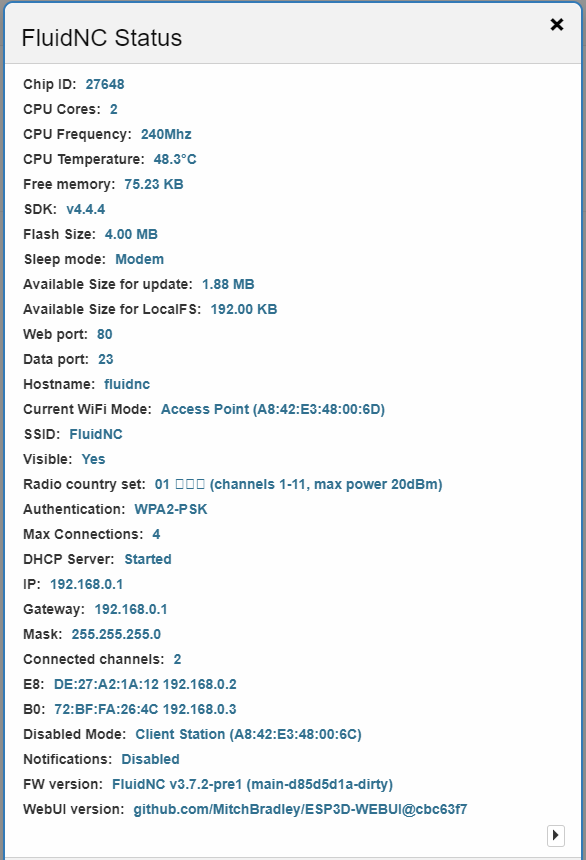

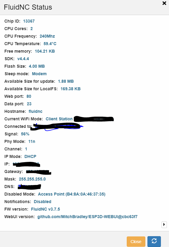

got it. @jamiek What were you doing when the memory nulled out? Unfortunately i do not have anything connected to my esp32, but no matter what i do, connected to my ap and from my desktop, i am not getting it to fail. I am doing anything I can at the moment.
I can’t get it to fail now, even though I don’t think I’m doing anything different.
I was having more trouble when I was on my home wifi network. Now I’m on AP mode.
Even if I set auto reporting to 50 ms, still no failures.
Here’s mine:
I have some tweaks in the code to raise a warning if polling channels takes a long time.
What? I just realized I’m running 3.7.2?! Maybe that’s part of the problem!
