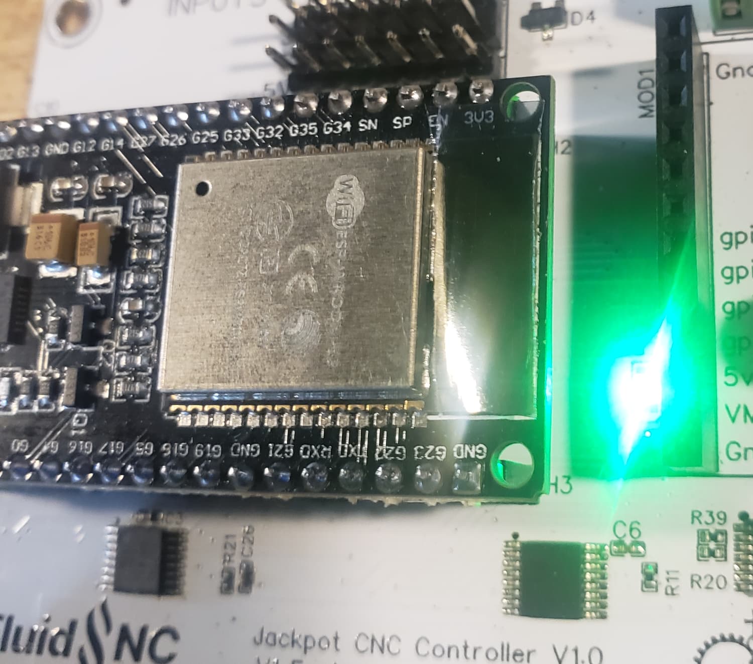

Yes, the PCB antenna is not always tuned to the right frequency and can have a weak signal even when located right next to the access point. By placing your thumb on the antenna you can easily offset the tuned frequency of an antenna. My esp32 has difficulty connecting to an ap but when I place my thumb on the antenna it connects right away, also the ping responses are much faster and more consistent.
Another way to offset the frequency is to place a thin strip of mylar on the antenna, such as from the mylar bag the esp32 was packaged in. With this small strip of mylar in place this esp32 easily connects to the network and doesn’t have any more issues communicating with the ap.
Is there an inexpensive tool to test the frequency or do you just watch the power with a wifi tool?
This could be a reason to use the $10 official espressif esp32 instead of the imports.

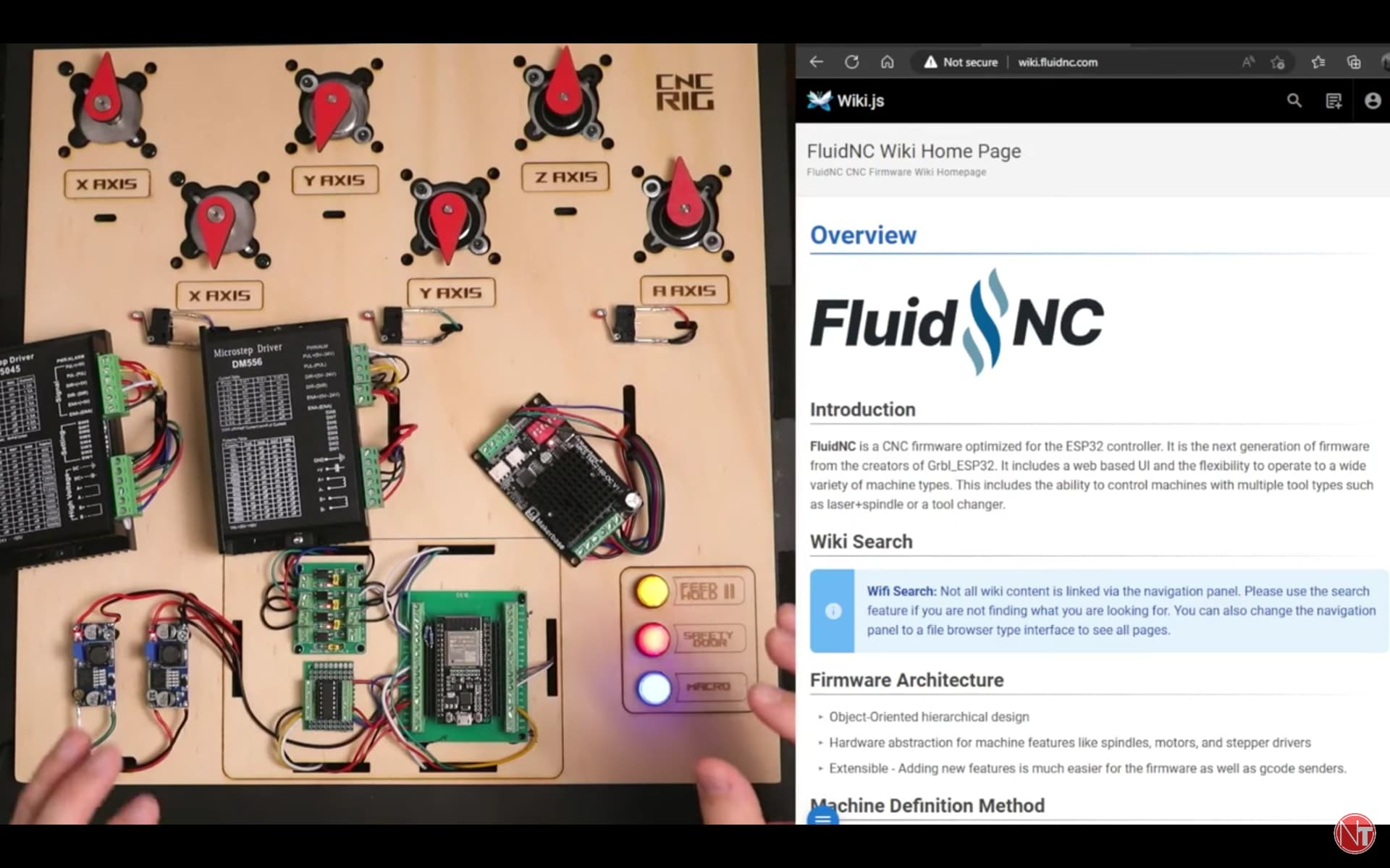

So my mind has a little different obviously because steppers are mounted but channels cnc’d for wiring and labels lasered, just something kinda neat.
But here is his:
Wifi and Bluetooth | Wiki.js if you set static mode maybe that helps? The warnings on this page are all against AP mode.

Whatever you do, do not use those drivers. minimum is 2.3A. He says he has had no problem with that but that can’t be correct. if we turned the 2209’s up to 2.3 A we would melt right out of the stepper mounts and probably melt a stepper. We use 0.6 to 0.8A still silent, much cheaper and ultra fine current control. Those as 2.33A next step up is 2.57A. But that can not be right if it did not melt his prints. Something fishy about that whole setup…oddly he has wifi issues as well. He also is not using auto squaring in the firmware.
Gosh, I guess LR3 Pro needs Alu stepper mounts?
