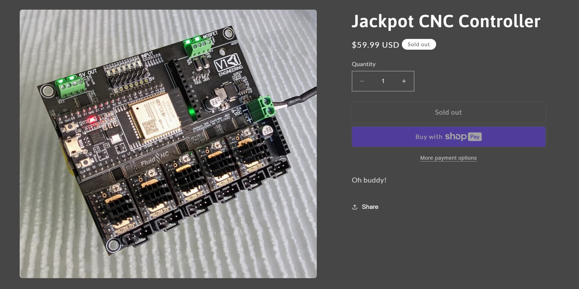

Store link works, but inventory is sold out. Damn scalping bots got there first I guess.

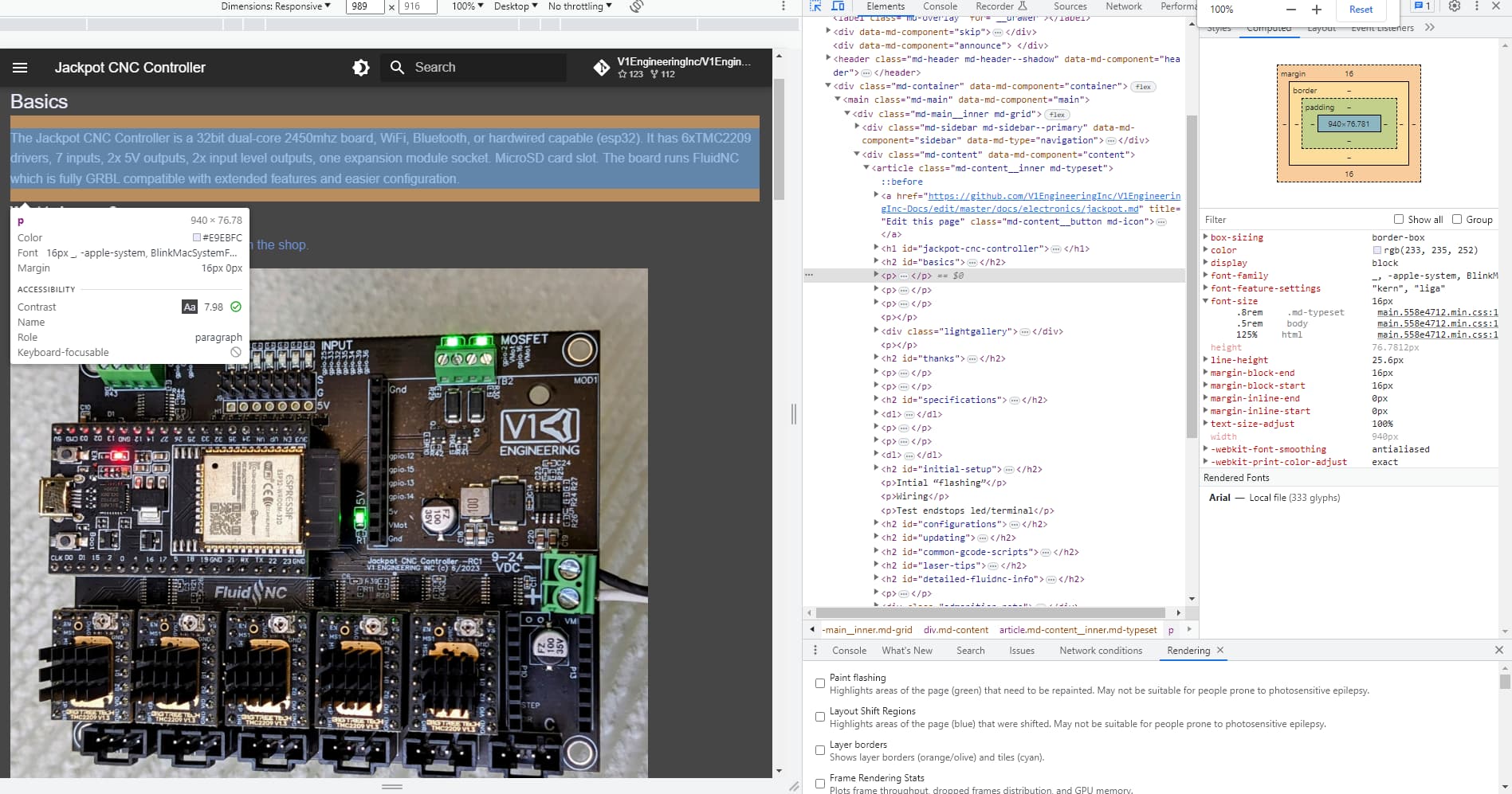

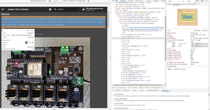

I can’t figure out why the font is so big in the docs.
All the docs, or just JackPot page?
Here’s what I see (Chrome, with Dev Tools enabled, press F12) …
What’s your reference, ideal style you’re looking for?
Of course… I’ve been watching this thread and refreshing the store for the last 2 days and I still miss it lol
I will not be adding any inventory until maybe this evening or tomorrow evening. And I only have two. I still want to run one more test.
All, turns out it dynamically resizes. So if I set the max width correctly, it will look right. I am running some updates on the docs and theme. I have to boot back into windows 10 to do that safely, though.

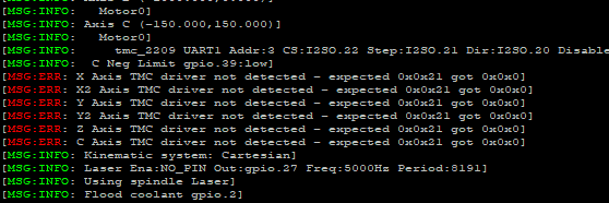

Observation: with no power on VMOT (just powered via USB into ESP32) the system doesn’t behave:
TMC drivers are not detected (on FluidTerm).

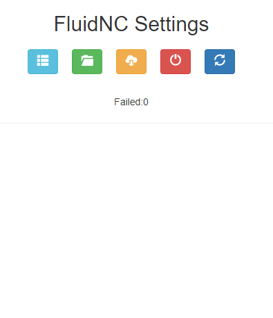

Also rebooting via the Web UI returns a “Failed: 0” message on the settings page. (But when rebooting via FluidTerm, everything is fine.)
When power is applied on VMOT then everything is fine. Driver tests pass (except for C) and reboot via Web UI has no issues.
Not a problem but it surprised me. I don’t remember, this is also true for the other boards too right? Where powering from only USB leaves it in a partially non-functional state (besides motor motion)?
Correct, TMC debugging.

Ok, I spoke too soon. The “Failed: 0” issue is not a matter of VMOT power.
It happens occasionally but it’s not clear what the cause is. So far rebooting via FluidTerm appears to fix it 100% of the time, so moving on. Could be a bug in the Web UI for all I know.
The rest of the webui works fine for you?
I have not seen that.

That should be just a reboot and reconnect are needed.
