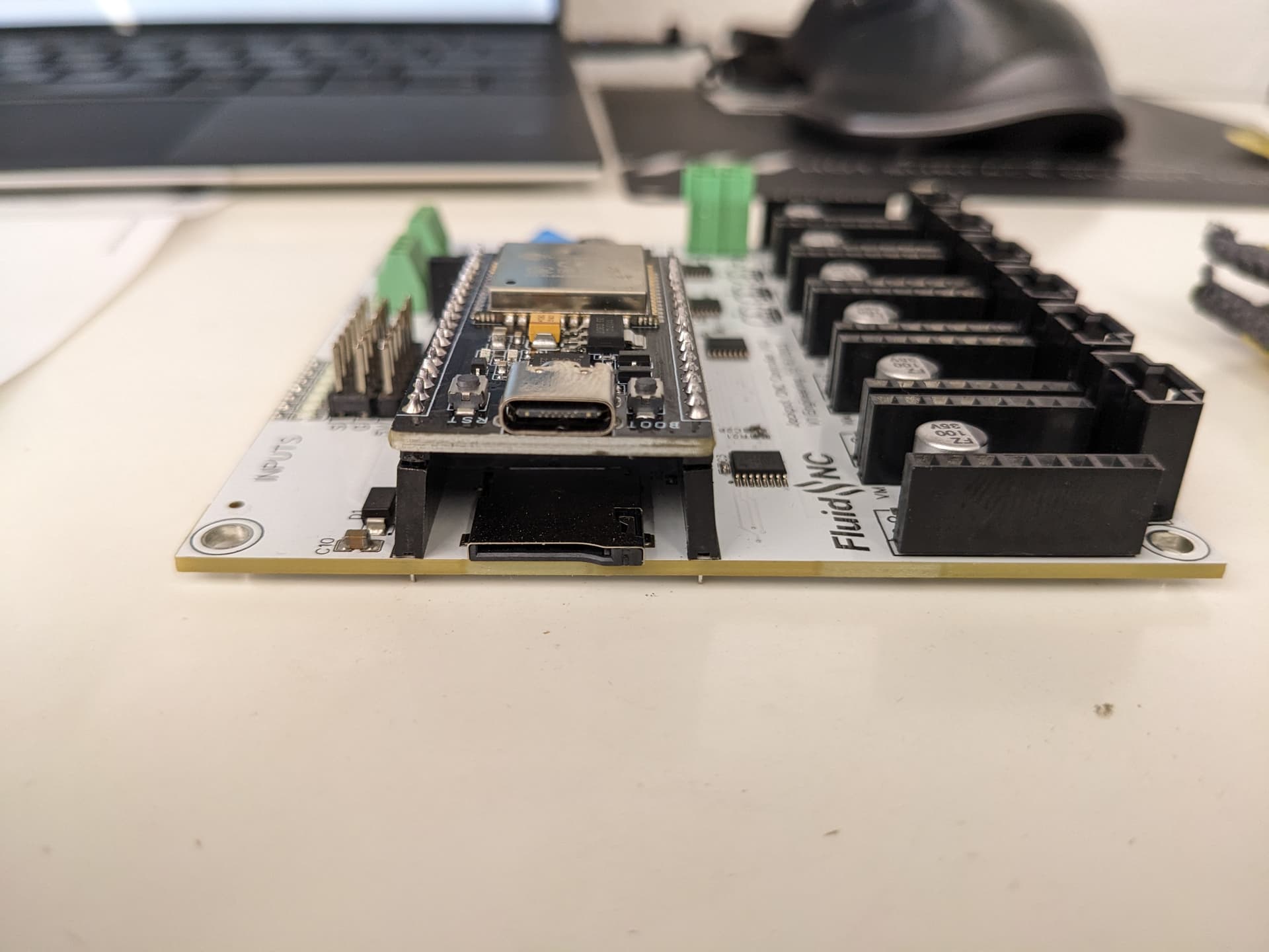

CRAP, I ordered 100 of the USBC esp32…they are one row more narrow. GRRRRRR
Well they do still fit. but it looks a bit odd.
That’s a very weird change. Easy enough to make it a ‘dual’ footprint, if you wanted, though. Or you could just bite the bullet and I can help you land the ESP32 module directly on the board :wink:
Right, I remember you mentioning that before. Do you have a photo? It would be rare to get a board back that was completely cleaned unless you specify it. Could always try bringing it up with them and specifying you want it to be cleaned end-of-line.
I suspect the browning/burning is a hand assembly thing, so that will go away with decent ordering volume. What that volume is is tough to tell. 100 pieces here in NZ was definitely going down the wave solder line. 100 pieces when I was working for Qualcomm was going through the selective solder station. 100 pieces in China is likely still thoroughly in hand-assembly territory unless you specify.

Most of Barts Boards are dual footprints. I just need to pay more attention on my orders. Dang it.
Might as well, just a small order 5-10 if possible. Just check them all out to see how it goes.
Again, this is just the price you pay working with hobby level components, sadly. Poor or misleading documentation, much less uniformity across product lines, etc. It’s the cost of things being as cheap as they are. If I were in your position, I’d be absolutely stoked that I only had a few of those boards, it’s an almost zero-danger change to make to the board and they fit with some bending that isn’t going to hurt anything. That’s a victory from the jaws of defeat, for sure.
