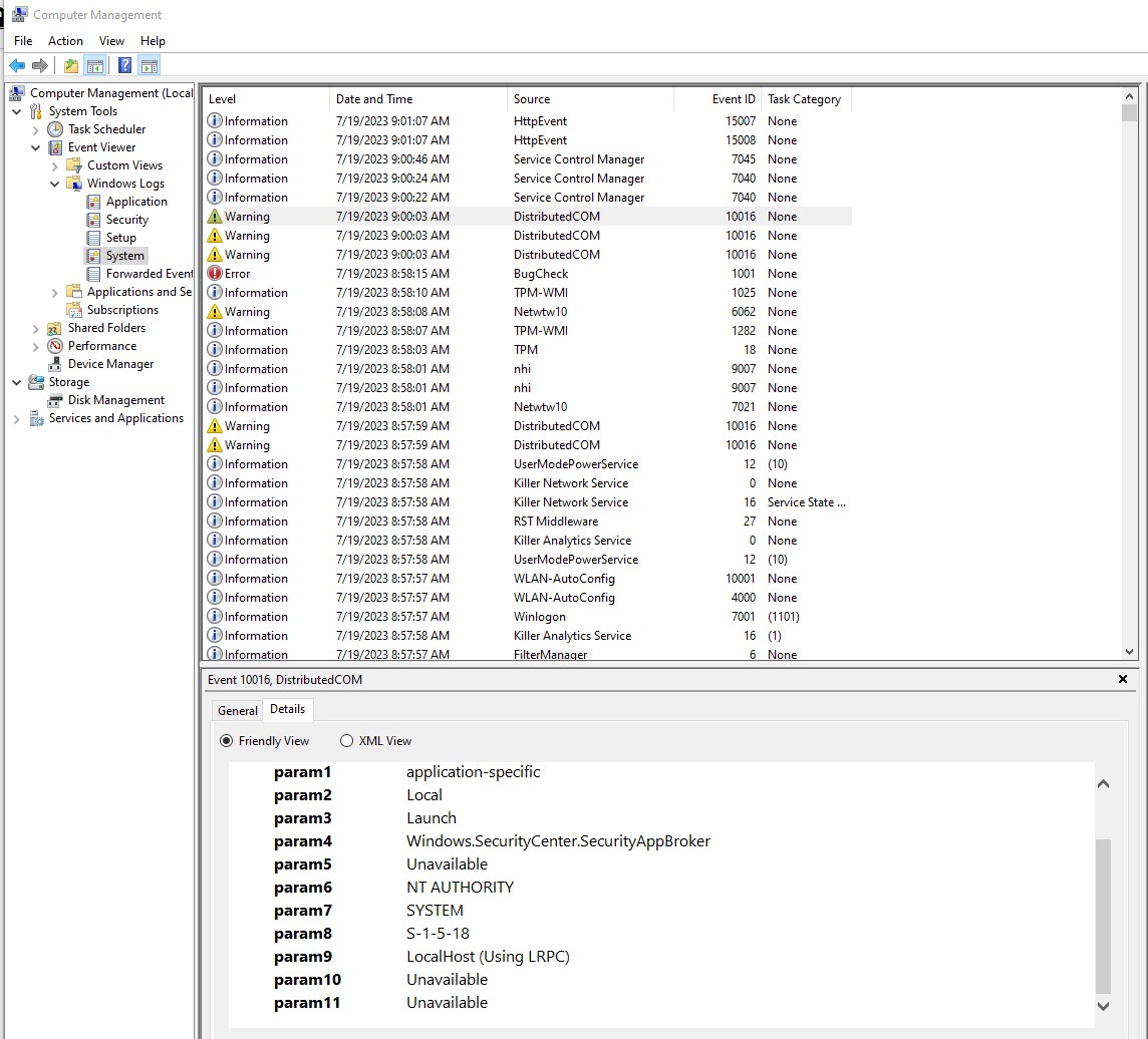

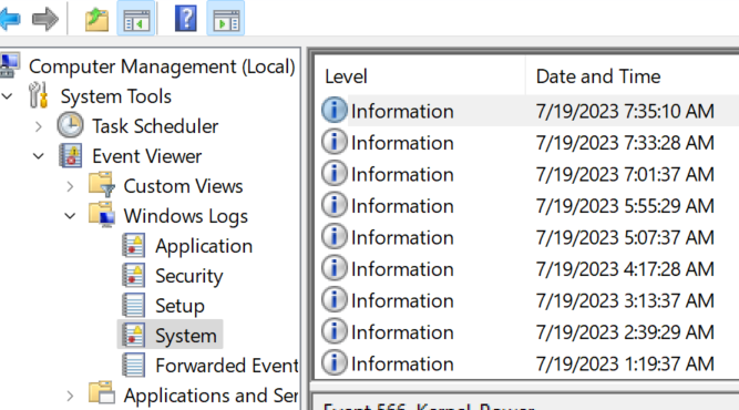

Did you look at the event log in computer management to see if there was any evidence of what happened? Sorry, east coaster here had to go to sleep on you. Glad it is working, but just does not seem correct. The log to look at would be the system log. (For future the stuff you do, that app log may be of use to you as well.)
I can take a deeper look.
It’s a dell, and it has dell power and cooling settings, on top of the windows settings. Each time the error was the same, driver state I believe. I was on adaptive and that said allow it to run warmer…no good.

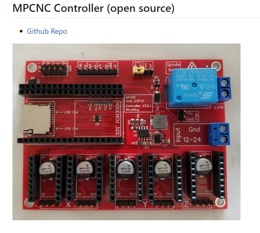

Hey, so on the website for bart Hardware · bdring/Grbl_Esp32 Wiki · GitHub I see the below, is that the board you designed already or is it one that someone else designed?
Never mind, I see it was 3 years ago. Tindie shows it as retired.
I was unaware fluidnc had been around so long.
That was a grbl32 board, not mine. It is kinda close, but they are all based on the same stuff, all of them are just rearranging the modules.

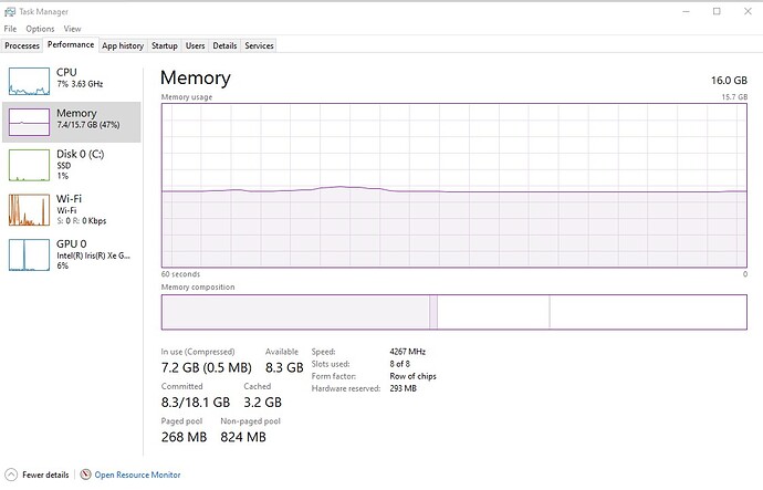

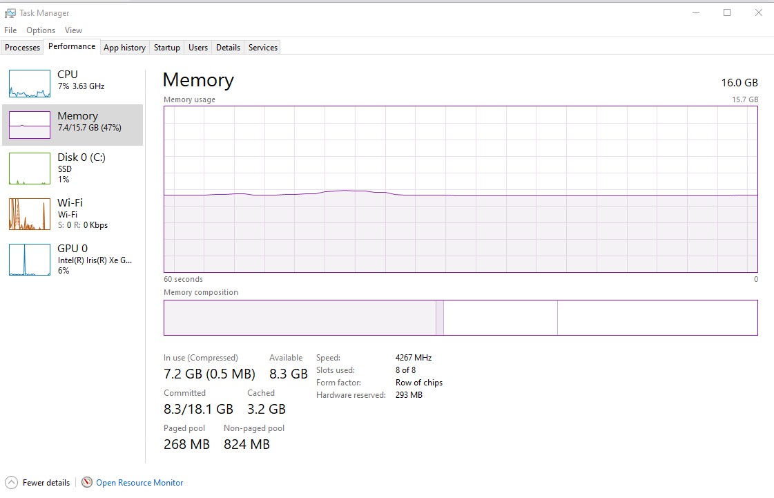

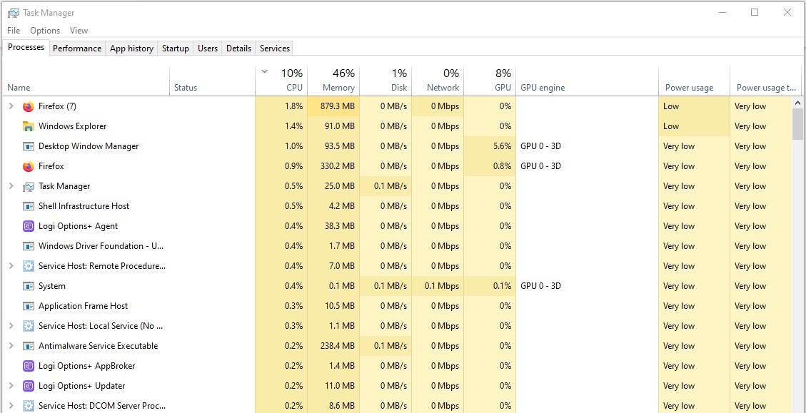

Fresh reboot and there is 7GB of memory in use. Don’t see anything here doing that. Fell like that is out of the norm.
Something definitely “smells” funny about this…

what is that bugcheck, that is the one to look at.
dcoms are very prevalent, nothing realy. Looks like there is Power mgmt there to TPM and your network maybe went out, do you have a dock connected?
also what is Killer Network Service and Killer analytics?? Those are services running right now.
