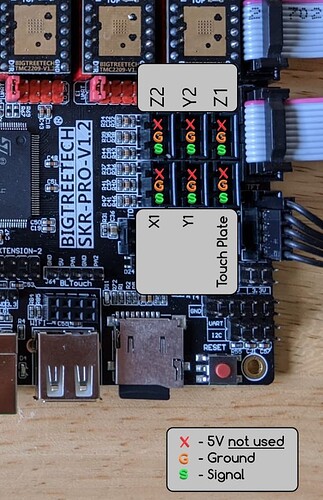

You should be able to set it up and run the same dual endstop firmware for the LR3. If you set it up to home to Z+ that will also set you up to use the touch plate for Z0. All endstops wire normally closed. That way if you have a wire break or come loose its a failsafe. You can also wire up an endstop for X that it can hit. Back when I had my LR2 I had it all wired this way and it worked great

If you are running the Current firmware you will need to have your endstops wired in Normally Closed (NC), this is the outer two tabs on the endstops, we do not use the middle one. You will plug into the Signal and Ground pins, Do not use the + pins. Use Ground “G” and Signal “S” pins, they are labeled on the back of the board.

The pic on the SKR Board shows the touchplate plugged into where Z-MIN usually goes.
