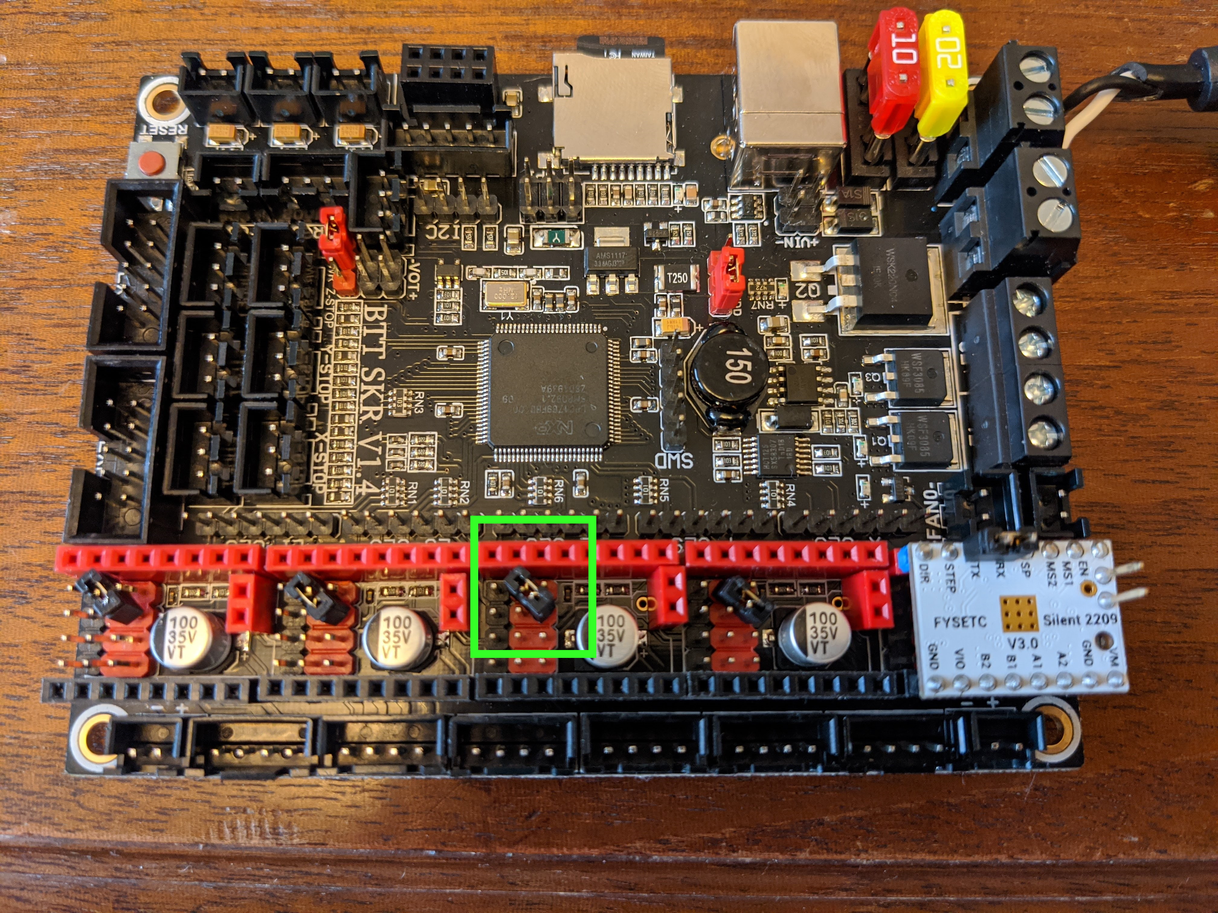

Alright friends, I MESSED UP. I am pretty sure my board is fried but I wanted to get your opinion on if its worth trying to fix or should I just get a new board?
I was feeling very optimistic as I had gotten the printer moving with this SKR 1.4 Turbo. I was still figuring out how to adjust the firmware to remove the “TMC Error” and my endstops have 3 wires which is a bit confusing. When I caused this failure I was testing out the fans and making sure I understood which one was for what (board cooling vs print cooling vs hotend cooling). Unfortunately, I am DUMB and left the board powered on while I plugged in and unplugged the fan to test the different ports. Thats when a wire dropped onto the board right above where I am pointing with the knife. Hard to say where the wire actually hit/shorted stuff but I do know that light brown component released the magic smoke that makes these things work and has a big blister there.
You think I can just figure out what that component is and swap it? Or should I write it off and buy a new board? This time maybe not a Turbo?

If the scorch is all on the component(s) then you should be able to get a schematic and figure out a replacement. Sometimes a short can vaporize the copper traces on the board (don’t ask me how I know) - that’s harder to work around.
If money isn’t too tight, I would get the replacement board and then try the repair and keep the fixed one as a spare.
At least it’s one of the easier SMD components to replace!

I have found some more clues… if I look elsewhere on the board, there are similar components by the fans in the lower right corner in the picture I took. They read “106 16k 005”. Googling, this give me a 16k capacitor. Unfortunately, I have no way of knowing if this is the same as the one I burned. Anyone have an SKR 1.4 (turbo or not probably is the same) that they want to take a look at that component to read the top? I am searching pictures that people have posted of this board to see if I can zoom in and read it…
Highest res image I could find. Cant really make out the numbers, but enough to tell its different than the ones by the thermistor plugs.
Cap you are looking for is labeled C25.
Found it. 47uF/6.3v
SKR_1.4_C25
My guess is that is part of the 5V power supply. That SGM chip is a step down converter. You may be able to just find a 5V pin on the board and connect 5V (along with the 12V) and skip all the soldering. In fact, the pro board has a jumper to swap between powering by the 12V (through this chip) or from the USB. If the turbo has the same, then you can just use USB to power the 5V stuff and let the 12V power the motors.

So, I would think that in that case, if I power the board with USB, it ought to boot properly? I think I must have fried it worse than I thought. I just plugged in the USB and the display lights up but I get nothing else out of it…
