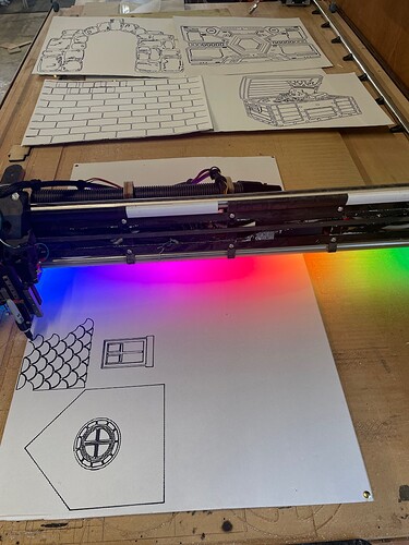

I tried using the laser to engrave them - and this works but it’s slow. But I made a useful discovery - the drag knife Ryan sells is about the same diameter as a sharpie!
So here’s my progress so far making building panels for a cubby - I’ll keep them hidden till Santa can deliver them.
I’m looking for inspiration and ideas both for content and ways to assemble them.

Well they’re quick to make but I’m going to new a few more sharpies I reckon.
2 sheets down, 20 to go

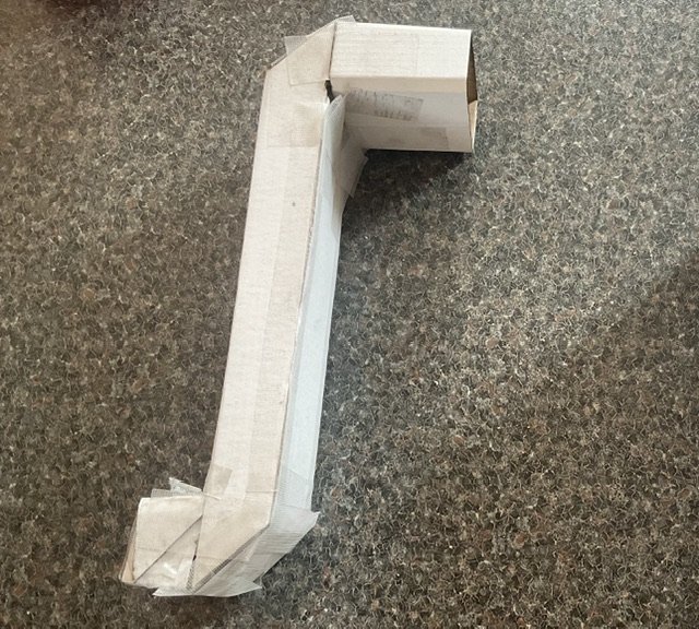

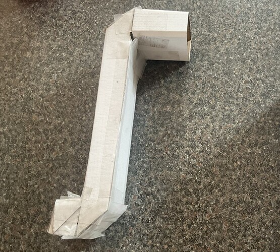

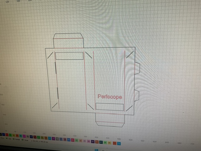

I thought it might be fun for the little’ us to learn a little about optics and I have some mirror faced acrylic so set out to make a periscope.
Version 1 while it worked you can see it’s very unsatisfactory.

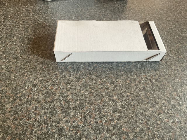

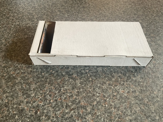

So a few revisions later and I ended up with something that doesn’t need any glue or tape to assemble. Making things to be folded is hard.
Lasercut from a single piece with fold lines marked. The mirror files slide in and don’t need glued either.

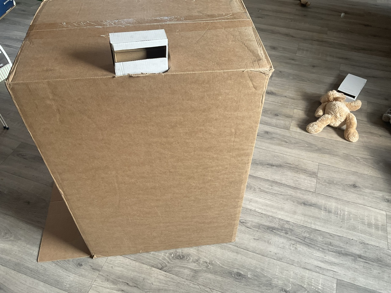

And here it is in action
As an aside, I learnt in the process of making this the key to lightburn: convert to path. Once you’ve done that you can add nodes, break lines, delete them, resize them.
Far far more intuitive for me than the merge/intersect/cut tools when dealing with overlapping shapes.
