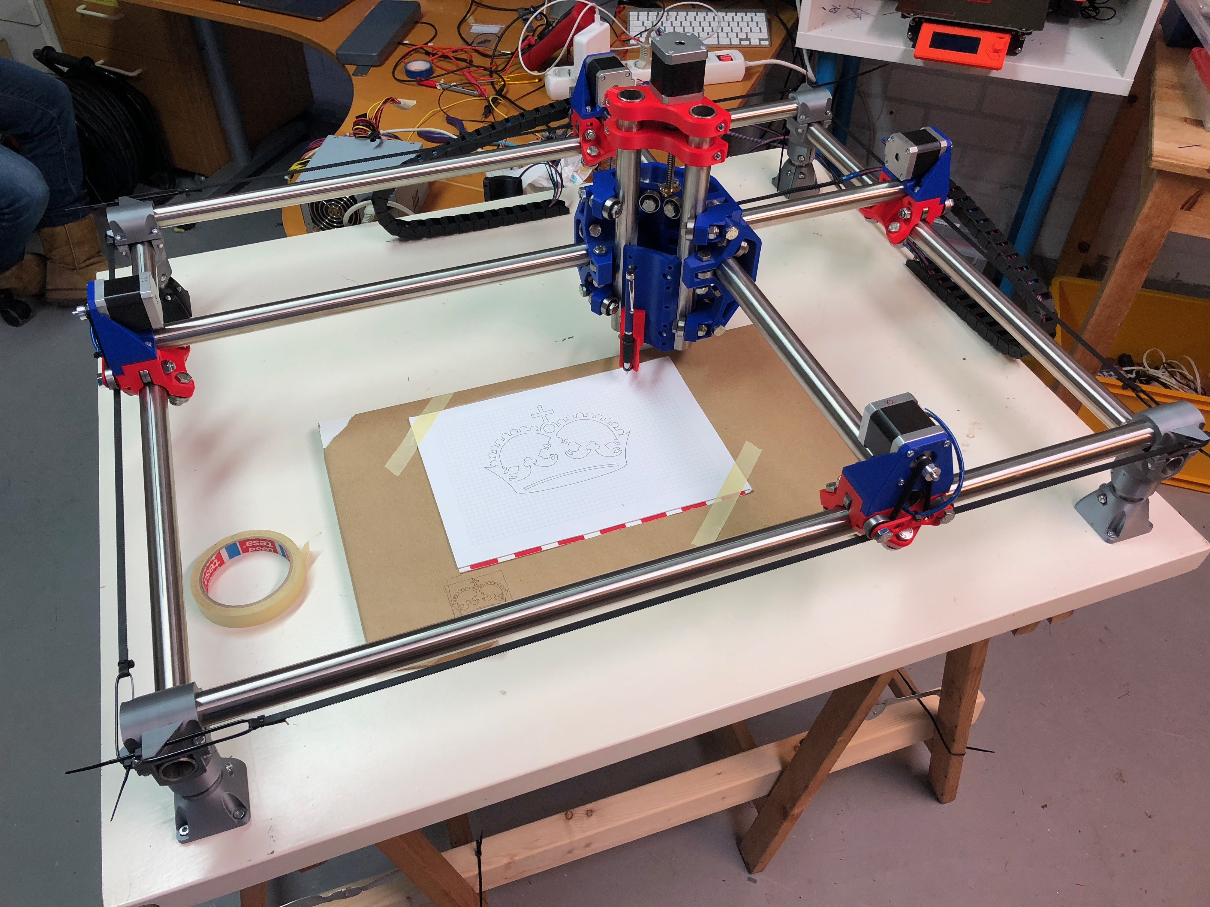

This has been awesome constructing it. Here’s my 25mm build:
  • Work area about 420 by 620 by 80 mm (about 16 by 24 by 3 inch)
  • 25x2mm stainless steel tubing.
  • Kress FME800 spindle
  • Arduino Uno clone + CNCShield
  • Grbl 1.1 & bCNC
Just before Christmas I ordered most of the metal bits and started printing all the plastic parts. That was done around Christmas, but sadly my bearings took almost 3 weeks to be delivered (normally it's 3 days, tops) so I wasn't able to start building. I ordered the tubing online, cut to size. All I had to do was de-burr. Because they were factory pre-cut they turned out to be remarkably similar in length, about a tenth of a mm. This, combined with the nice prints from the Prusa i3 MK3 made squaring up a breeze. It's probably not perfect, but it is very good out of the box.
My initial electronics setup consists of a Chinese Arduino Uno clone with a CNC Shield with Stepstick DRV8825 running Grbl 1.1. They’re driving NEMA17 steppers of very similar specs as sold in the v1 shop. Taking small steps, using parts from my old Anet A8, I tested the electronics until I was happy I wouldn’t trash my build the first time I powered it up. That didn’t even end up taking all that much time with the very satisfying end result of a machine moving under its own power.
I wanted to use Grbl because… just because. I know Marlin from, time for something new and made especially for CNC. Using bCNC on my Macbook to control and configure Grbl steps per mm, maximum feeds and accelerations. And I hooked up an e-stop button, which saved my machine a couple of times while dialling things in.
Making bCNC do the right thing and draw a reasonably sized Crown was a bit trial and error, not helped by the lack of progress bars in bCNC for operations which take a long time.
And then it was just mesmerising to watch it move. And draw.

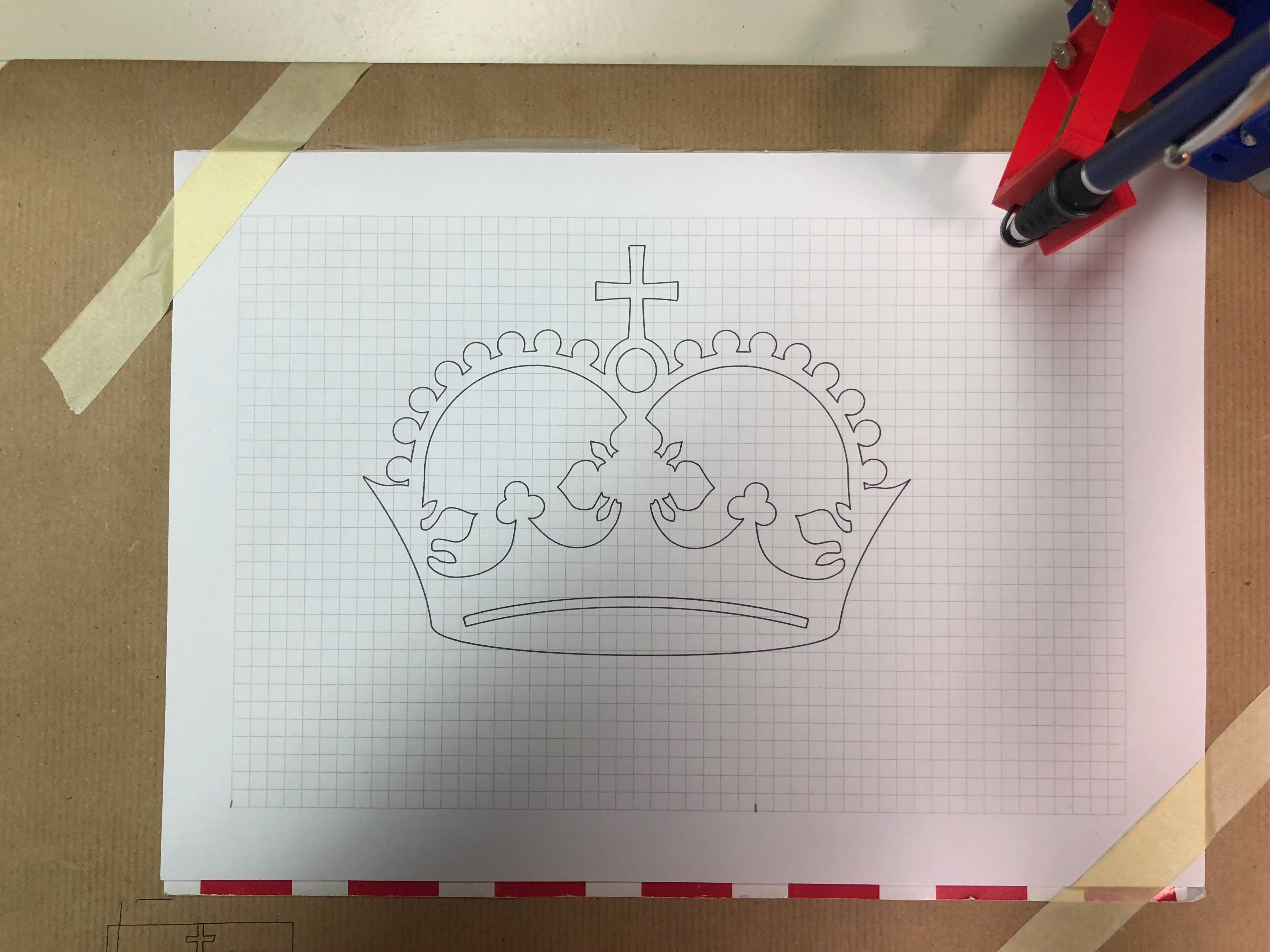

So here is it, the Crown, drawn on 5mm grid paper.

I’m still building the electronic, it’s currently on my desk - visible just behind the rear x rail. The MBP is a very temporary situation, I want something a little easier to fix near a messy CNC machine. Not sure where I’m heading, but I like my RaspberryPis - I use them in various other projects. I would like local control, a keyboard or other directly connected to the CNC controls - either via Grbl or the Pi. And maybe a little joystick to control the XY position.
Wow, that is a superb crown. Jeez, I might need to make sure mine is that clean!

You’re shitting me right? Most everyone’s crown should look like this? Slightly sloppy the first time perhaps because they hadn’t tightened the belts enough? All I did was follow the instructions (carefully). Technically this is the third time I’d drawn the crown, the first was a 5 cm one (couldn’t find the scaling option, but damn it, I wanted it to move on its own), the next was the same as on the 5mm grid paper, but on the brown paper you see below.
I did assemble an Anet A8 and Prusa Mk3 in the last 18 months, so I had some practice.
After I’d done the crown, I tried some HD foam engraving, but the only cutter I have is the 3mm Dremel ball engraver, which doesn’t have a nice shape for engraving. Looked nice anyway. Good thing it was in foam, because that took several attempts before I got the DOC right. First time it dove right in so I slammed my big red button. Then bCNC was just hard to use, so I tried with text in Fusion 360 and engraving with that. Lovely :slight_smile:
