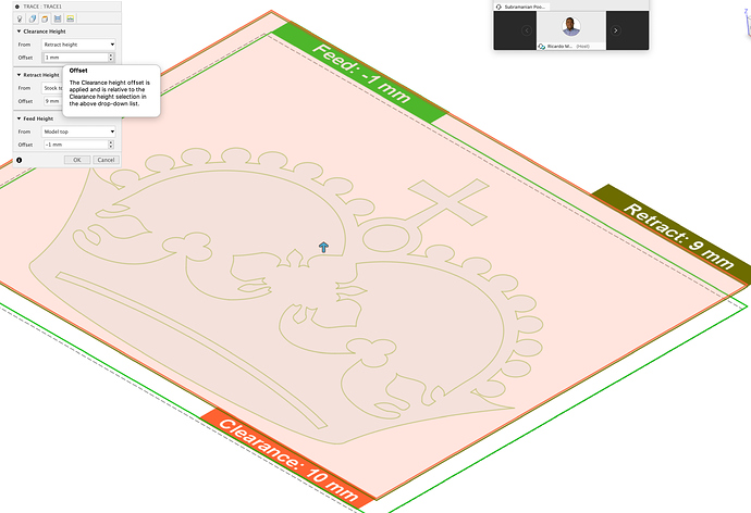

I’m curious if anyone has done the crown test from fusion 360?
If so I’m wondering what settings were used; what tool did you use for a “pen” tool.
I’ve done the crown test generated from V1’s site and would like to duplicate it in Fusion as that is the CAM I am planning to use. And before you ask, why not estlcam? I just don’t want to spend another $50. :slight_smile:

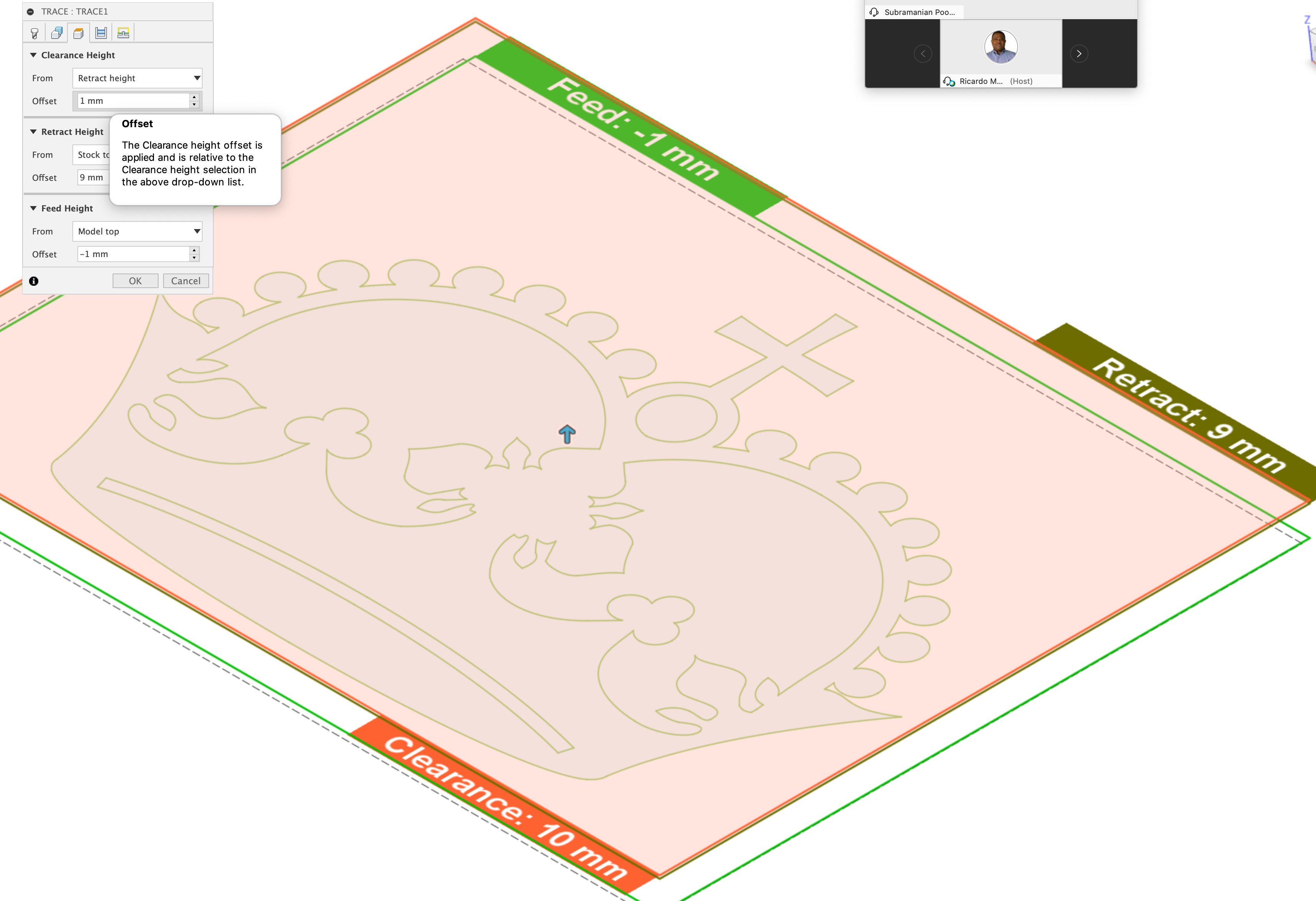

I have done it. I used the 2d trace CAM.

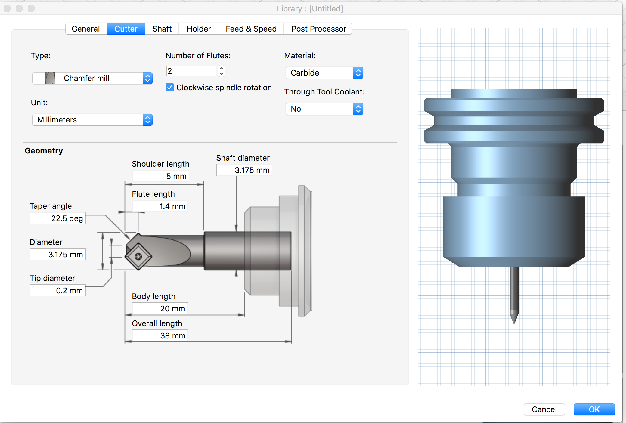

what did you use for the tool. F360 only has cutting type bits; as far as I have seen there are no options for pens. I supposed I could make one though.
did you modify anything for feeds and speeds?

Trace is a good option, I usually select the v-bit for this, but I am sure many others would work.
I wouldn’t worry about not using Estlcam, for some reason it seems to be the defacto go-to CAM software for hobbyists (at least here); but I found it to be an unusable mess.
This is what I use for the vbit, it works for a trace.

Yup, found the trace. Thanks for the vbit info. I will punch that in.
I might also make a pen tool and see how that goes.
Yes, I told it I had a fake bit and really used the pen mount. I set the target depth to control tension on the pen
