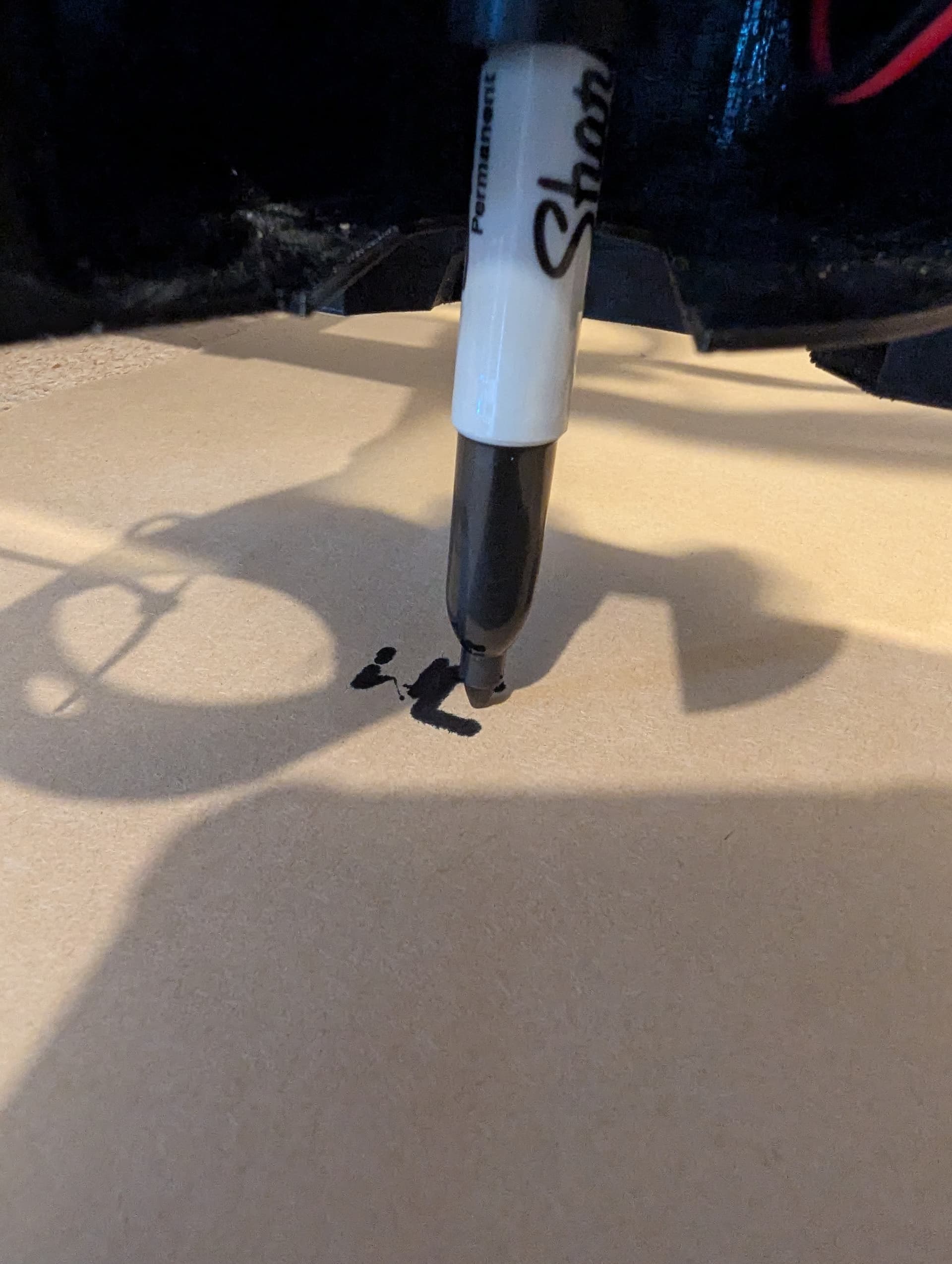

So followed the estlcam steps but the pen just crashes theZ axis… Is it trying to zero with the probe? Do I need to tell it is at 0,0,0 or something?
Before you start, you need to tell the machine where Z=0 is. That is the purpose of the probe, although you can manually jog the Z axis until the pen is just touching the paper, and set the Z=0 at that point.
How you set the Z=0 varies by firmware type. G92 Z0 works for Marlin (and maybe FluidNC, IDK). With FluidNC, you can use the Zero button on the display (I think)
Thanks Bartman will go test that out now I’m using a skr pro with marlin
Then I’m your huckleberry! I don’t know FluidNC/Jackpot so well, but I’m pretty familiar with Marlin/SKR Pro v1.2.
Well she is working….. but flow rate is messed up two letters 5:mins :sweat_smile:

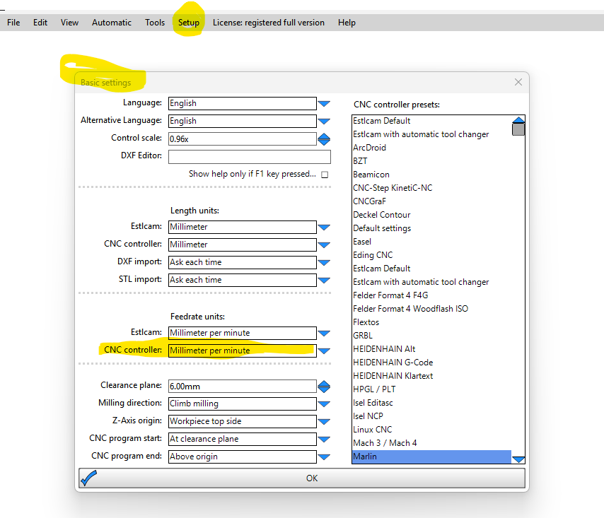

This is usually an indication that you are using mm/s rather than mm/min when you are setting your feedrate output to gcode.
Marlin reads the gcode as mm/min. If you have the output set as mm/s, then the speed is 1/60th of what you need.
EstlCAM - Setup - Basic Settings - CNC Controller
