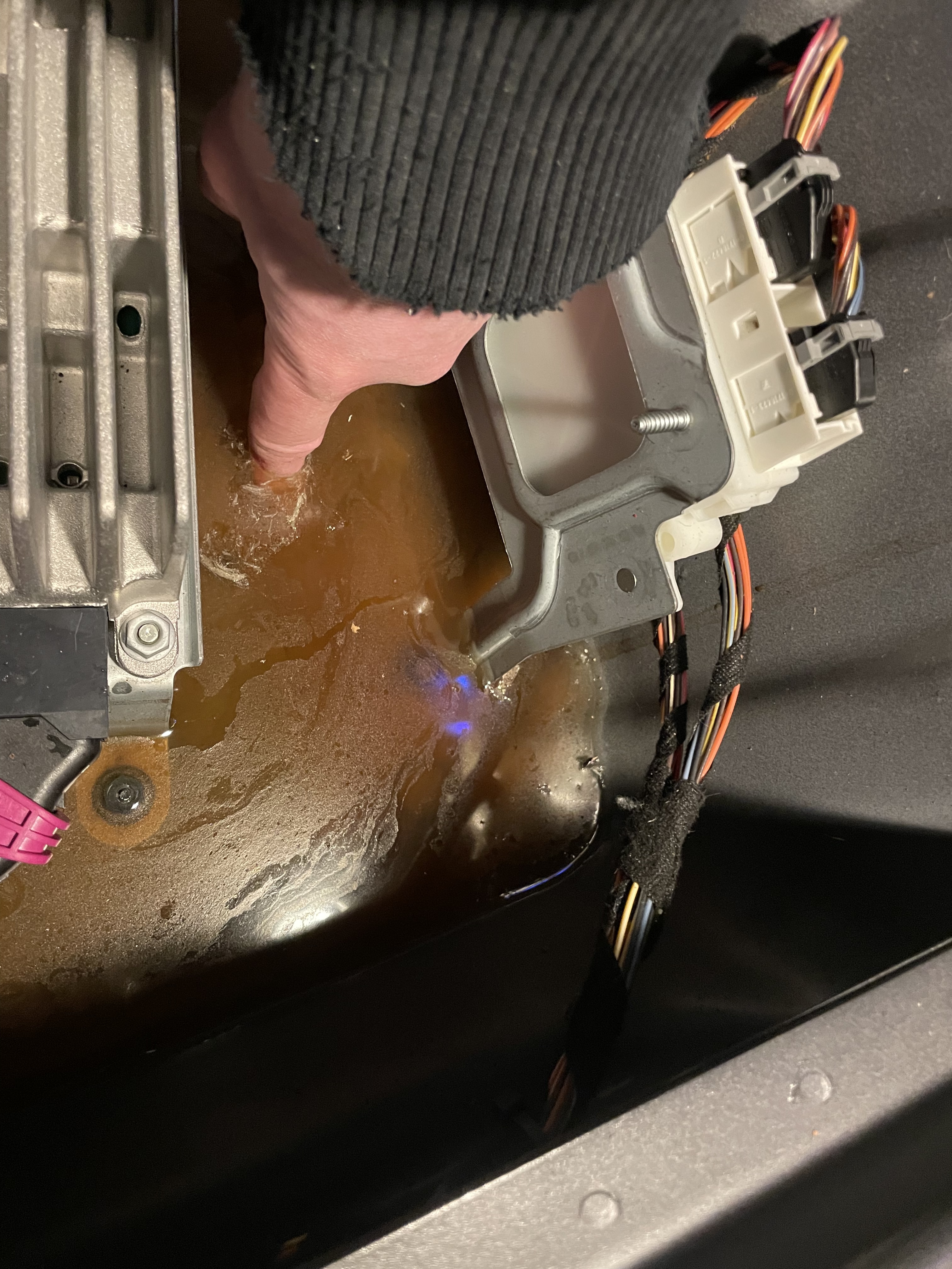

I had my wife’s suv fill up with about 5 gallons of water while we went on a trip. The leak was due to a roof rack rail nut not being in place. Long story short all my body control modules filled up with water and had shorted and started corroding.
Car was a no start and failed enroute in the mountain passes.
I isopropyl ultrasonic cleaned the boards. (Be careful as most cleaners heat the fluid )
Then brushed and treated with acf50 cleaned and it managed to get all my boards back working.

You should check what type of wire you have in the vehicle before doing this.

I had to take all the computers apart clean and now i am confident I could drive underwater lmao.
I literally treated everything. Undid all the wire looms inspected and treated them all.
I have been inspecting it for a while and doing water tests.

Open hatch pull the tire well out and if there is water pop your drains and get prepared

Drove 3.5hrs through the snowy mountains with nothing and I mean only engine and trans manual shift. No light no wipers no Speedo no tach.
I am 4hrs away from a dealer and all the computers are vin coded so it’s a thing.
I would have had to re tool for specific Mercedes scan tool and clone eeproms and flash nee or old boxes. It was looking very bad that’s why I thought I would share.
