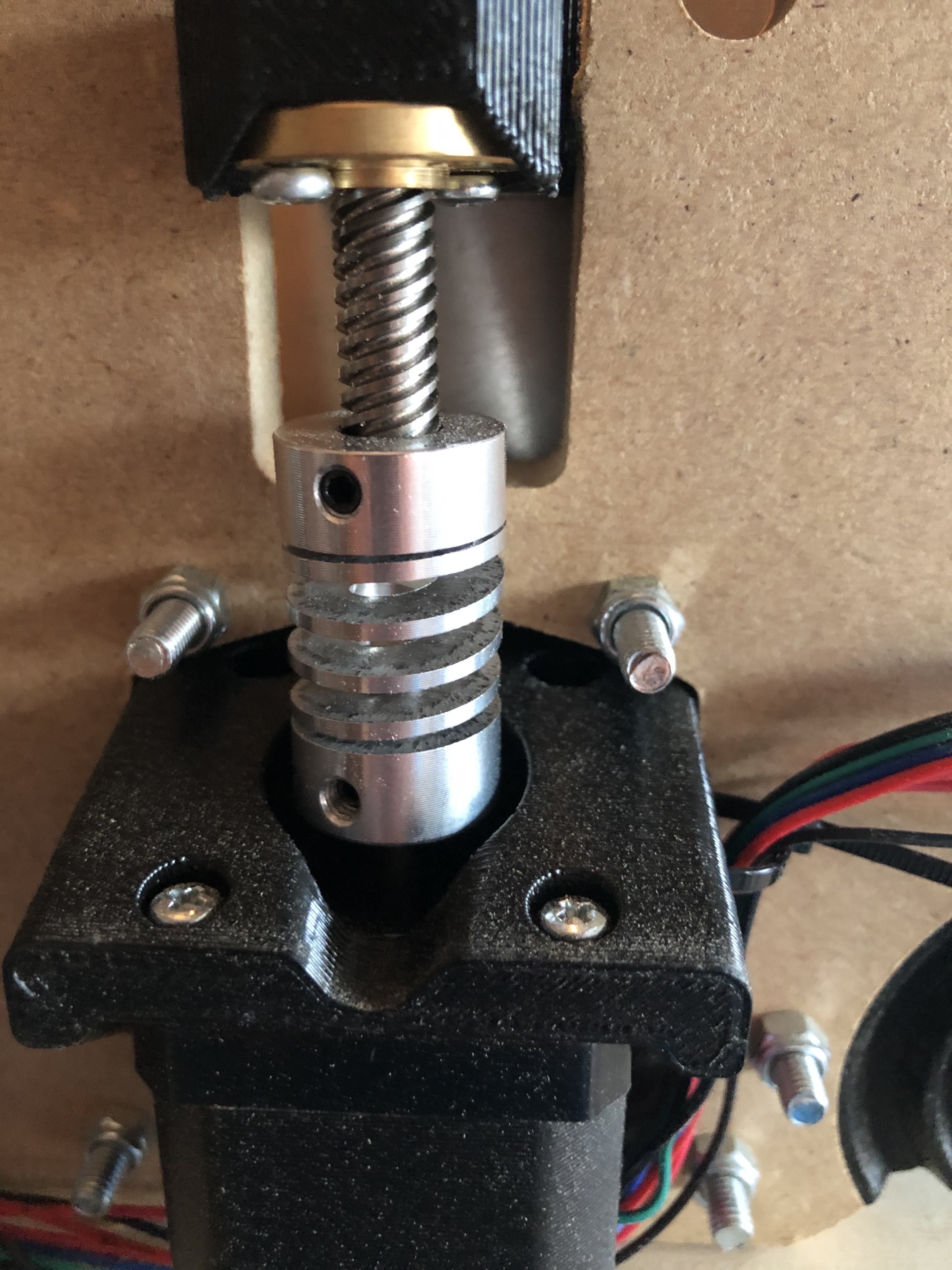

So I made my strut plates and took everything apart. Put on the struts. In the process of putting the sides back on and now my Z coupler looks like this (just this one, other one is still normal).
I assume this is broken and I need to order a new one? What are the odds it still functions?
That one is toast. Probably a good idea to get a few spares. I know i have a few around for that same reason.
That’s what I was afraid of. Finally got everything done, crown, struts, etc. Still troubleshooting my endstops and need to clean up wire management but I was ready to finally play with the damn thing! Oh well, that Z had been giving me weird problems so maybe that was the cause all along and once I replace it that side will behave properly. Thanks for the reply. So far everyone has been super helpful - not sure I would have made it without the help

Also, you can print a pair of these:
https://www.printables.com/fr/model/317201-coupling-saver-for-lowrider2-cnc
Although on the LR3, the plate mlight get in the way…

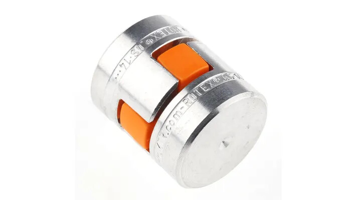

I also tried to use “spider style” couplers as they will just disassemble if you pull on it, but there was not quite enough flex, and the z motor was blocking near 0
So I ordered more of the couplers (5 for like $9 on Amazon I think) but in the mean time I tried to see how well things would work anyway. 1 - Still can’t home (endstops dont seem to work right). 2 - coupler broken?

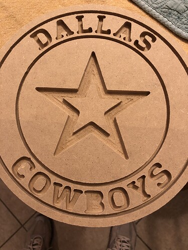

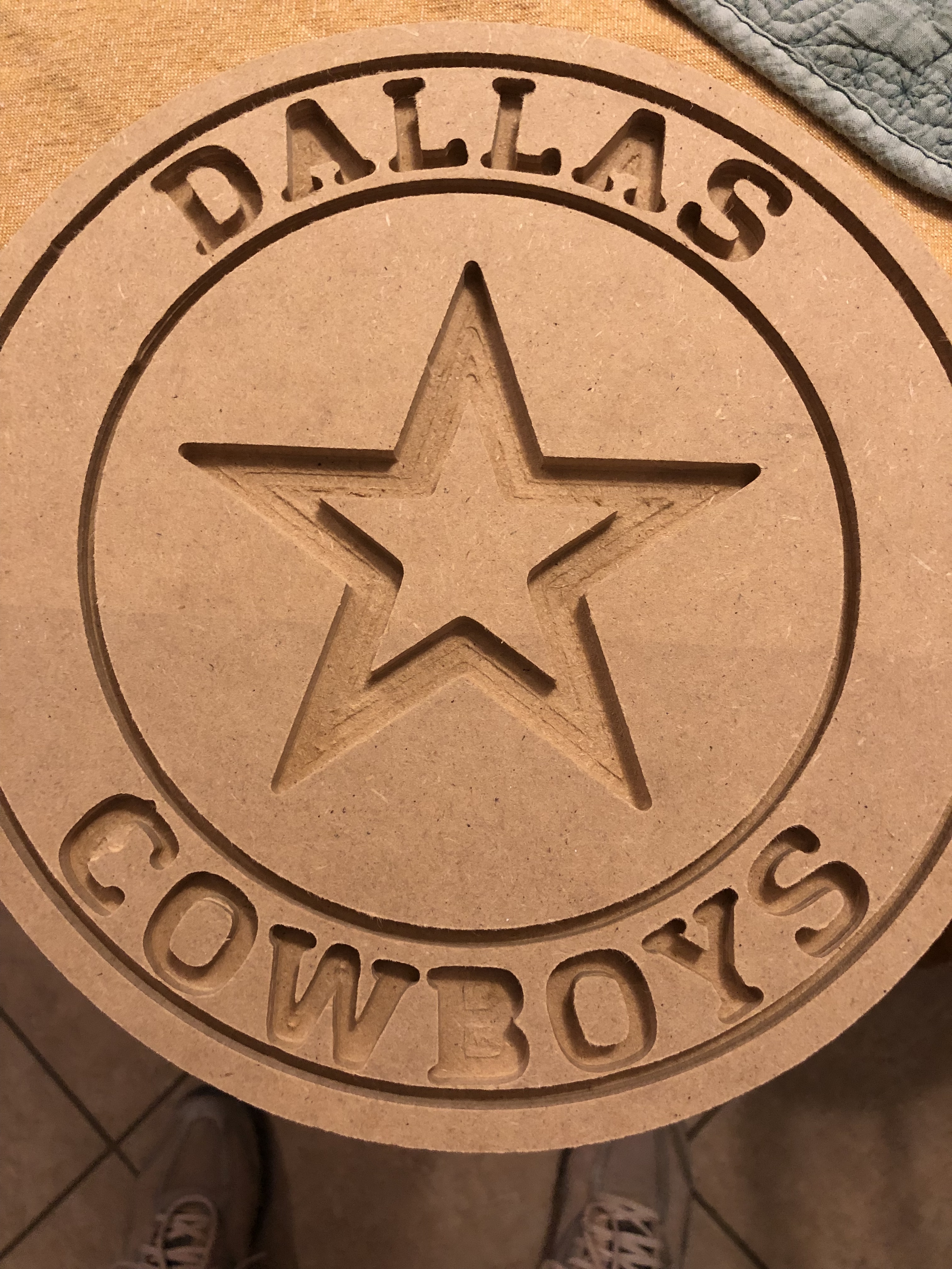

4 - took an svg I had from wife’s Cricket Maker 3 and quickly ran it thru Estlcam anyway
The defects inside the letters and the star are 99% my fault - trying to clear space with a 1/8” endmill when I just don’t think there’s room. Not too bad for a first test with a barely half set-up LR3. I love this thing and the support from the community
