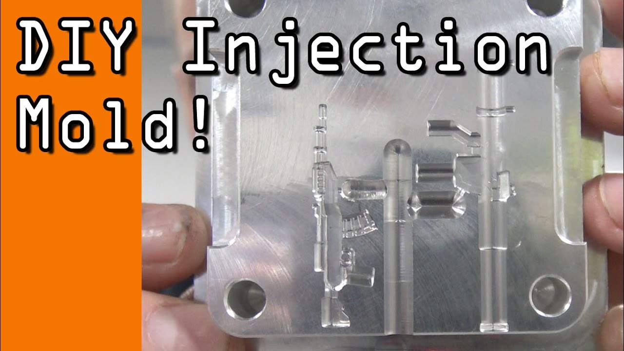

What about milling molds for forced injection? PLA is a fine material, IMO. Ryan is the only one that could benefit from something like that, but how does it compare to a silicone like mold?
Something like this:
Some sorta long videos, but this is what’s in my head. I have no idea if it works that well for larger parts.
Honestly, even if Ryan could do this, I don’t know if he should (and it’s not up to me :smiley: ). I like printing my own parts, and I like getting help from Ryan and if he changes anything that works better for a molded part, the printed parts aren’t going to be as good.
It is cool to think about though. I love the idea of making all the parts in like 5 minutes.
You can still do injection molding with casts. Earlier I quoted a company that does small run injection molds using silicone molds. They are a stiff, high temperature formulation of silicone, so usually it means more parts to the molds, where as, with softer silicones will flex and you can realese parts with undercuts much easier. This means fewer steps and less error. Imho, the added mess of dealing with two part plastics is much easier, minus being messy. Your right though, you wouldn’t have to wait as long to pull them out of the molds using plasic injection… actually I’m not sure that’s entirety true. There are additives that really raise the cure rates, but I can only imagine that adds some extra difficulty in working with it.
Milling the molds for these parts would take a lot of time. And difficult. I don’t think it’s something we could do with the mpcnc right now. I could be wrong, but without 5 axis and a lot of clever coding, it would be hard to get all the angles needed to have the right finish. You thinking milling these parts out of aluminum, right? I think give it a try in engineering block first.
